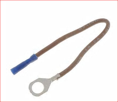

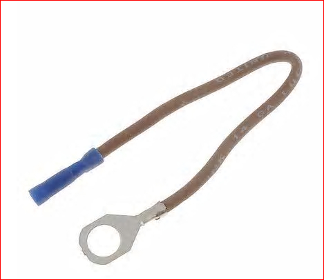

What does a fusible Link look like?
Dec 16, 2018 at 7:21 AM
DANNY L
  • 5,648 POSTS
Hello again,
I've attached a picture of what a fusible link looks like.They are available at all local auto parts stores.Hope this helps and thanks again for using 2CarPros.
