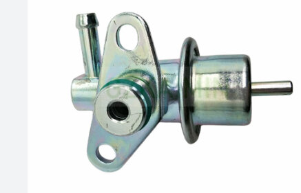

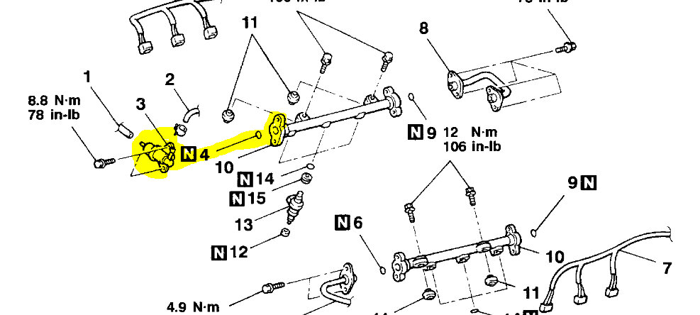

If you have a rich fuel mixture, the pump isn't the problem. It could be several other things such as a failed fuel pressure regulator. If it is rich, you are getting too much fuel, so the pump is working but something is causing the engine to over fuel.
I attached pics of the regulator below. It should be mounted on the fuel rail. Do you know if this has already been checked?

I also got this info, from the mechanic place: "Fuel pump low (should be 48psi and measured at 40PSI) Fuel pump Control module has excessive resistance (should be 4-6 ohms and measure at 8 ohms) / Fuel system evens out when adding alternative fuel.
Not knowing what else to do, we already called them and told them to fix part one and questioned if it would run or be ok if we do not do part 2, since the fuel pump control module nowhere to be found. He said it should but could not guarantee. At that point he also said he could start checking around salvage places to look for the part. So that's where we're at. Thank you so much!

We did the part 1 recommendation (fuel pump/filter). The 2nd we could not because fuel pump control module no longer available. As it turns out a non-issue since it wasn't the problem anyway. When we picked it up the service advisor said the service engine light is probably going to come back on. It did. We weren't even off the lot yet.
We turned to another auto repair place. They found the same codes but tested further and found that the vacuum plug was missing. They installed a vacuum cap on the intake manifold and reset the PCM. They did a test drive and rechecked. That was on July 5. Today is July 16th, no red service engine light, running fine.

First, I'm glad to know it has been resolved. However, I feel bad you went through all of that. What is most confusing to me is the codes indicated a rich fuel mixture. When there is a vacuum leak, it allows unmetered air to enter the engine and causes the opposite, a lean fuel mixture. Unless the vacuum affected the fuel pressure regulator. Then it could have caused a rich mixture.
