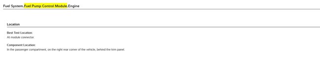

Wondering if anyone can help assist me with where the fuel pump control module is located?
2014 CTS 2.0 Turbo RWD 6 clndr.
Code P069E
Sunday, April 2nd, 2023 AT 8:30 PM
BRENDON S
MECHANIC
653 POSTS
Good morning, RONICAG99,
I have attached a snippet from my repair information telling you the location of this module.
Let me know if I can help you any further.
Thank you,
Brendon
