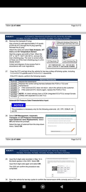

Second, I changed the transmission fluid following the attached picture, added 3.7 liters of fluid as the full transmission needs 7.3 liters and when changing it this way it needs half of it so 3.65 = 3.7 liters. The issue this time (I did change it like 3 or 4 times before) is that this car does not have a dipstick to check the level instead it has a plug that you remove to check the level. The issue is that following the Hyundai process when the temperature reaching 50-60 degrees Celsius and removing the plug no fluid comes out (car running) so, I added the rest now the total is 4 liters the same no fluid are coming out. As soon as switching the car off and removing the plug fluid comes out from the plug. When changing before I used to check while the car are off but the picture attached says that the car needs to be on. So, now what do you recommend I add more and check it while the car are running? In this case I will be adding more than what should be added (3.7 liters).

Hyundai Transmission fluid changing procedure.

For the fluid check, you normally start the engine, Cycle the transmission through each gear, then leave the engine running with it in park and then check the fluid. That allows the converter and solenoids to stay full while the pan gets the remainder. Then it drains down when you shut the engine off. As soon as you start it again the fluid goes back into the transmission and the level in the pan is correct again.
