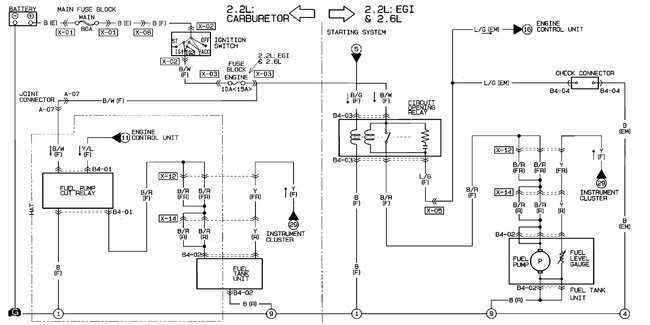

Fuel pump color code wiring diagram needed?
1992 MAZDA B2600
14,000 MILES • 2.1L • 4 CYL • 4WD
ROBERT 4×4
I dropped my tank and didn't unplug the wiring harness and all the wires come out of the plug and they were two different colors on each side. so, I don't know which colors go to what wires
Apr 29, 2023 at 5:03 PM
  • 55,423 POSTS
Sure, here is a guide to help you test the connections and the fuel pump wiring diagrams as you have requested.
Check out the images (below). Please let us know if you need anything else to get the problem fixed.
