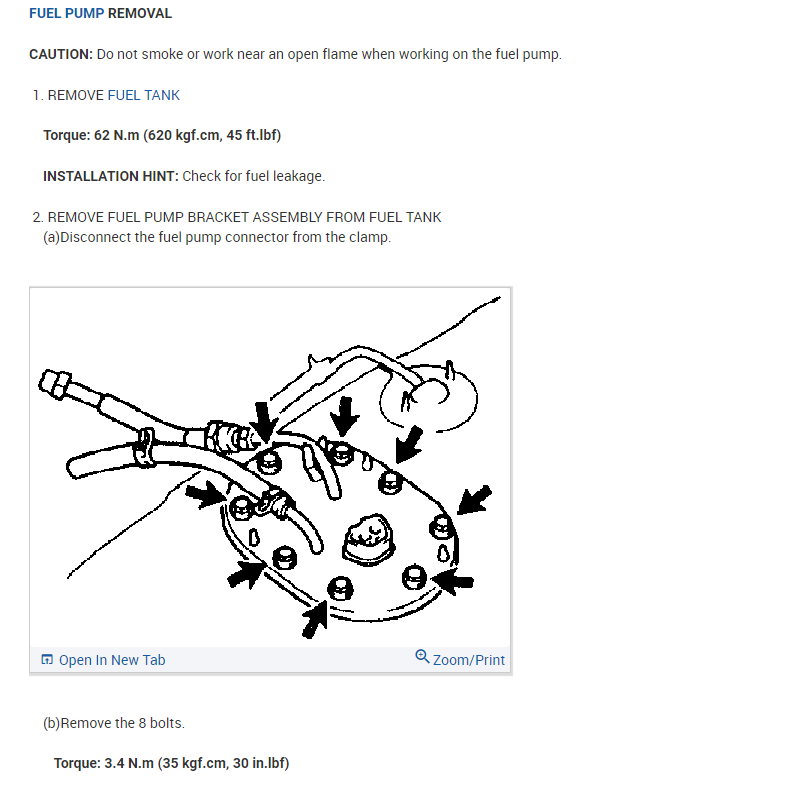

Need fuel pump assembly including bracket and fuel pump. Can't afford dealer parts prices. looking for a good aftermarket. Squirrels ate up fuel lines and when we tried to remove fuel line from fuel pump bracket we broke metal fuel line on top of bracket.

Also, incase you need it, here is some info on how to replace the fuel pump. Here is a guide that has some good info in it:
https://www.2carpros.com/articles/how-to-replace-an-electric-fuel-pump

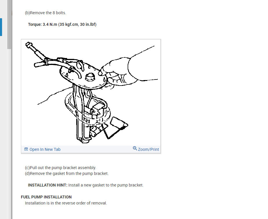

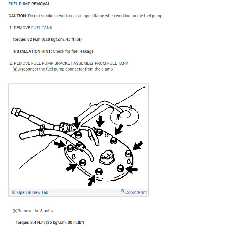

Also, please see the info below from the manual that will help as well.
Please let us know if you need more info. Thanks
