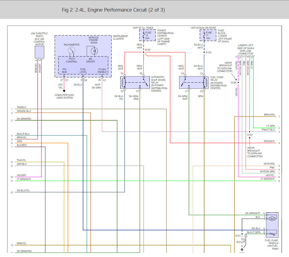

Fuel pump/ASD fuse keeps blowing
2004 CHRYSLER PT CRUISER
150,000 MILES • 2.4L • 4 CYL • FWD • AUTOMATIC
ALEX BOUGHTON III

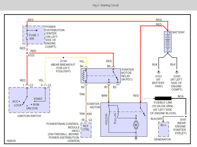

No starter signal, but will crank with remote starter. Crank not start.

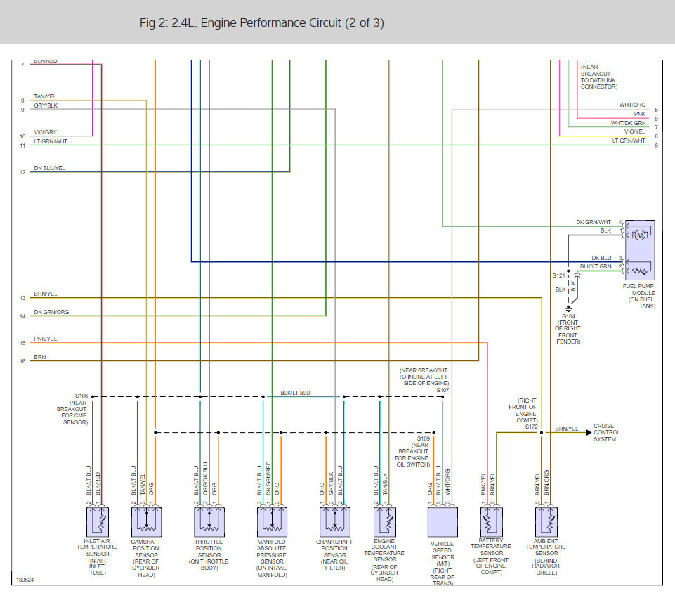

If you are blowing a fuse then you will need to look at the wiring diagram for that circuit and trace for a shorted wire or faulty component.
Sep 28, 2017 at 5:03 PM
  • 55,309 POSTS
I have founds the wiring diagrams for you and a guide to help you do some testing. Some thing is shorting causing the fuse to blow.
This guide will help you test the wires to see which one is touching ground. Could be a relay shorted this is where I would start.
Please let us know what happens and upload pictures or videos of the problem.
