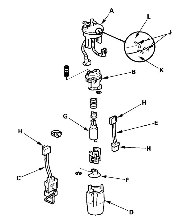

Is there a comprehensive guide to the reassembly of the housing unit for the fuel pump, filter, etc.?
I was in a big hurry when I needed to take it apart to get the pump out to get the replacement pump before the auto part dealer closed for the evening and then worked a 12 hour shift... now I've got to reassemble the entire unit with vague memory of taking it apart in the first place... and I'm under the gun to to this since I'm supposed to be in another town that's over 2 hours away tomorrow morning so I don't really have the time to experiment or mess it up even once.
So I thought s reliable diagram of the unit would help but I'm not seeing one online when I search. Help! anyone! please!?

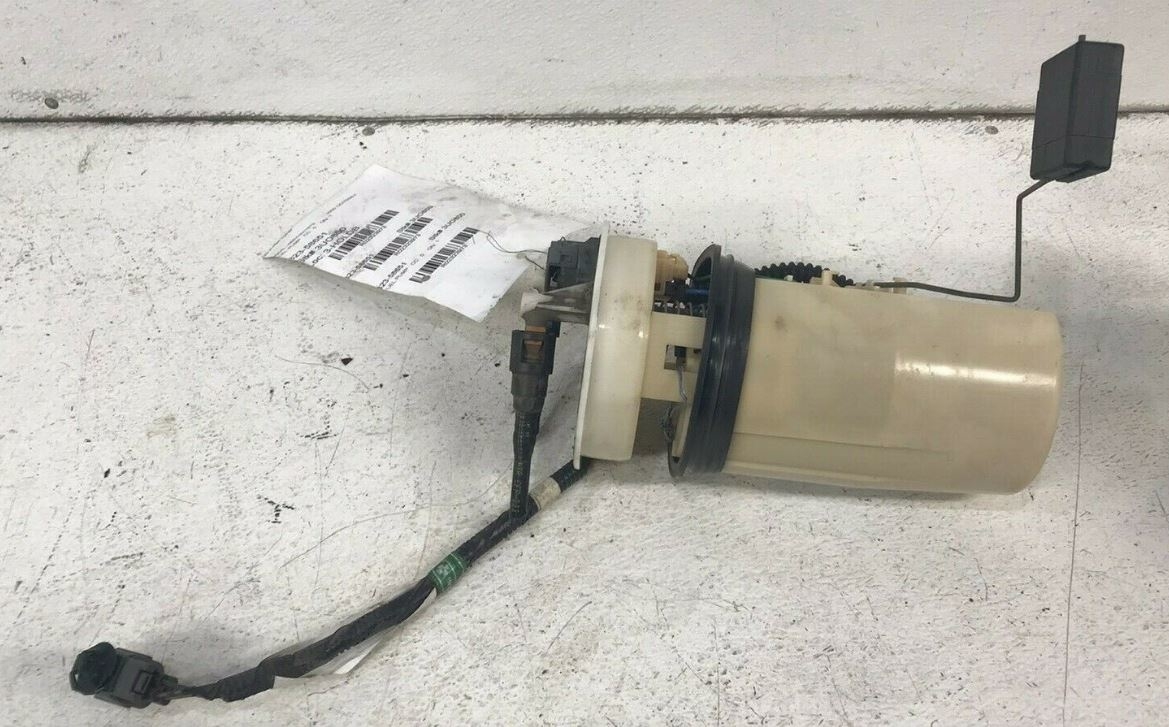

These are the only images of the pump in an exploded view and assembled I could find along with the text below. Honda doesn't expect you to take the module apart I guess. They only show module replacement.
Remove the bracket (A), the fuel filter (B), the fuel gauge sending unit (C), the case (D), and the wire harness (E).
When connecting the fuel pump, make sure the connection is secure and the suction filter (F) is firmly connected to the fuel pump (G).
