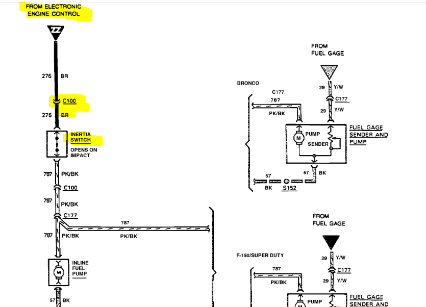

What can be the cause of no power to inline fuel pump and no power to inertia switch? checked for power on relays and they have power so do all fuses replaced the fuel pump relay and still nothing. The truck cranks but won't fire i put power to the inline fuel pump and it started working but when not doing that there's no power to pump.

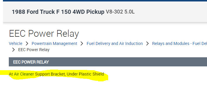

Before we jump directly into the fuel system, have you checked to see if there is spark at the plugs? I ask because if the EEC relay fails, it will shut down both fuel and ignition spark.
https://www.2carpros.com/articles/how-to-check-for-ignition-spark
I can't find a pic of the relay, but it's located on the air cleaner support bracket, under a plastic cover/shield.
Do me a favor. Switch that relay with a different one having the same part number and see if it works.
See pic below.

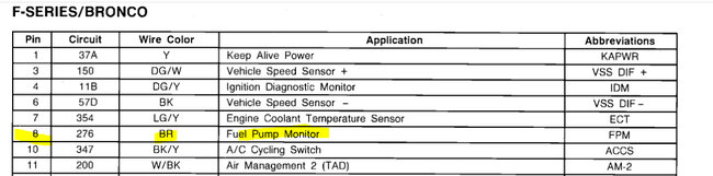

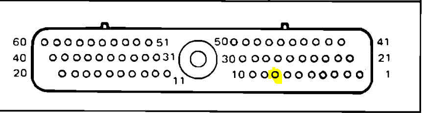

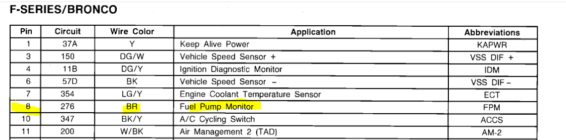

Okay, we need to return to the inertia switch. Are you certain there is no power at the brown wire to it? Are you testing it with a test light or multimeter? Are you using a known good ground location when testing?
If that is all good, try switching the EEC relay. The relay is what powers the electronic engine control module. If the relay doesn't make a change, we need to access the EEC module under the dash and check pin 8 for damage, corrosion, or any evidence of failure. See pics below

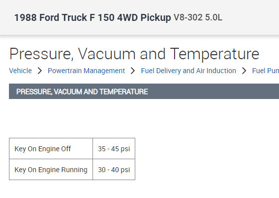

Hi, here's an update: i rewired the inertia switch from the relay turns out it lost power somewhere down the wire so my fuel pump comes on and inertia switch work now but i think it has a fuel problem I replaced the fuel filter and as i previously said i replaced the fuel pump in the tank only think i can think of is maybe the inline fuel pump is weak and can’t provide enough fuel pressure.
Sep 17, 2024 at 2:17 PM
  • 110,244 POSTS
Were you able to check the pressure being supplied? I attached the specifications for pressure below.
Sep 18, 2024 at 10:42 AM

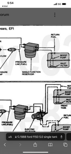

I haven't checked the pressure. i replaced the in-line fuel pump today but the o ring on my reservoir fuel filter is gone so it just dumps gas when you turn the ignition. Do you know what the part number is for that or where to get one?
Sep 18, 2024 at 11:44 AM
  • 110,244 POSTS
The only thing I have for that is the fuel filter part number. It's E7DZ9155A. If you are looking for the quick connectors, I don't have the OEM part numbers. You would likely have to find something at a parts store.
Sep 18, 2024 at 12:41 PM
HITO_300
  • 6 POSTS
It's not the normal fuel filter it's like the selector but i only have one tank i added a picture so you can see it.
Sep 18, 2024 at 9:56 PM
  • 110,244 POSTS
Do you mean it is similar, but your truck only has one tank from the factory? I'm not sure I understand.

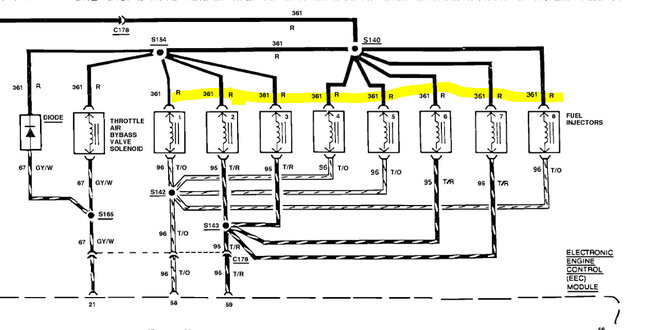

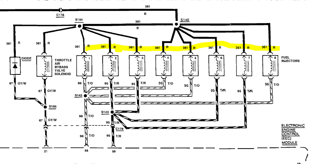

If it tried starting with starting fluid, we know it isn't getting fuel. So, if the pump is new the next thing I would check is if there is power to the fuel injectors.
If you look below, I attached the schematic for the injectors. Note that each one has a red wire. With the key in the run position, the red wires should have power.
Check to see if that is the case and let me know.
See pic below.
