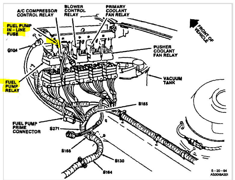

Hey everyone, I have the car listed above and for the life of me I can’t figure out why it won’t start. Fuel pump relay new, fuel pump new, fuses good, but still nothing. I spray starter fluid and it does run. But no power to the fuel pump, or relay. I did power the red connector that comes out of the relay to the battery. I can hear a humming in the engine, and fuel comes out of the test valve. Any suggestions? I even changed the fusible links coming from the starter.

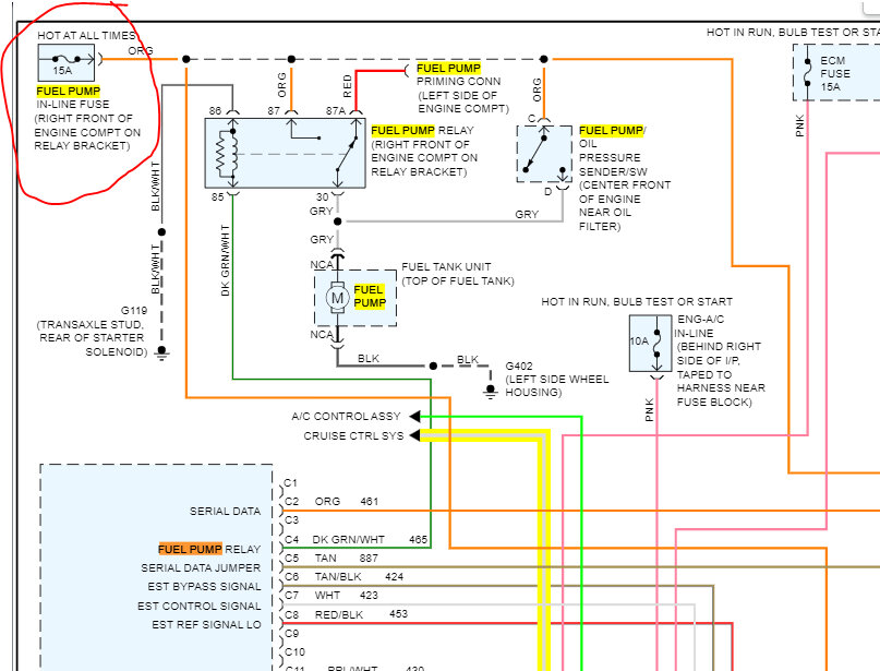

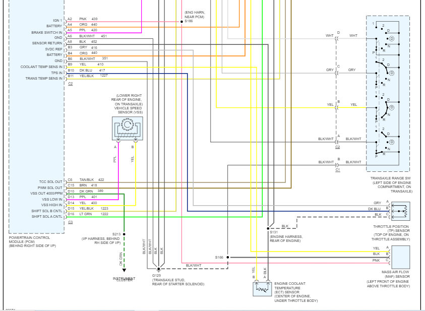

There is a 15 amp in-line fuse on the relay bracket under the hood. (Passenger side) Have you checked it? Are you getting power to the relay pin 87 in at the connector? Also, relay pin 85 should get voltage from the PCM to actuate the relay. Are you getting power to it as well?
Let me know. Also, I attached a pic below showing the schematic related to the relay, so you have a reference. Additionally, here is a link you may find of interest:
Let me know what you find or if you have questions. Also, pic 2 shows the fuse location.

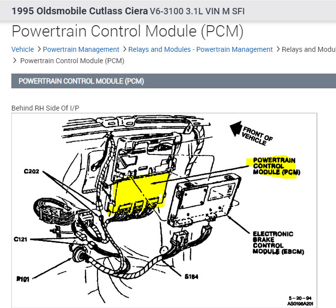

There is no power at the relay. And the fuse is good. Where is the PCM? I’m new to these cars.
Oct 10, 2022 at 10:49 PM
  • 110,251 POSTS
The PCM is behind the dash on the passenger side of the interior. If you look below, I highlighted the PCM for you.
Let me know if this helps.
See pic below.

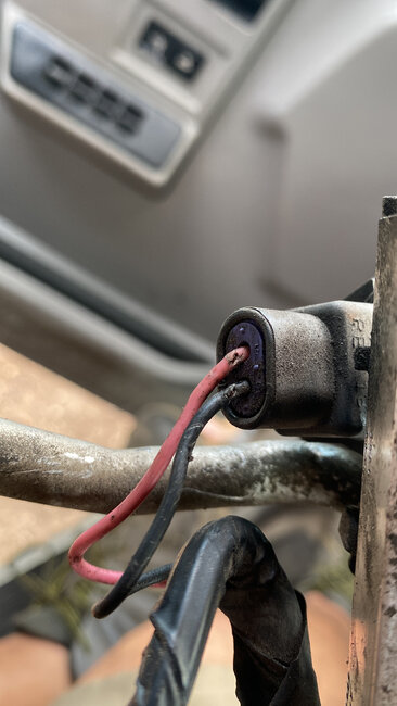

I found this while inspecting the fuel injectors. Some injectors look really dirty.
Oct 11, 2022 at 9:22 PM
  • 110,251 POSTS
The marks on the wiring appear to be from someone in the past probing them. If you remove the connector, is there still power to them?

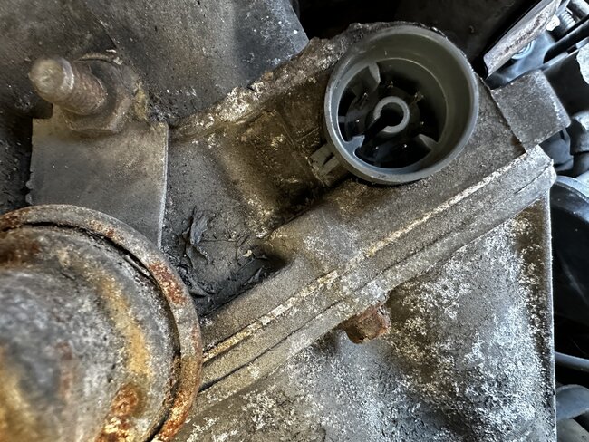

There is a small sensor below the throttle body on the transmission that is round, what is it called and how u take it off? Any suggestions?
Nov 7, 2022 at 10:44 AM
  • 110,251 POSTS
Is it possible for you to take a pic of what you are seeing and upload it for me? I'm not sure what you are seeing.
I attached a pic below of the throttle body area. Do you see the sensor in that pic?
see pic below.
Nov 7, 2022 at 11:22 AM
ELMAMALON78
  • 16 POSTS
No sir, it actually towards the front of the motor facing the radiator. It’s round trip n the transmission.
Nov 7, 2022 at 11:25 AM
ELMAMALON78
  • 16 POSTS
This is on another car.
Nov 7, 2022 at 11:26 AM

I have never seen that type of connection on one of these. I even asked a different tech, and he said the same.
Can you get a couple of pics of the connector and the sensor from different angles?
Nov 7, 2022 at 1:00 PM
ELMAMALON78
  • 16 POSTS

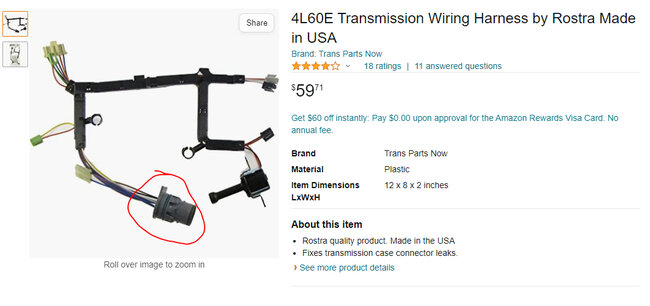

From some other pics online, I was thinking it’s the transmission pressure switch. But I’ll get some pictures.

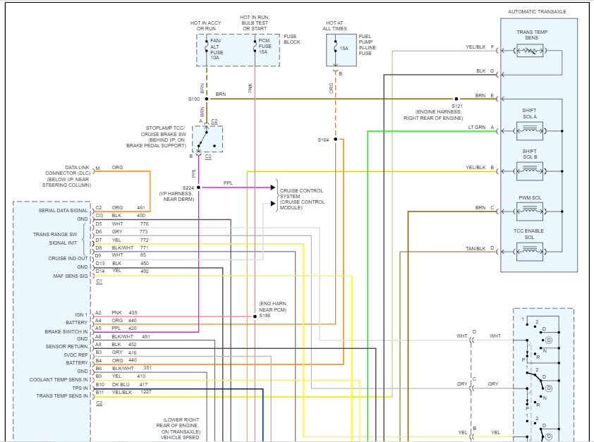

  • 110,251 POSTS

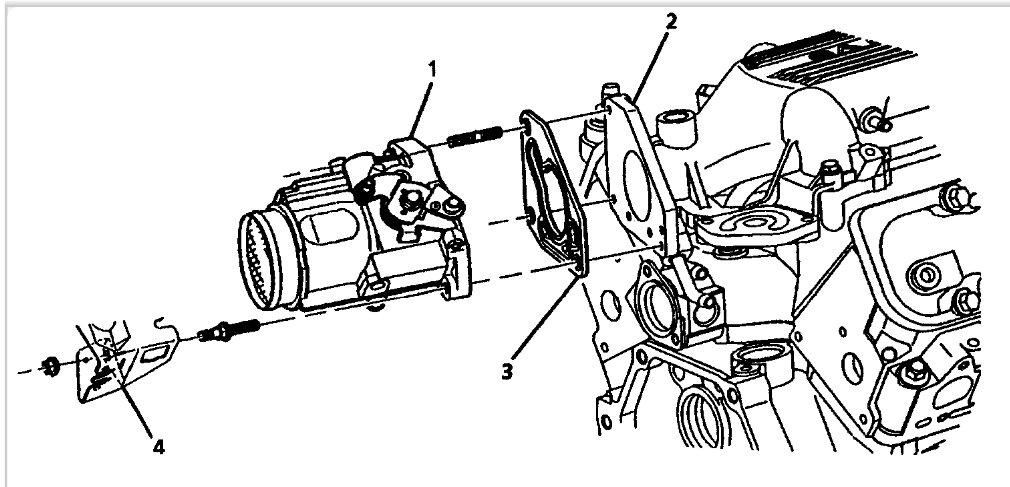

The pressure switch is internal and only has two wires. The connector you have has seven pins. The only thing I can think of is that it is for the different shift solenoids and the temperature sensor inside the transmission.
Do me a favor. I attached the wiring schematic below for the transmission. Note there are seven wires going to the transmission. See if the colors indicated in the pic are the same as the wiring to the connector you have.
Update. I found it. It is part of the transmission wiring harness and is for what I mentioned above. It took some digging, but I found the harness online. Take a look at pic 3. That is on Amazon.
