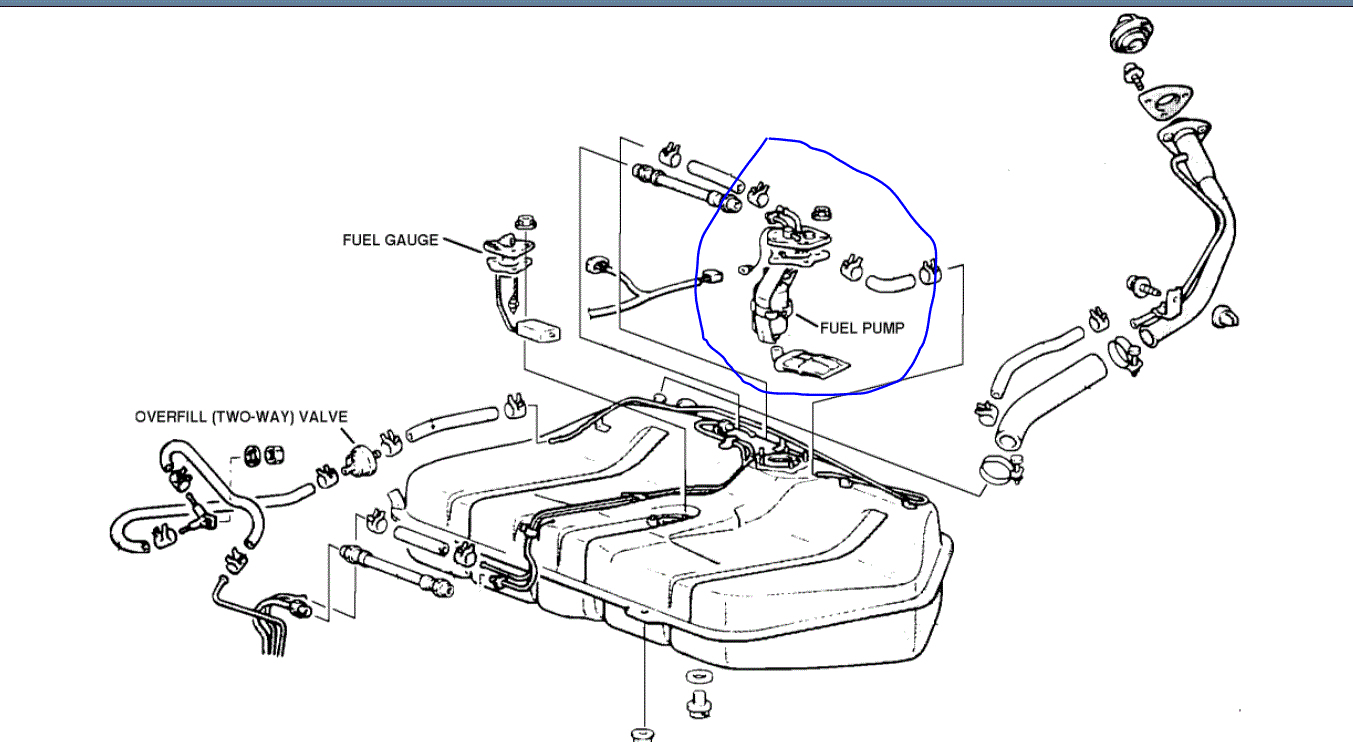

where is the fuel pump located? the engine is fuel injected.
Nov 21, 2020 at 8:06 PM
  • 110,194 POSTS

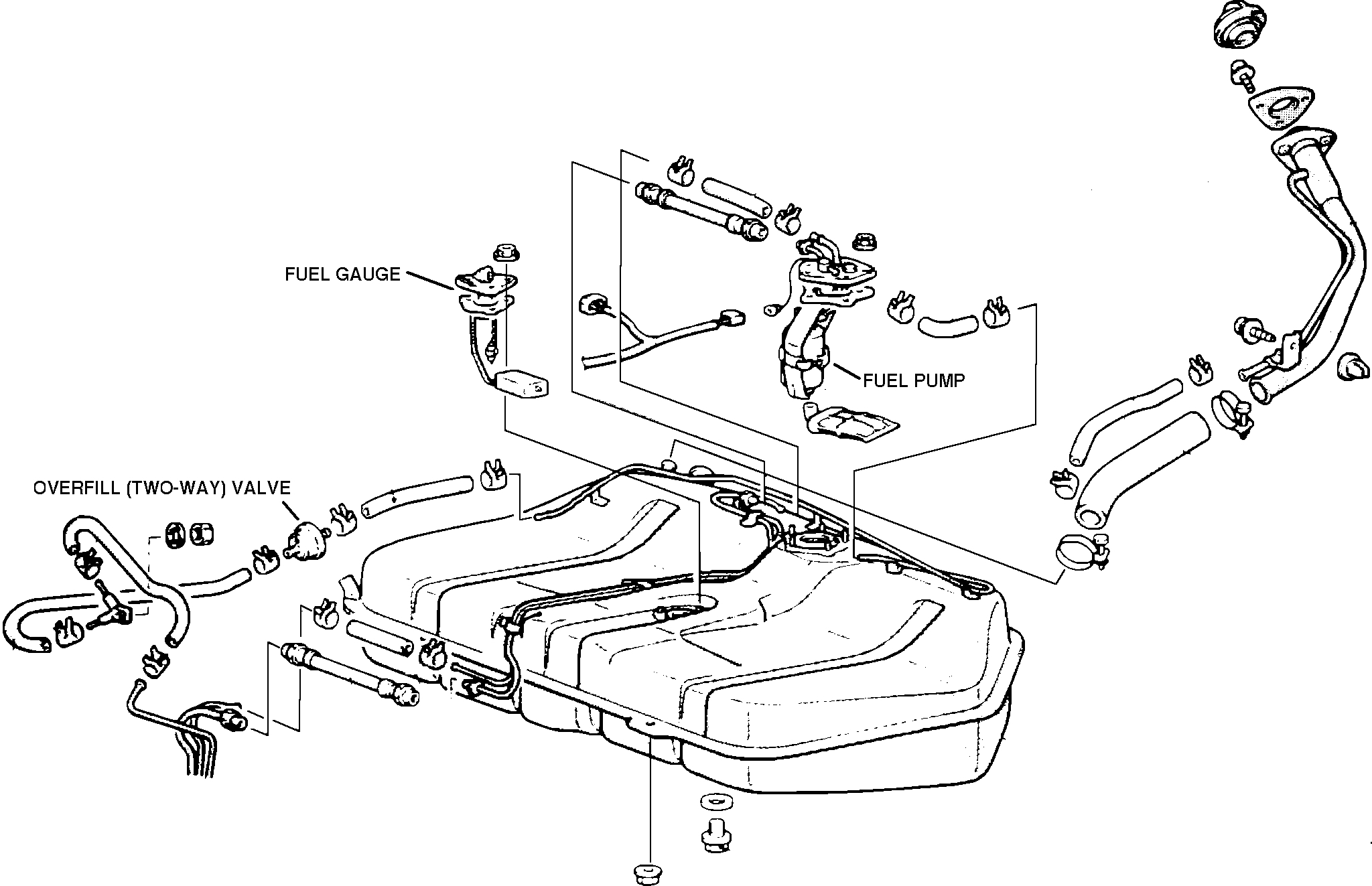

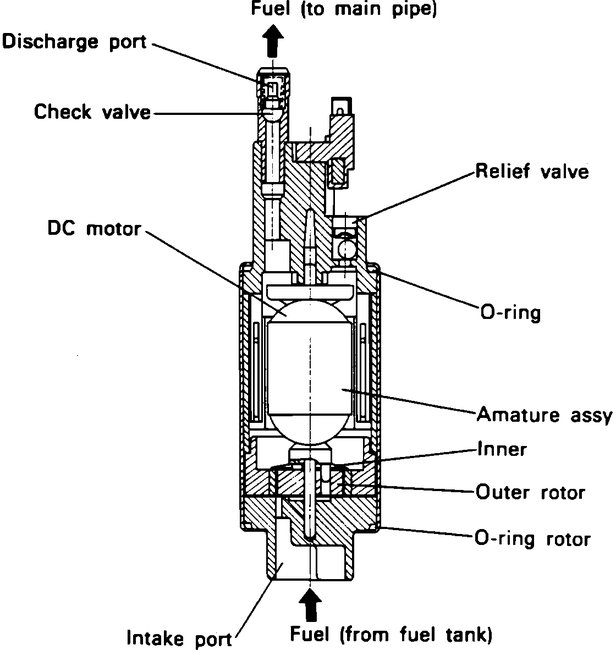

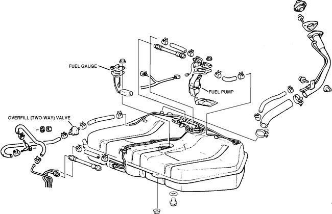

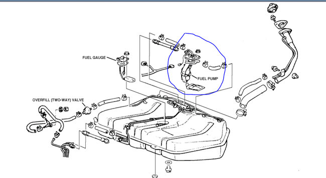

The pump is in the fuel tank. See pic 1. You will need to remove the tank to replace it. Note: This information is for the 1989 Mitsubishi Mirage which is what took the Lancer's place.

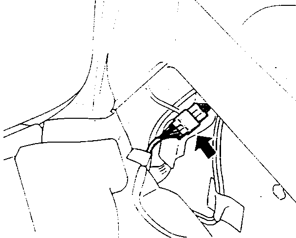

High Pressure Electric Fuel Pump
Pic 2
REMOVAL
Fuel tank removal is required to service the fuel pump. For these procedures refer to FUEL TANK, under the appropriate paragraph heading.

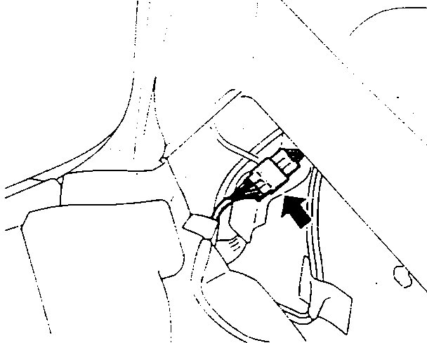

Fuel Pump Mounting Screws
Pic 3
After fuel tank removal, remove the fuel pump installation screws, then remove the pump from the fuel tank.

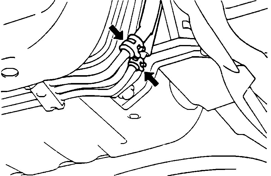

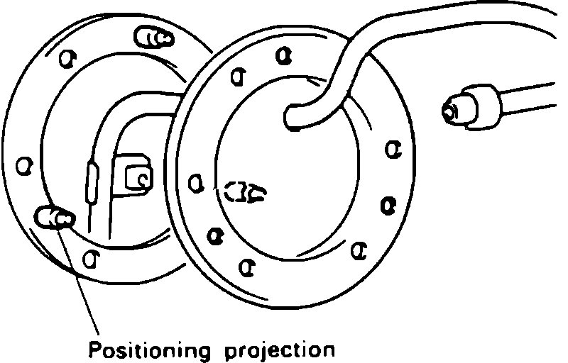

Fuel Pump Positioning Projections
Pic 4
1. Install the gasket, taking care to properly align it with the three positioning projections.
2. As the fuel pump is re-installed, align the three positioning projections with the holes in the fuel pump. Care should be taken at this time to insure that the gasket is properly seated.

Fuel Tank And Components
pic 5

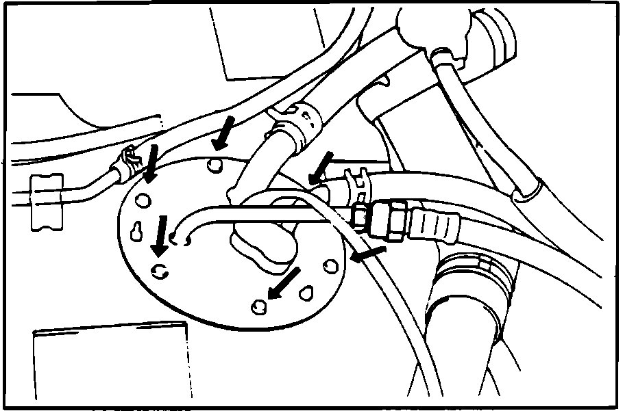

REMOVAL

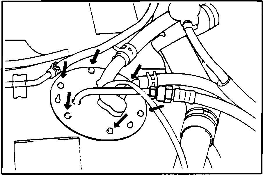

Fuel Pump Connector Location
pic 6
1. Disconnect the fuel pump and fuel gauge connectors.

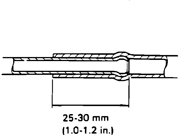

2. Connect the leveling hose, from the tank, approximately 1.6 in. (40mm) onto the filler neck.
3. Connecting the filler hose.
Vapor Hose Connection Specifications
pic 8
4. Connect the vapor hose and return line as shown in the illustration.

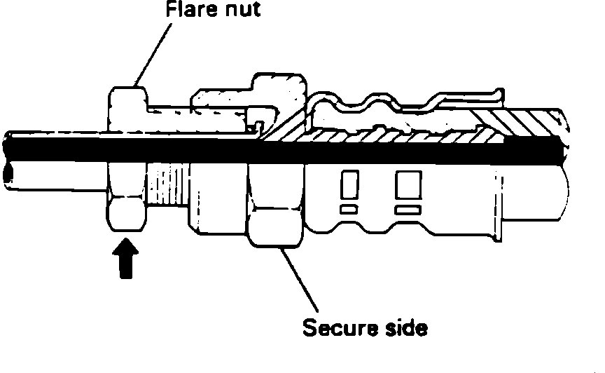

High Pressure Hose Connection
pic 9
5. Connect the high pressure hose.
CAUTION: When tightening the flare nut, be careful not to bend or twist the line.
