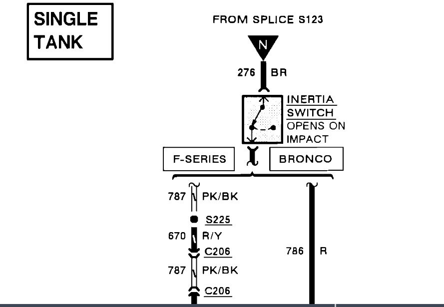

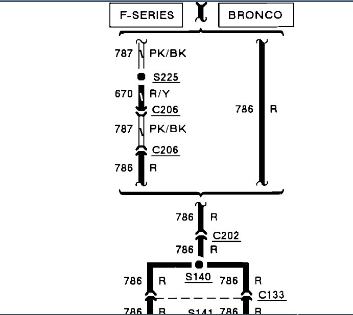

The fuel pump wont shut off until it drains the battery or the battery is disconnected. I can't figure out the Chilton book. Need to know where the fuses are and the power wires.

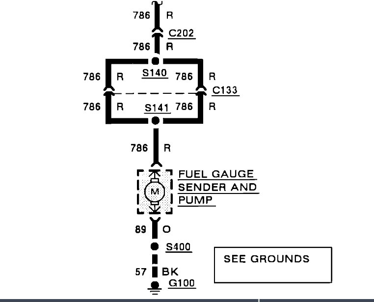

This sounds like you have a short to power somewhere in the wires going to the fuel pump which is located in your vehicle's fuel tank. Does your vehicle have 1 or 2 fuel tanks?

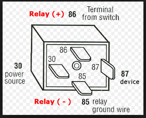

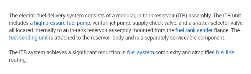

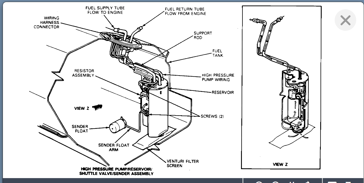

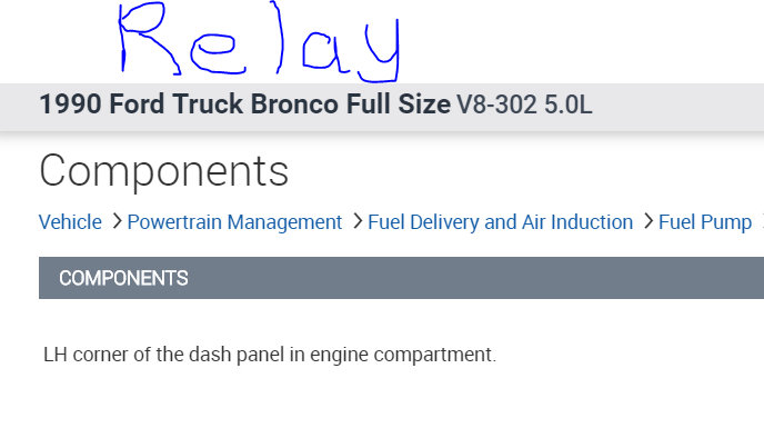

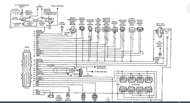

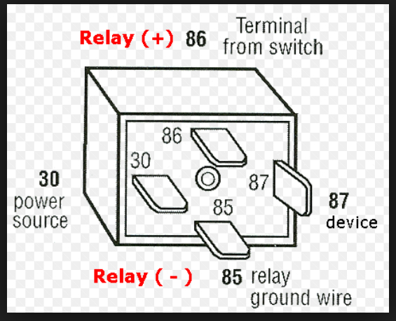

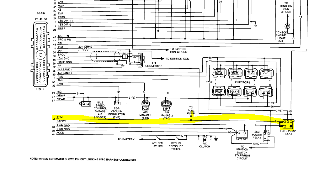

In the diagrams down below I have included a wiring diagram for your vehicle's fuel pump as well the exploded diagram of the pump and a description of the EFI system. With the ignition key off I want you to take a voltage reading pin #86 of the fuel pump relay. I have included a link below if you are unfamiliar with how to use a multimeter.
Please get back to us with what your voltage reading and we will go from there.
