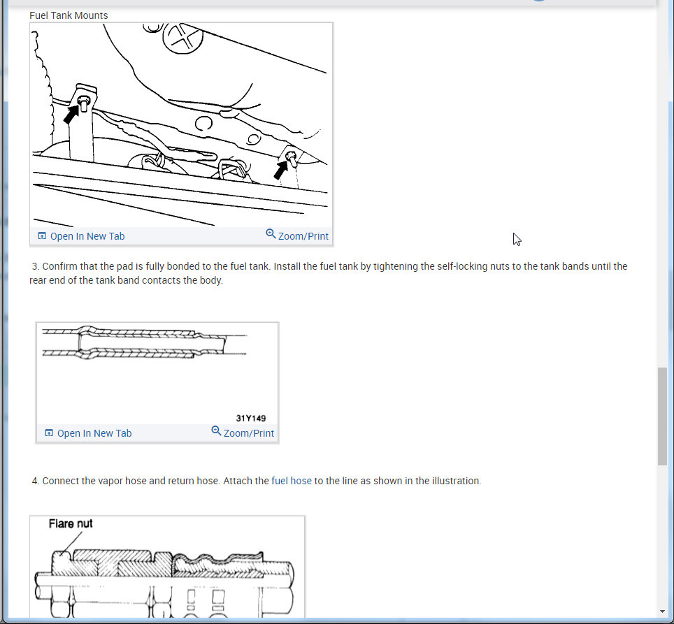

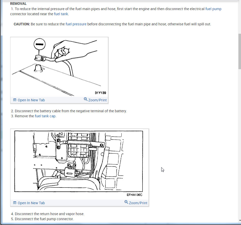

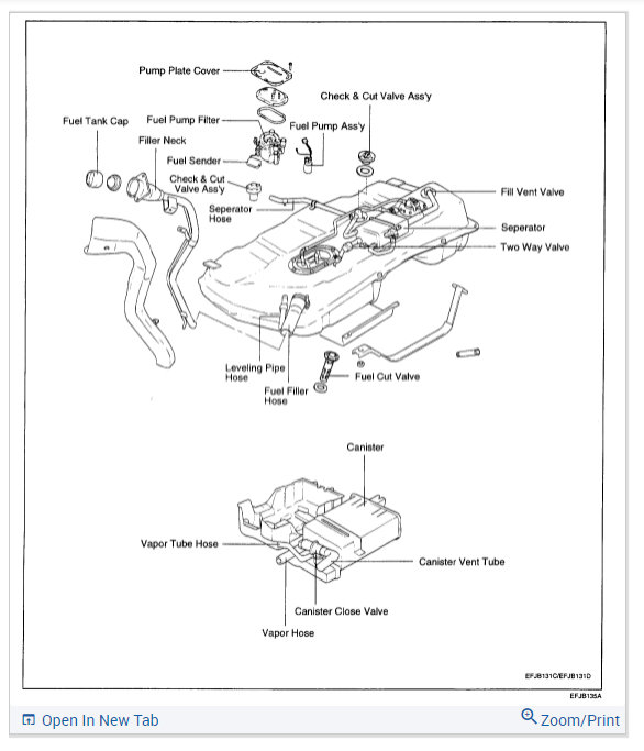

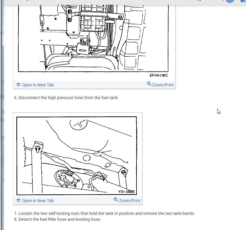

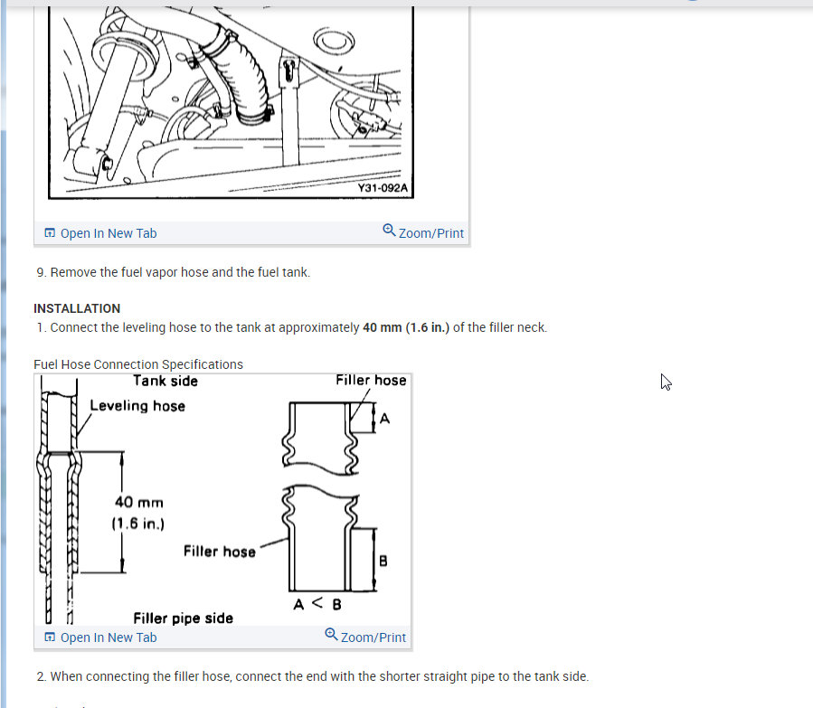

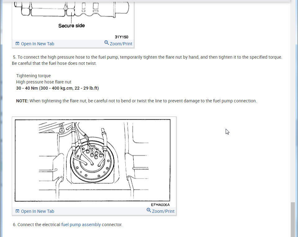

So if the pump makes no noise and it doesn't start then it does when you do hear the pump then the pump is the issue.
Here is a guide that that will help with testing the pump if you want to confirm this:
Also, here is a guide on how to replace the pump as well:
https://www.2carpros.com/articles/how-to-replace-an-electric-fuel-pump
Below you will find the process from the manual that will help with this as well. Please let us know if you have other questions. Thanks
