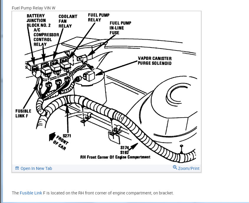

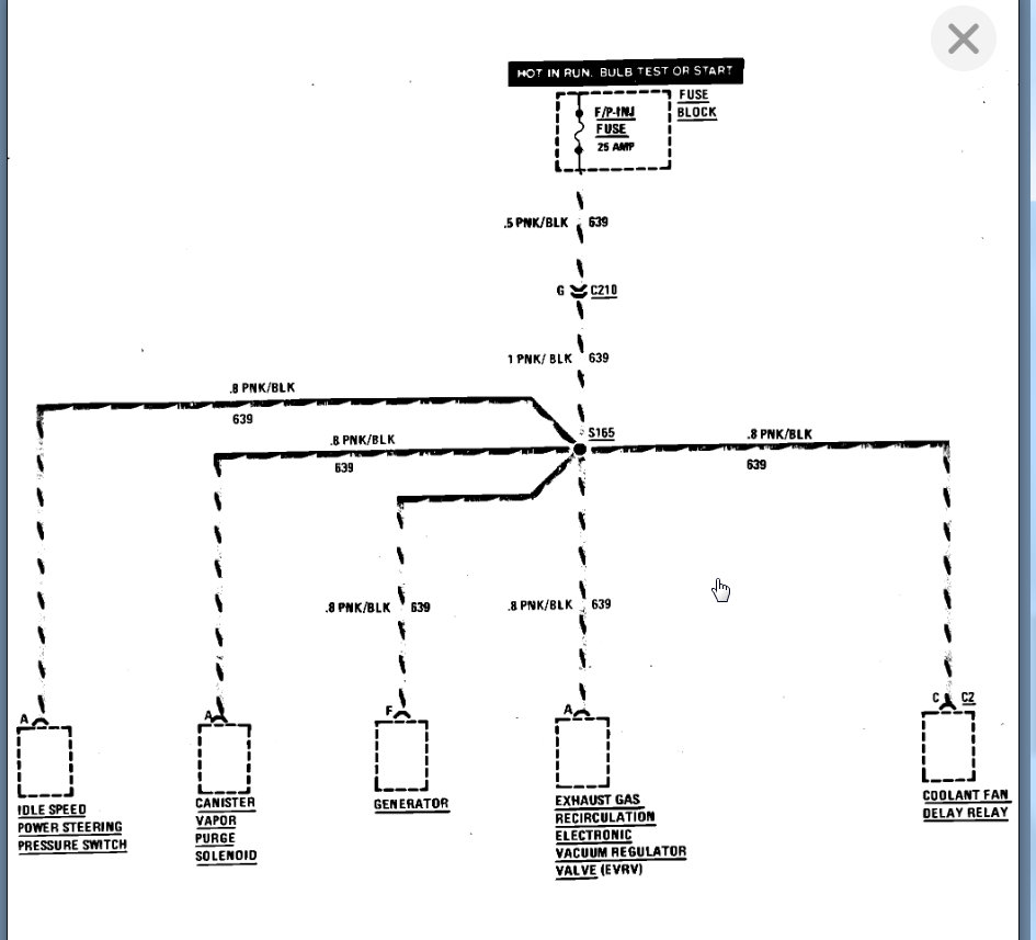

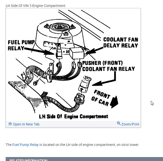

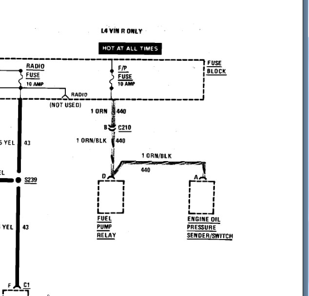

Location of fuel pump fuse and relays.
May 5, 2020 at 7:38 AM
Experienced Mechanic
18,907 POSTS
I attached the needed info. Let me know if you need more info and we can go from there. Check out the diagrams (Below). Please let us know if you need anything else to get the problem fixed. Thanks
