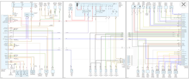

Replaced the fuel pump but still wont start. Is there a reset button that I need to push? Where is the reset button located?
Wednesday, April 3rd, 2019 AT 5:40 AM
2 Replies
  • 52,797 POSTS

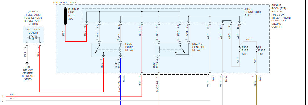

Good morning,
No, there is no reset for the pump.
Did you check for power to the pump? I attached a wire diagram for you to view. You need to verify power to the pump. There are a couple of fuses listed to check. Make sure you test for power on both sides to be sure power is available.

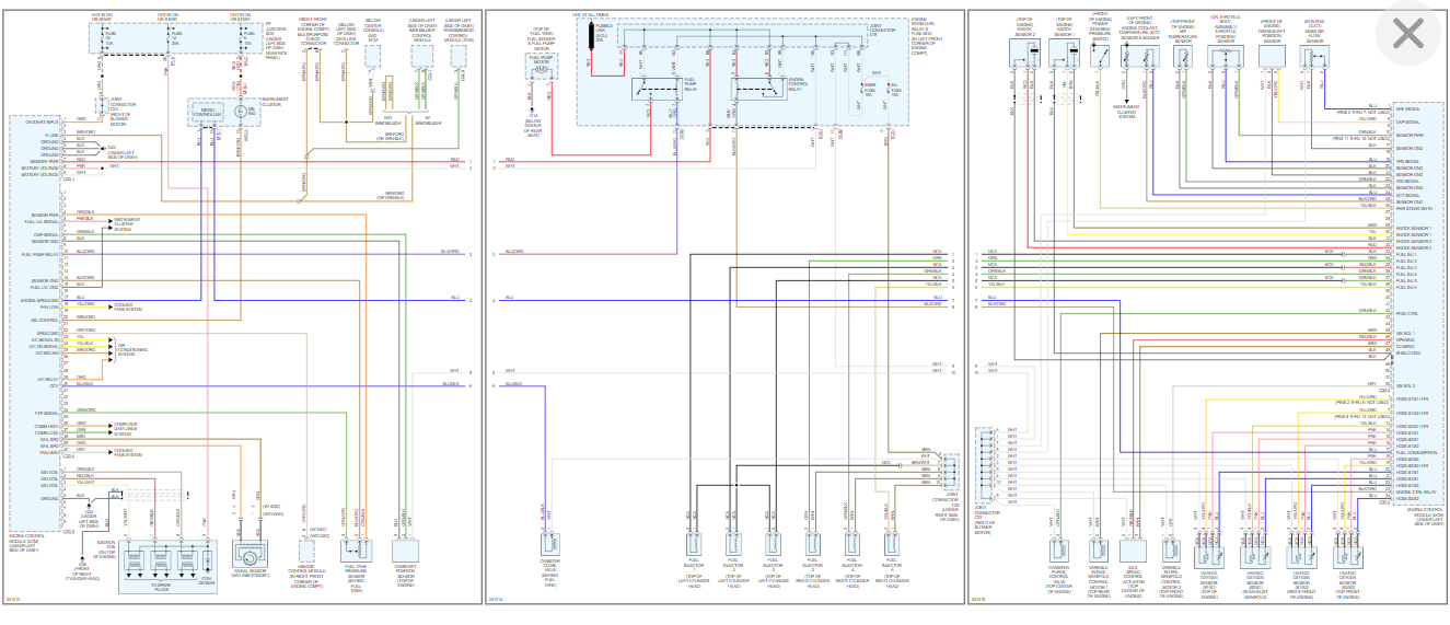

Changed fuel pump but still wont start. The fuse diagram that was sent does not match the one on my vehicle.
