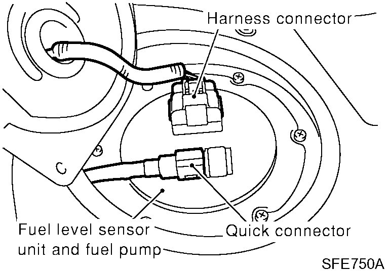

My car won’t start it will crank but not turn over. I was wondering if it were possible if it could be caused by the fuel pump?

For an engine to run, it needs compression, spark to the plugs, and fuel. Also, timing must be correct. So to answer your question, yes, the pump may have failed.
Now, I am going to provide a link for a crank no start condition. Look through that first and let me know if it helps.
If you feel comfortable performing the test, here is a link showing how to check for spark:
Here is a link that shows how to check fuel pressure:

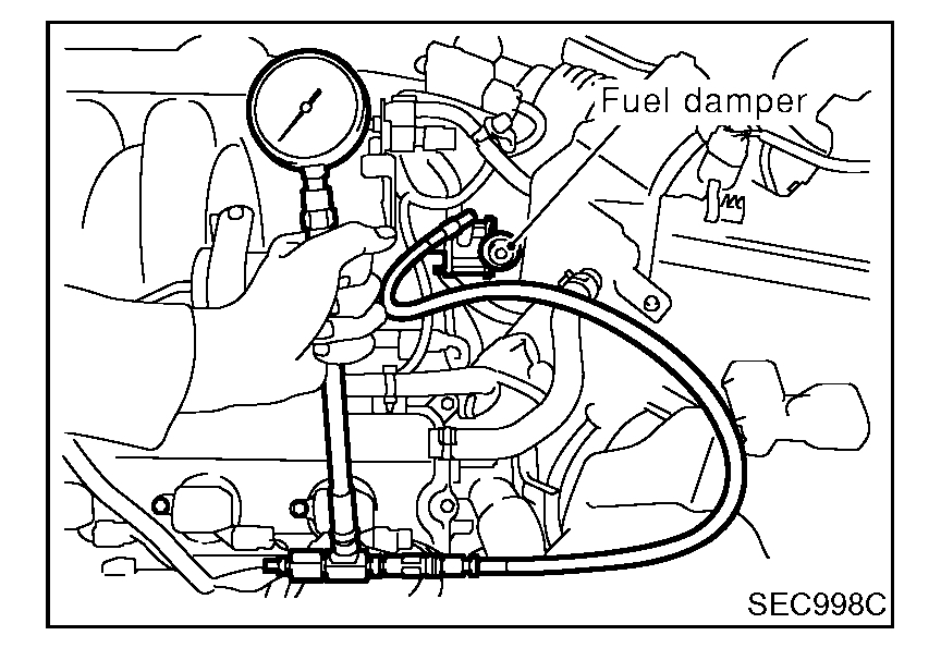

2. Disconnect fuel tube joint between fuel damper and injector tube and set fuel pressure check adapter (J44321).
picture 2

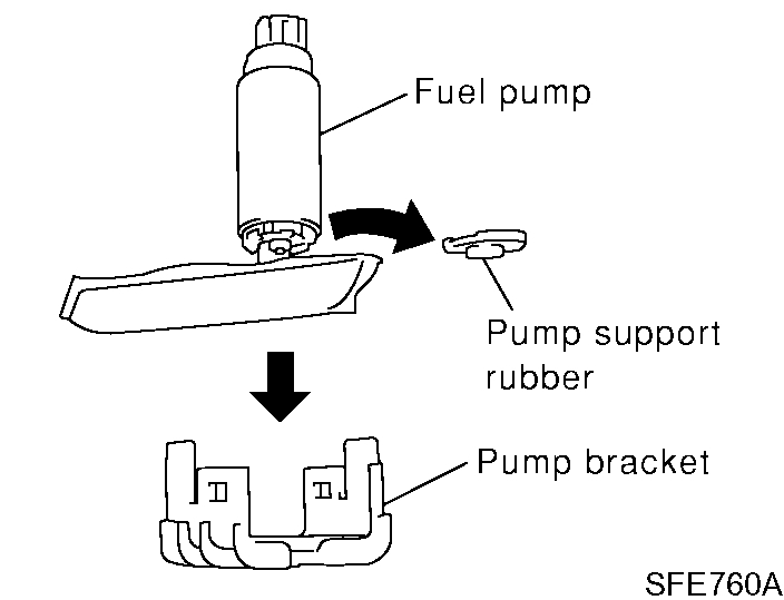

If you find the fuel pump is bad, here are the directions for replacing it. Also, these directions include info for the filter, too. I would recommend replacing it at the same time.

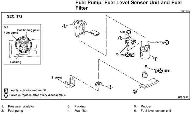

Fuel Pump, Fuel Level Sensor Unit And Fuel Filter
Picture 3

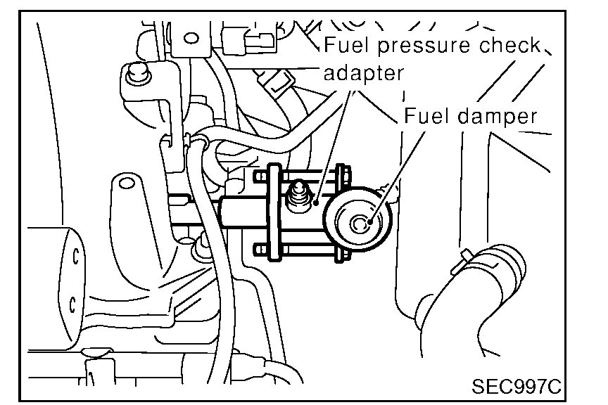

REMOVAL
picture 4
1. Release fuel pressure from fuel line.
Refer to "Fuel Pressure Release".
2. Remove rear seat bottom.
3. Remove inspection hole cover located under the rear seat.
4. Disconnect electrical connector.
5. Disconnect the quick connectors.
- For disconnection of quick connectors, refer to step 6. of "Fuel Tank Removal".

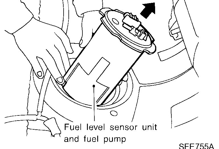

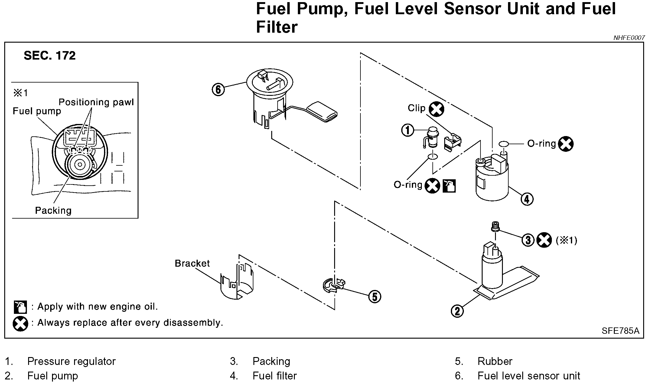

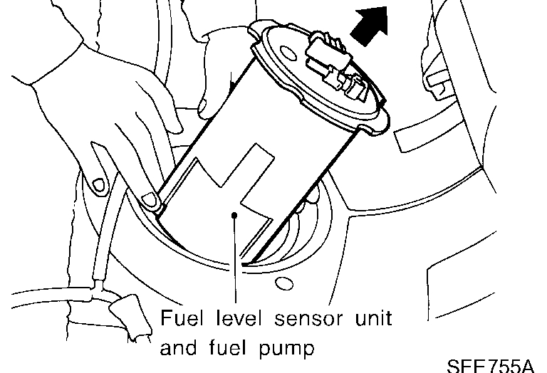

6. Remove the six bolts.
picture 5
7. Pull out the fuel level sensor unit and fuel pump.
- Do not damage the arm of the fuel level sensor and fuel tank temperature sensor.

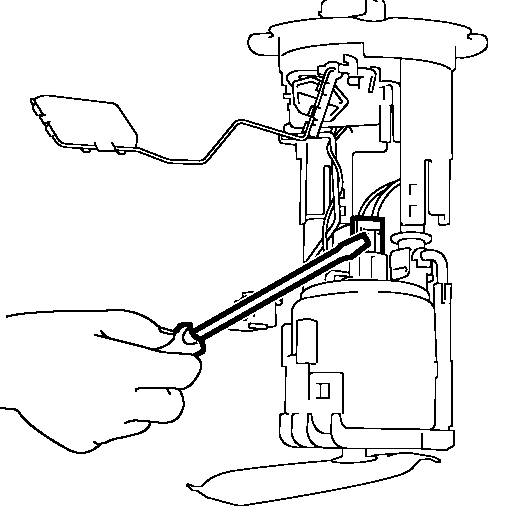

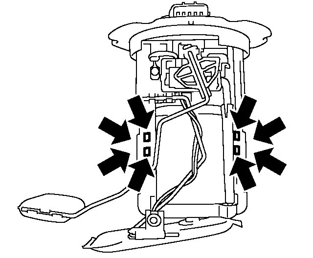

picture 6

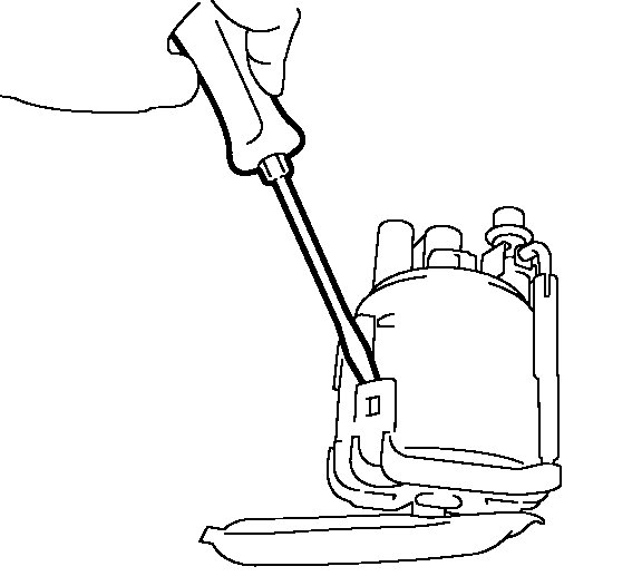

8. Remove flange of fuel level sensor unit and fuel pump.
- Using a screwdriver, remove the snap fit portion as shown in the figure.

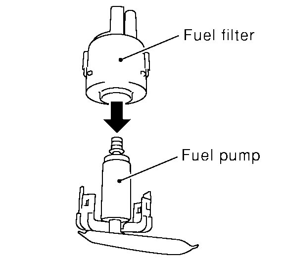

11. Remove fuel filter from pump bracket.

13. Remove fuel pump, then push down the fuel pump as shown in the figure.
14. Remove packing from fuel pump.
picture 10
15. Remove the pump support rubber from the fuel pump.

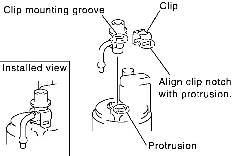

Fuel Pressure Regulator
picture 11
- Install the pressure regulator as follows.
a. Insert the clip to the groove of the regulator.
b. With the clip installed, insert the regulator straight by matching the fuel filter protrusion and the clip notch.
c. Make sure that the fuel filter protrusion and clip notch are securely engaged.

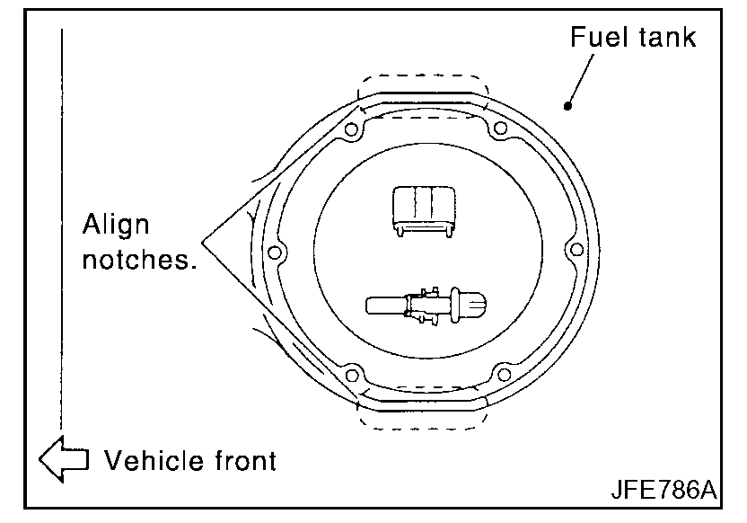

picture 12
- Install retainer so that its notch becomes parallel with notch on fuel tank.
- Tighten retainer mounting bolts evenly.

I know this seems like a lot, but it really isn't that bad to do. You are lucky because the fuel tank doesn't need removed to access the pump.
Let me know if you have other questions or need help.
