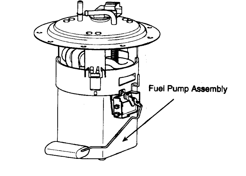

Hi, i changed my electric fuel pump tonight and i want to know what is this red piece at the end of fuel pump cover and what's doing? Does it have a part number? Mine is out of shape and i am worry about this little plastic thing. Thanks

Good evening,
Does this piece cover a hole at the bottom of the unit?
What is on the other side?
I do not see it listed anywhere separately.
Did you replace just the motor or the entire unit?

Yes, it covers a hole. Nothing on the other side it's the end of fuel pump cover. I replaced just motor. i think it hold fuel in the cover.

Yep, I agree. The part is not available on its own.

I found it at a store finally. I have another question. i feel my car accelerate better just after i fill my tank. After half tank used it accelerate slower than with full tank. What can be cause this?

Could be fuel pressure itself. the level is what it has in common. the lower the level the less amount of fuel by the pump.

Do you mean fuel pump is faulty? How can i check for sure? Fuel pressure test on this models need a expensive adapter and no where has it in my place. I find a little plastic thing that i mentioned and i don't know what's it's name from a seller who sells second hand parts.

Very possible it is the pump.
is that piece from another fuel pump? you cannot use anything from a parts store that caps off a line. it will disintegrate in fuel.
