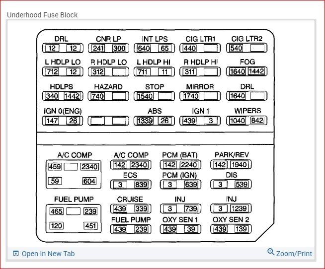

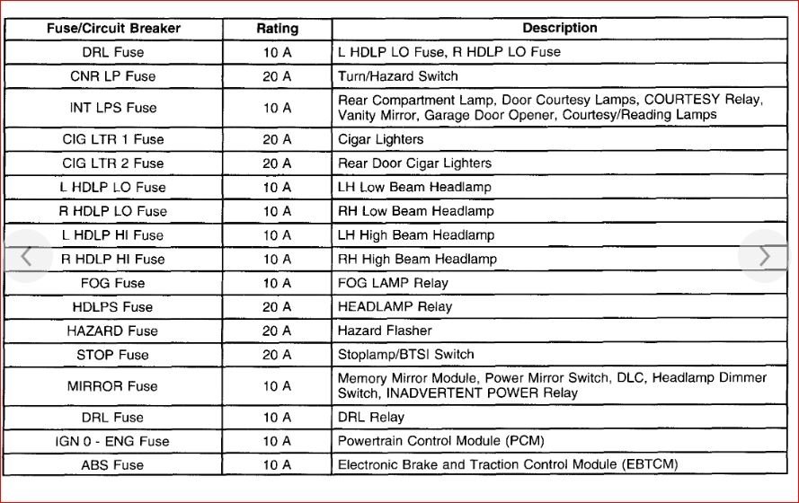

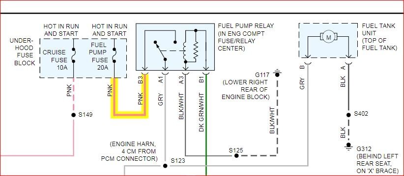

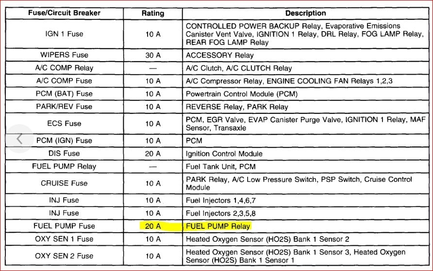

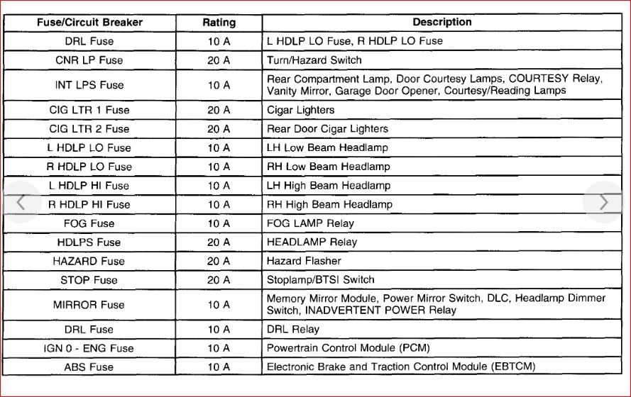

I want to know where the fuel pump relay gets its power from.
Sunday, June 9th, 2019 AT 2:59 PM
MECHANIC
18,907 POSTS
Hi Dawn,
Looks like there is a fuse that feeds the relay in the underhood fuse block.
I included the wiring diagram and the fuse block layout. Let me know if you need more information. Thanks
