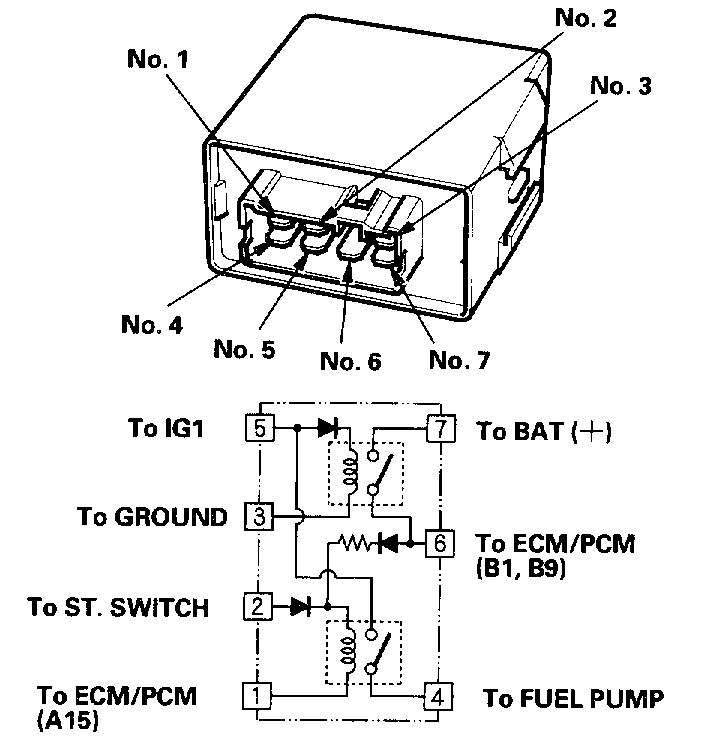

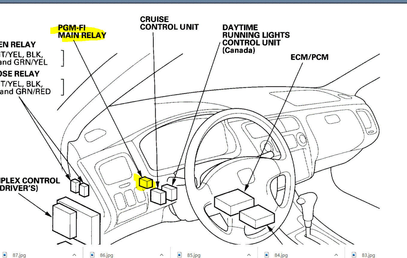

the fuel pump is not shutting off after the two second prime. it appears it is running continuously. I disconnected the fuel line and the fuel is just running non stop
Oct 31, 2020 at 2:28 AM
  • 110,240 POSTS
Is it running with the key off?
Do me a favor. I need you to remove the fuel pump relay to see if it stops running. If it does, you will need to check the relay. It may have failed. If it doesn't, then we have a short to power at some point.
Here is a link that shows how to check a relay:

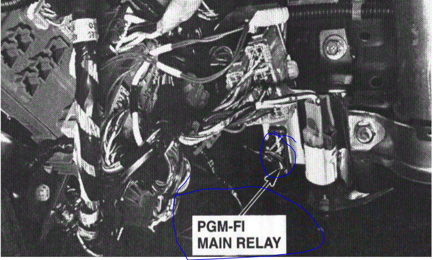

I attached two pics below to help you locate the correct relay.
Oct 31, 2020 at 12:33 PM
ADEVONISH
Hi, no it's not running with the key off. And yes I did remove the relay and it stopped. I thought the relay was bad so I replaced it but the same thing is happening. I also noticed that the check engine light is not going off. One other thing I noticed is that with the key on the fans are running.
Oct 31, 2020 at 11:29 PM
  • 110,240 POSTS
The PGM-FI relay contains two separate relays. One is energized whenever the ignition is on which supplies battery voltage to the ECM/PCM, power to the fuel injectors, and power for the second relay. The second relay is energized to supply power to the fuel pump for two seconds when the ignition is switched on, and when the engine is running.
Did you get a direct replacement for the relay when you replaced it? If you did, we need to see why the second relay keeps receiving a signal to constantly feed power to the pump. Since you noticed the fan running constantly, there is likely a short to power at some point or the PCM may have failed.

Here are directions to diagnose a relay problem. The attached pics correlate with the directions.
_________________________
1999 Honda Accord EX Coupe V6-3.0L
Component Tests and General Diagnostics
Vehicle Powertrain Management Fuel Delivery and Air Induction Fuel Pump Fuel Pump Relay Testing and Inspection Component Tests and General Diagnostics
COMPONENT TESTS AND GENERAL DIAGNOSTICS

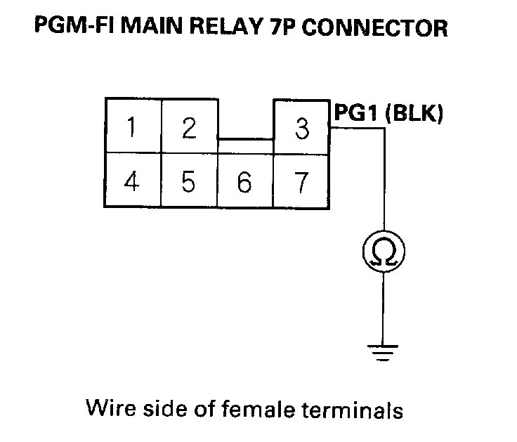

1. Turn the ignition switch OFF, then disconnect the PGM-FI main relay 7P connector.
pic 1
2. Check for continuity between body ground and the PGM-FI main relay 7P connector terminal No.3.
Is there continuity?
YES-Go to step 3.
NO-Repair open in the wire between the PGM-FI main relay and G101.
pic 2

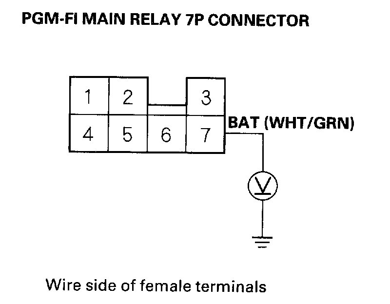

3. Measure voltage between body ground and the PGM-FI main relay 7P connector terminal No.7.
Is there battery voltage?
YES-Go to step 5.
NO-Go to step 4.
4. Check for a blown ACG S (15 A) fuse in the under- hood fuse/relay box.
Is the fuse blown?
YES-Repair the short in the wire between the PGM-FI main relay and the ACG S (15 A) fuse.
NO-Repair the open in the wire between the PGM-FI main relay and the ACG S (15 A) fuse.

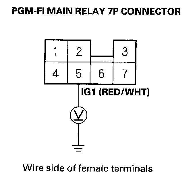

5. Turn the ignition switch ON (II), and measure voltage between body ground and the PGM-FI main relay 7P connector terminal No.5.
YES-Go to step 7.
NO-Go to step 6.
6. Check for a blown No.1 FUEL PUMP (15 A) fuse in the driver's under-dash fuse/relay box.
Is the fuse blown?
YES-Repair the short in the wire between the PGM-FI main relay and the No.1 FUEL PUMP (15 A) fuse.
NO-Repair the open in the wire between the PGM-FI main relay and the No.1 FUEL PUMP (15 A) fuse.

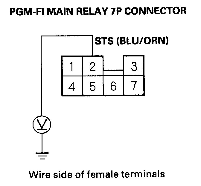

7. Push the clutch pedal in, or shift to Park, then turn the ignition switch to the START (III) position, and measure voltage between body ground and the PGM-FI main relay 7P connector terminal No.2.
YES-Go to step 9.
NO-Go to step 8.
8. Check for a blown No.13 STARTER SIGNAL (7.5 A) fuse in the driver's under-dash fuse/relay box.
Is the fuse blown?
YES-Repair the short in the wire between the PGM-FI main relay and the No.13 STARTER SIGNAL (7.5 A) fuse.
NO-Repair the open in the wire between the PGM-FI main relay and the No.13 STARTER SIGNAL (7.5 A).

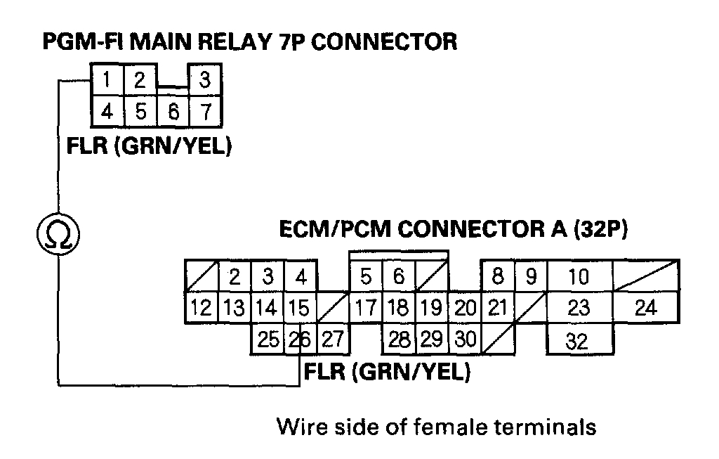

9. Turn the ignition switch OFF, and disconnect the ECM/PCM connector A (32P).
pic 5
10. Check for continuity between the PGM-FI main relay 7P connector terminal No.1 and the ECM/PCM connector terminal A15.
YES-Go to step 11.
NO-Repair open in the wire between the PGM-FI main relay and the ECM/PCM (A15).

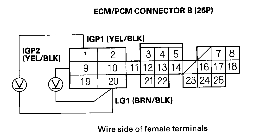

12. Turn the ignition switch ON (II), and measure voltage between the ECM/PCM connector terminals B1 and B20, and between B9 and B20.
YES-Go to step 13.
NO-Check for an open in the wires between the PGM-FI main relay and the ECM/PCM (B1,B9). If the wires are OK, replace the PGM-FI main relay.
pic 7

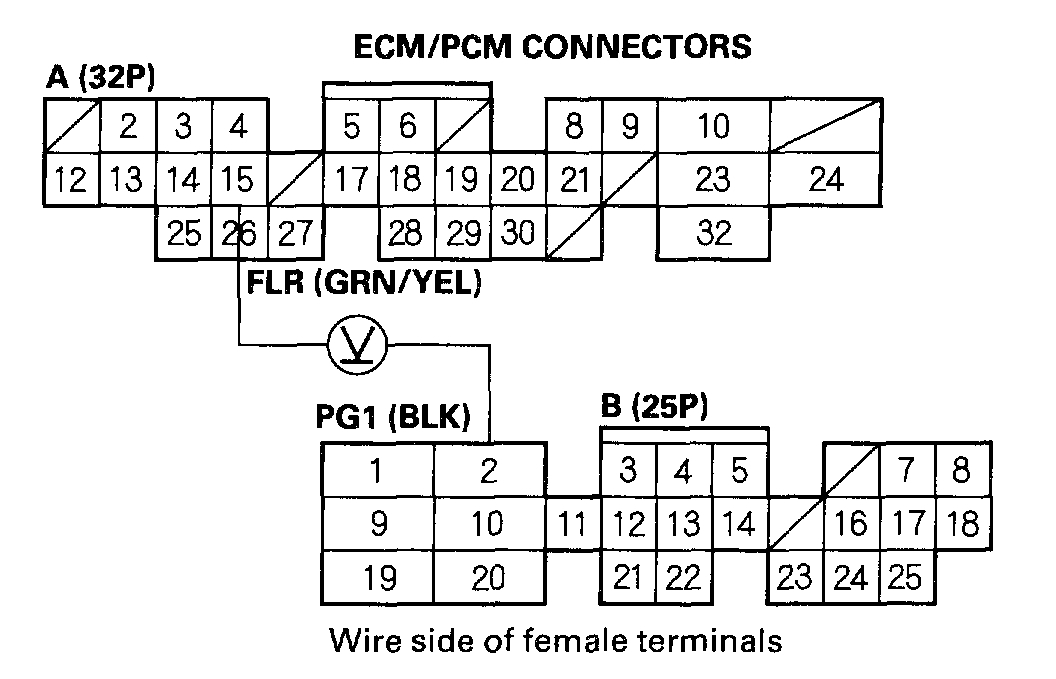

13. Turn the ignition switch OFF, then ON (II) again, and measure voltage between the ECM/PCM connector terminals A15 and B2 within the first two seconds after the ignition switch is turned ON (II).
Is there 1.0 V or less?
YES- PGM-FI main relay may be faulty: go to step 14.
NO-Substitute a known-good ECM/PCM and recheck. If prescribed voltage is now available, replace the original ECM/PCM.
See: Computers and Control Systems > Initial Inspection and Diagnostic Overview > Diagnostic Strategies
