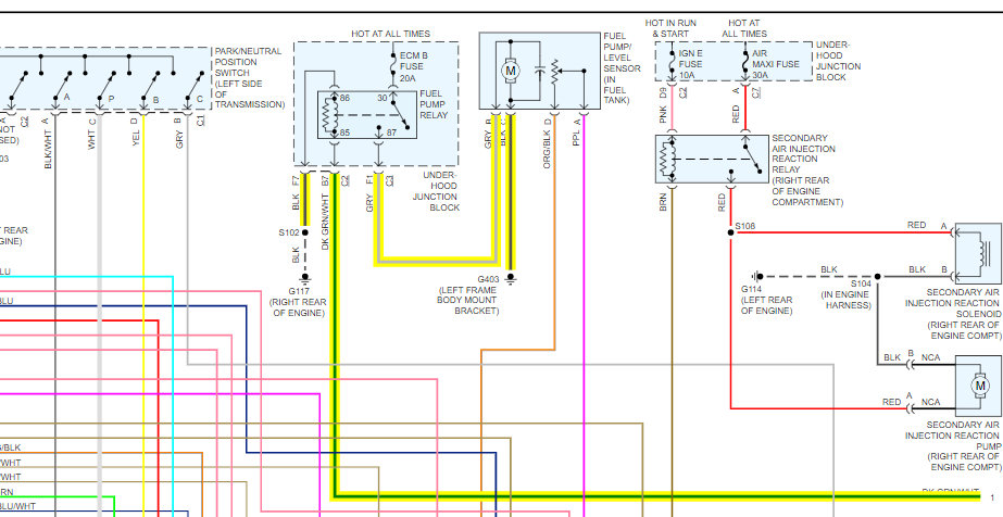

No power to fuel pump
2000 CHEVROLET SILVERADO
270,566 MILES • 5.3L • V8 • 4WD • AUTOMATIC
MDMORENO
Checked fuses and replace crankshaft position sensor.
Apr 3, 2019 at 2:07 AM
Good afternoon,

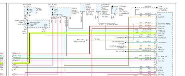

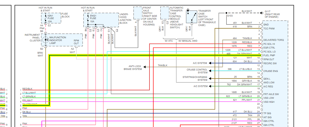

I attached a diagram of the fuel pump circuit.
The PCM sends a voltage to the control side of the relay. That will activate the load side to the pump. Check the fuse listed in the diagram for power.
Apr 3, 2019 at 4:33 AM
