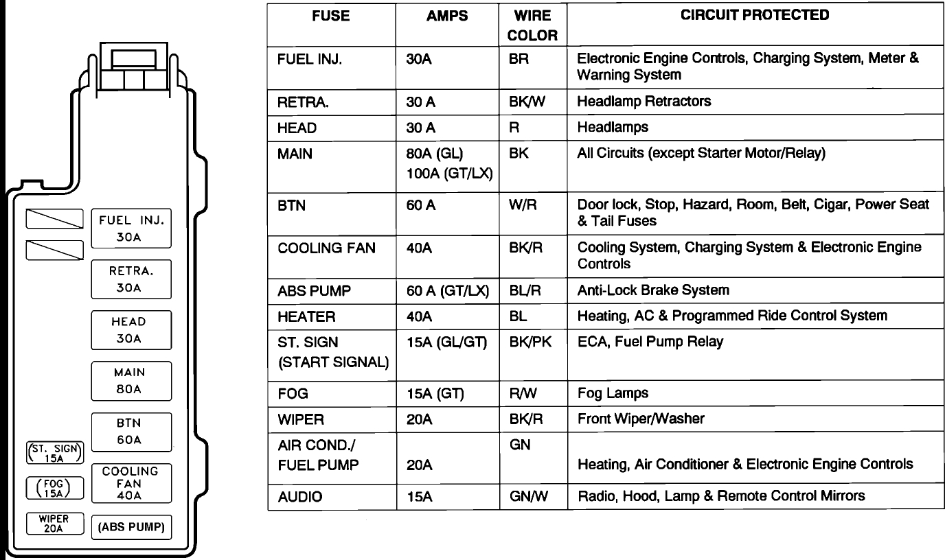

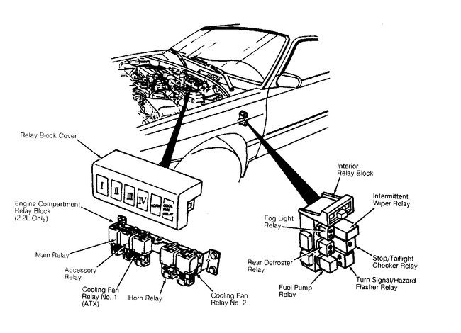

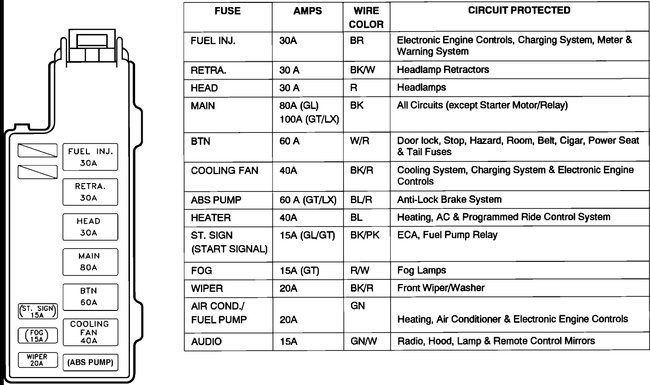

Fuel pump relay location needed
166,000 MILES • 3.0L • 6 CYL • 2WD • AUTOMATIC
TOMMY WOODARD
Where is the relay?
May 15, 2018 at 12:48 PM
HARRY P
  • 2,292 POSTS
Attached are the images that Ford has provided. It is in the interior fuse block. If you have an owner's manual, it might give more clear information. Let us know if this information helps you solve your problem. We are happy to help any time.
