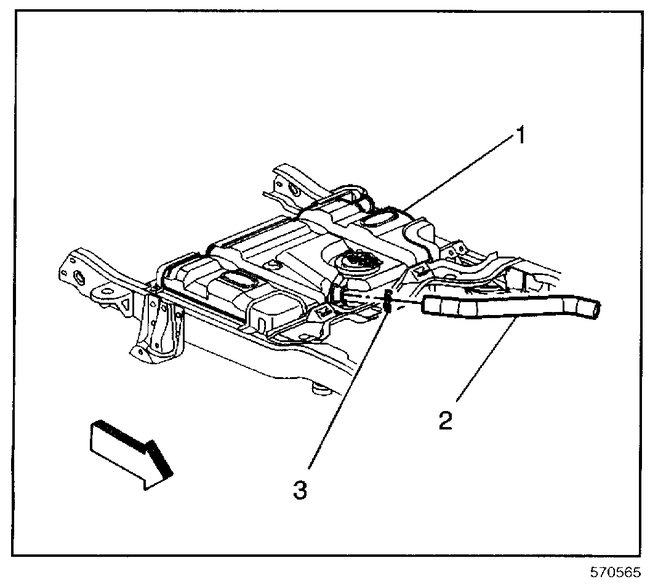

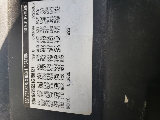

I'm trying to find out what fuel pump I need but when checking multiple parts sites and stores in my town there are multiple ones that say they fit but they say for module code TDF or TDD or TDA and I have no idea. How would I find out which module code I need? For the SUV listed above 2500 only has one gas tank. VIN 3gngk26g51g156127. also added picture of service parts identification sticker in glove box. It shows eva so that should mean I need the pump with the evaporative control system, but after that I am lost. Any help would be greatly appreciated as I need to get this vehicle fixed ASAP for work.

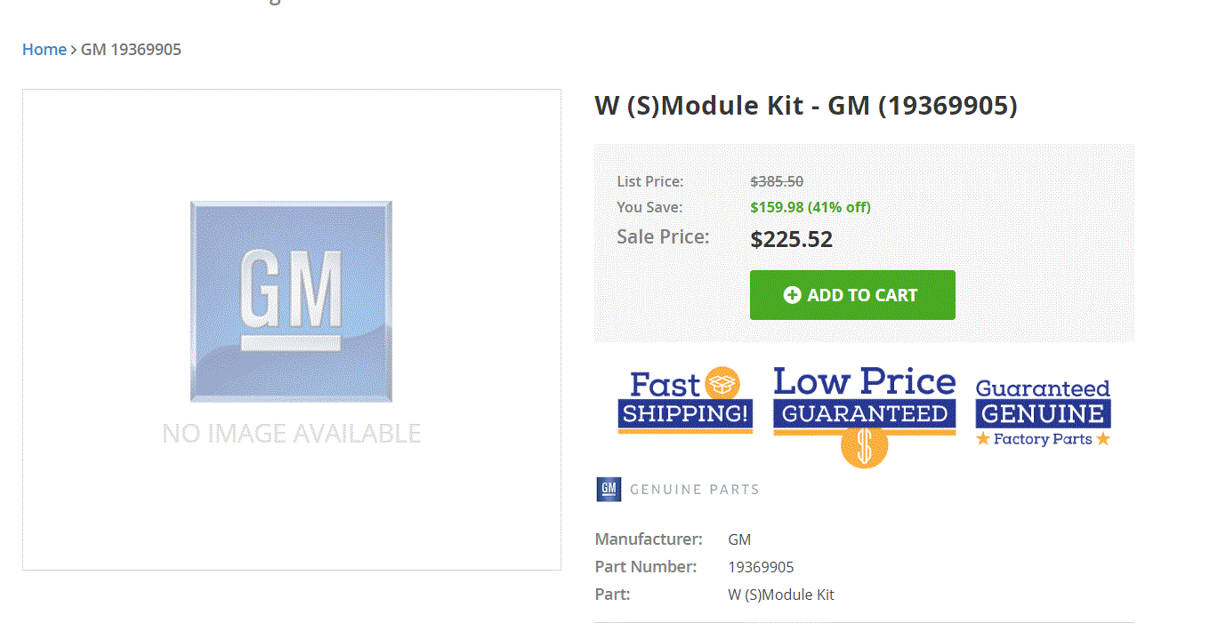

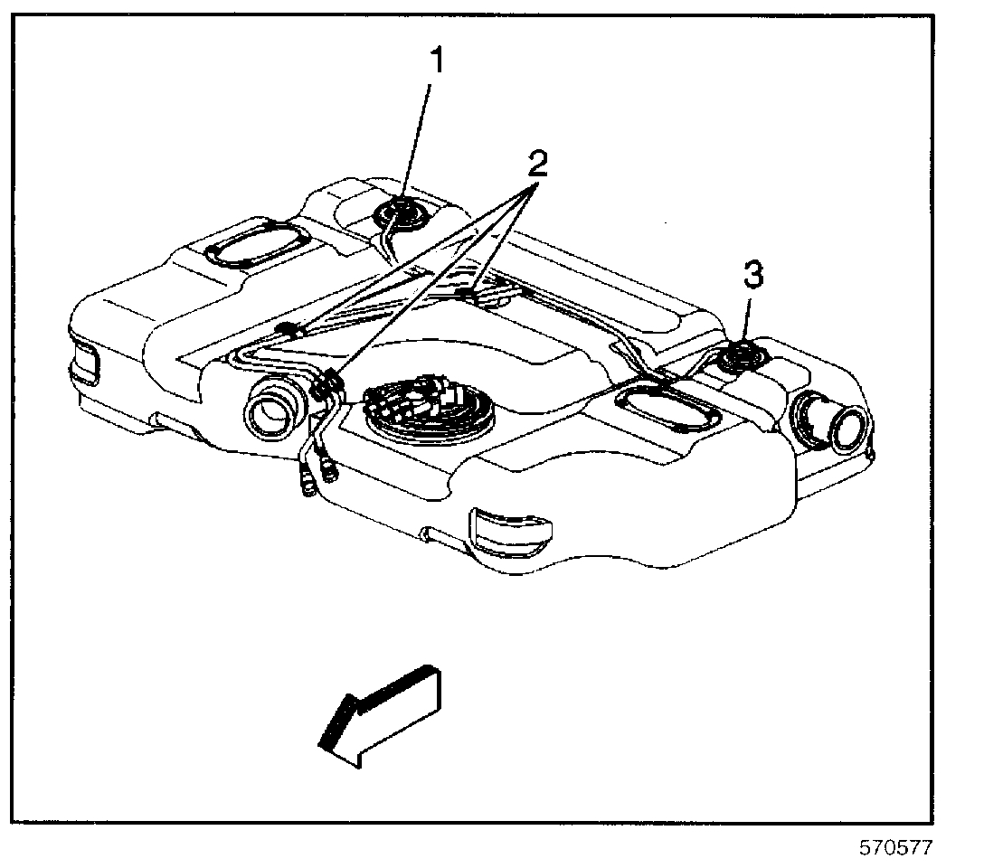

The original GM part number is 19369905 which indicates a (S module). Now, as far as the TDD, TDA, or TDF identification, the only way to confirm is by removing the original pump. One of the three acronyms will be stamped on the module assembly.
I don't know if you need them, but here are the directions for pump replacement and tank removal. All attached pictures correlate with the directions.

pic 1

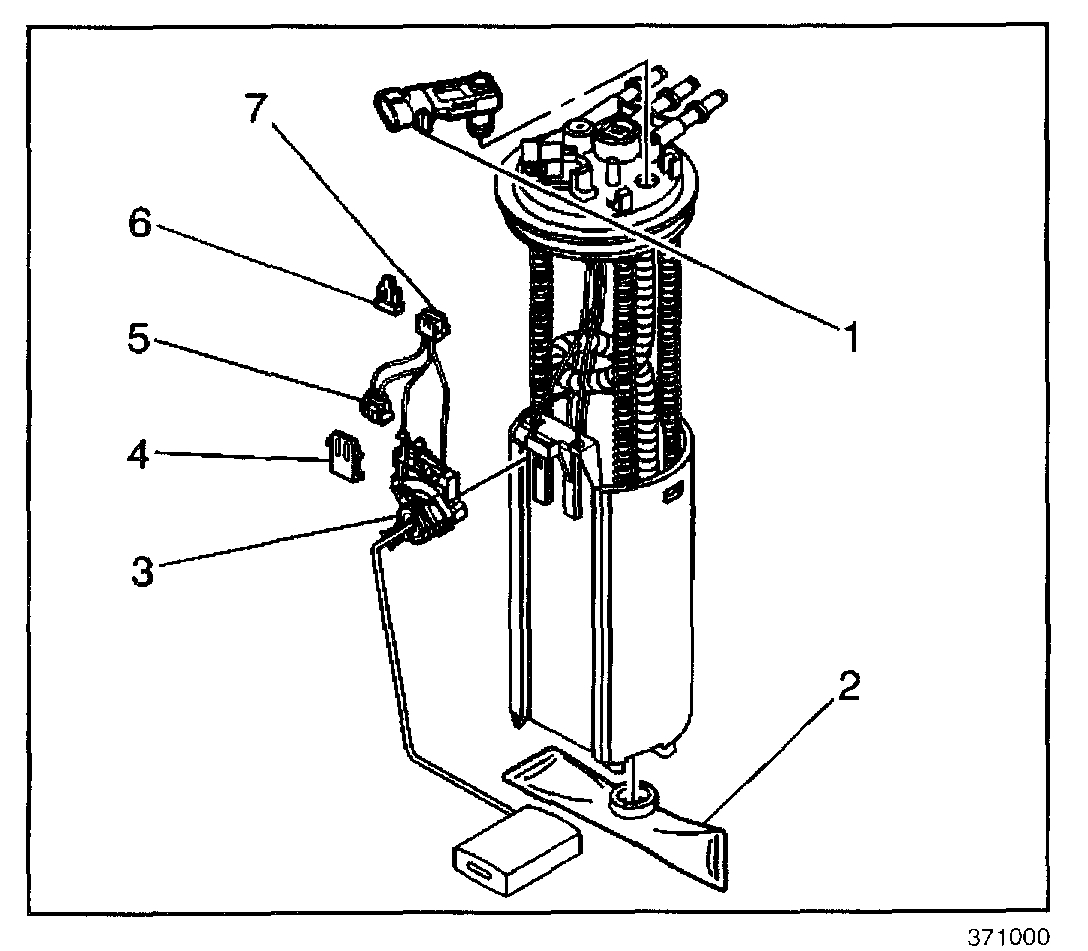

1. Remove the fuel sender assembly.
2. Note the position of the fuel strainer (2) on the fuel sender.
3. Support the fuel sender assembly with one hand and grasp the strainer (2) with the other hand.
4. Pull the strainer off the fuel sender. Discard the strainer after inspection.
5. Inspect the strainer.
6. If the fuel pump strainer is contaminated, clean the fuel tank. Refer to Fuel System Cleaning.

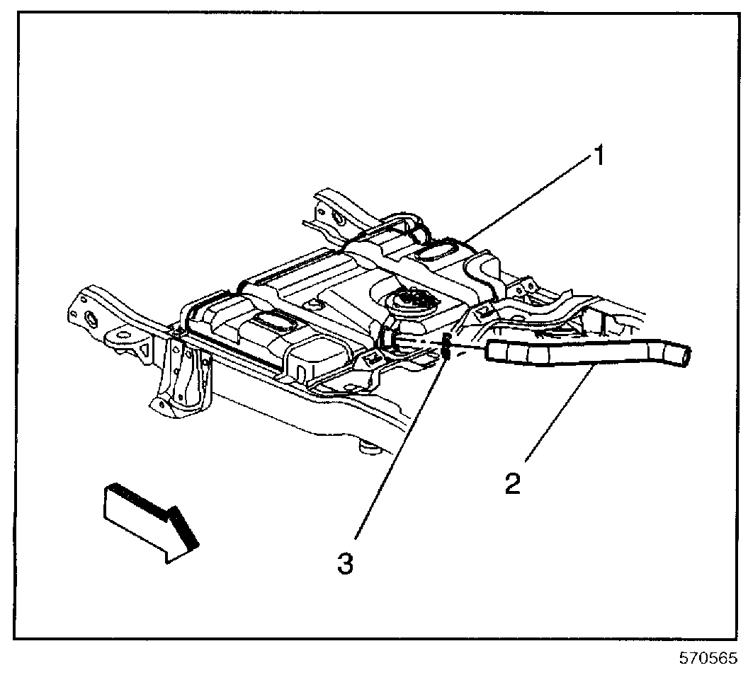

7. Disconnect the fuel pump electrical connector (5).
8. Remove the fuel level sensor (3).
9. Remove the fuel pressure sensor (1).

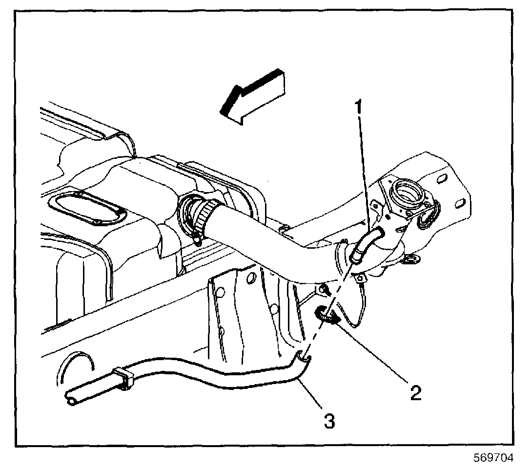

INSTALLATION PROCEDURE

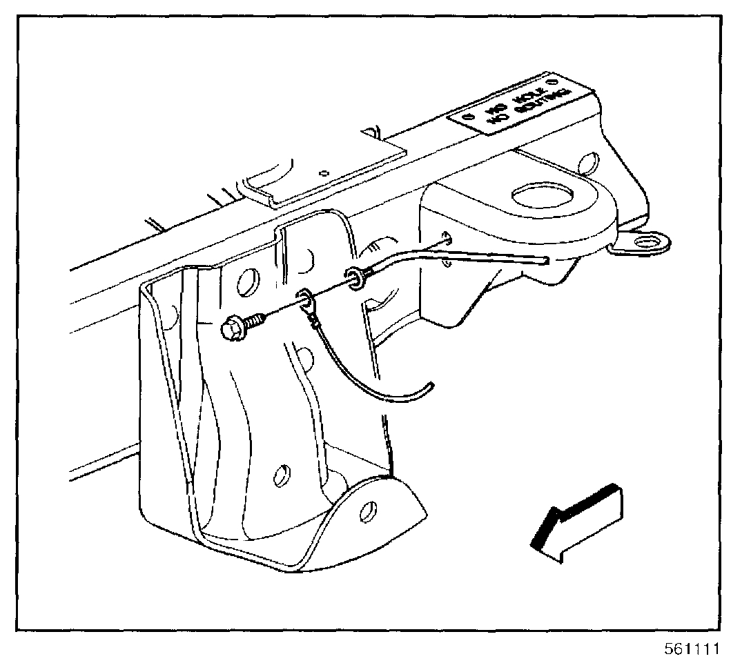

pic 2
1. Install the fuel pressure sensor (1).
2. Install the fuel level sensor (3).
IMPORTANT: Always install a new fuel strainer when replacing the fuel tank fuel pump module.
3. Install a new fuel strainer (2) in the same position as noted during disassembly. Push the strainer on the bottom of the fuel sender until the strainer is fully seated.
4. Install the fuel sender assembly.

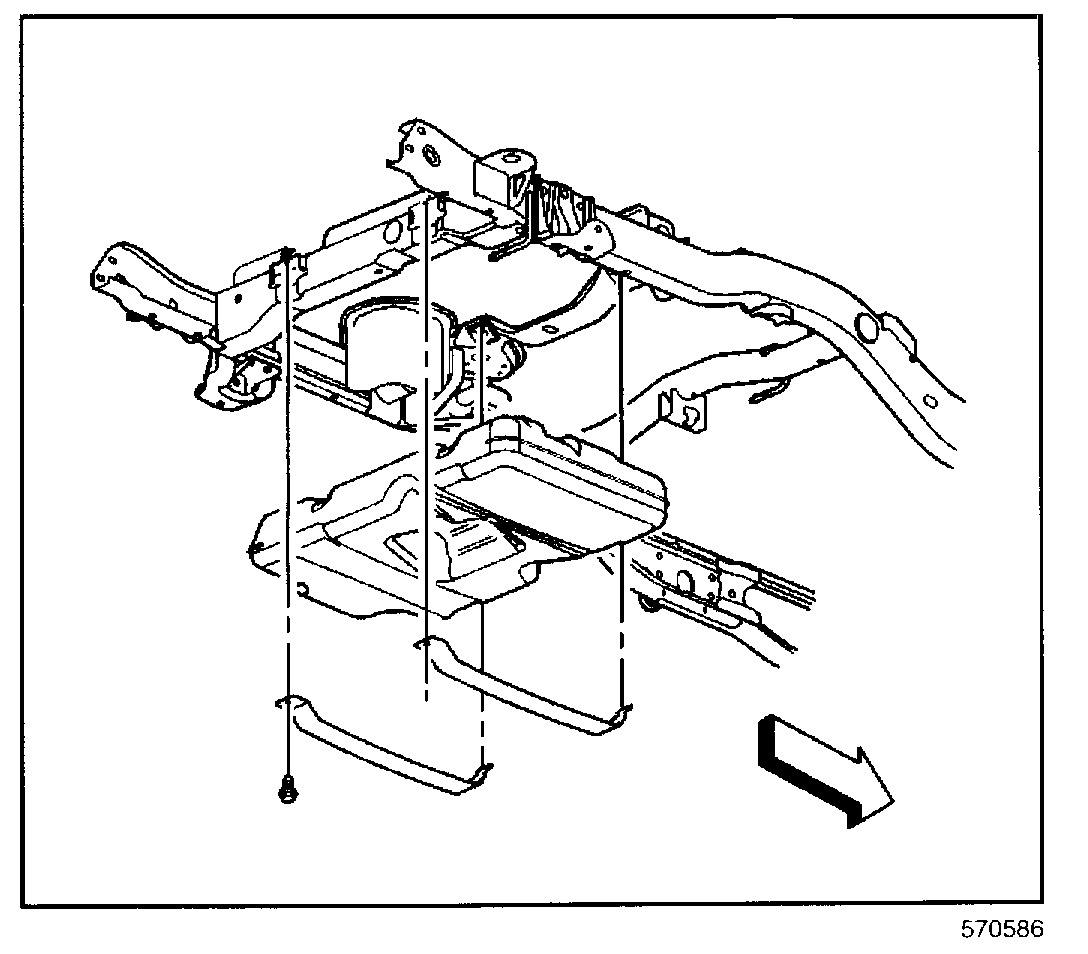

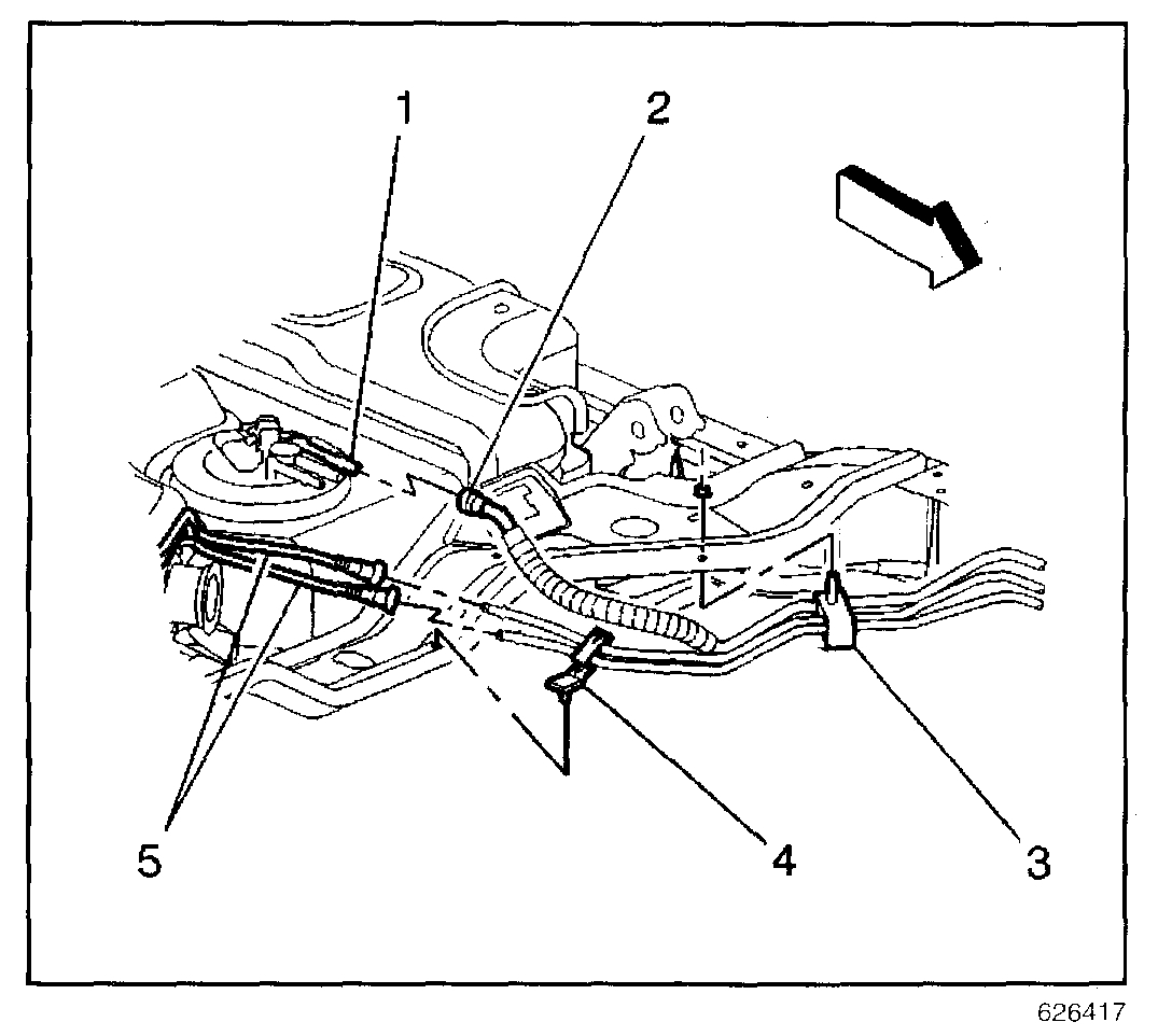

pic 3

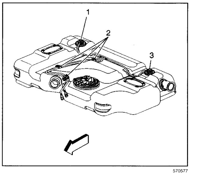

1. Relieve the fuel system pressure. Refer to the Fuel Pressure Relief Procedure.
2. Lower and remove the under chassis mounted spare tire.
3. Raise the vehicle. Refer to Lifting and Jacking the Vehicle .
4. Remove the rear cross-member that holds the spare tire.
5. Drain the fuel tank. Refer to Fuel Tank Draining Procedure (Cab/Chassis) or Fuel Tank Draining Procedure (Utility Front Tank) or Fuel Tank Draining Procedure (Utility Rear Tank).
6. Disconnect the rear chassis fuel pipe (2) at the fuel sender (1).
7. Disconnect the fuel sender electrical connectors.
8. Disconnect the evaporative emission (EVAP) pipes at the rear tank EVAP pipes (5).
9. Cap the fuel and EVAP pipes in order to prevent possible fuel system contamination.

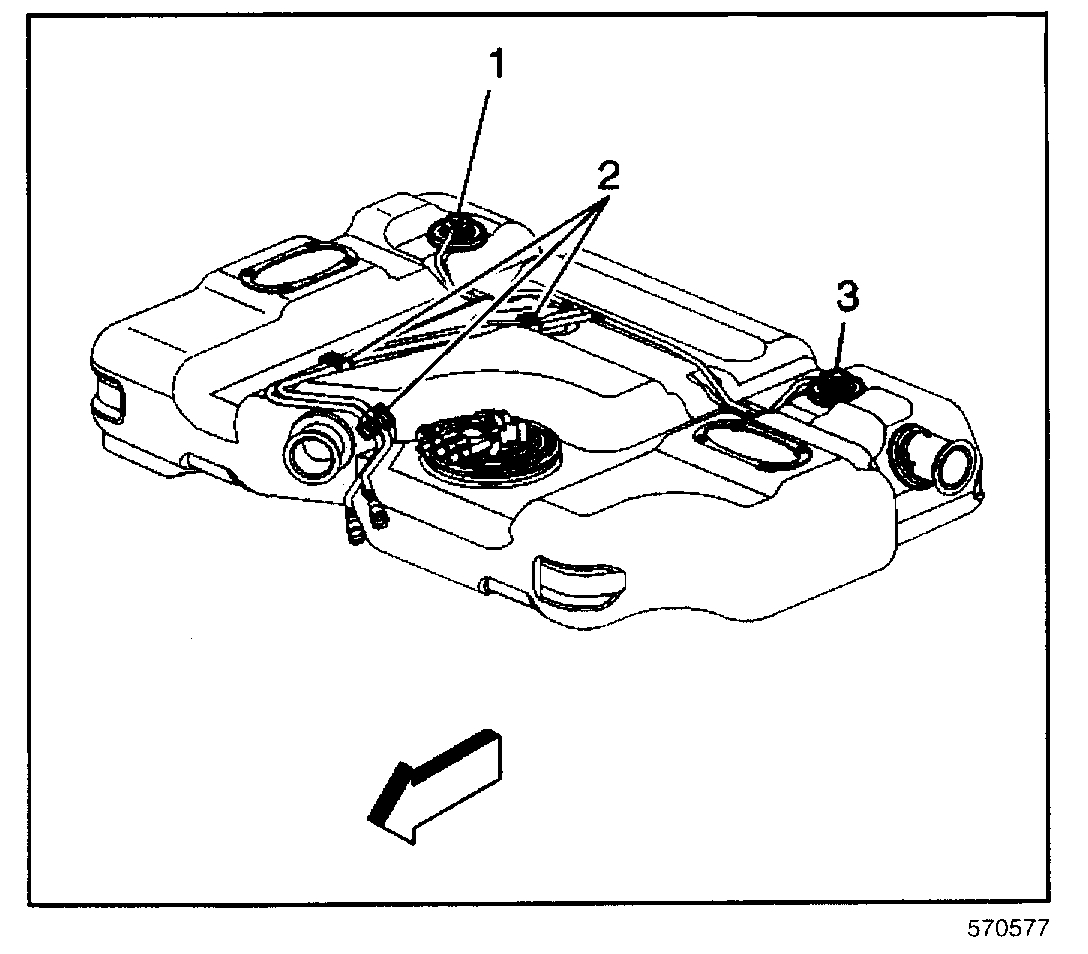

pic 4

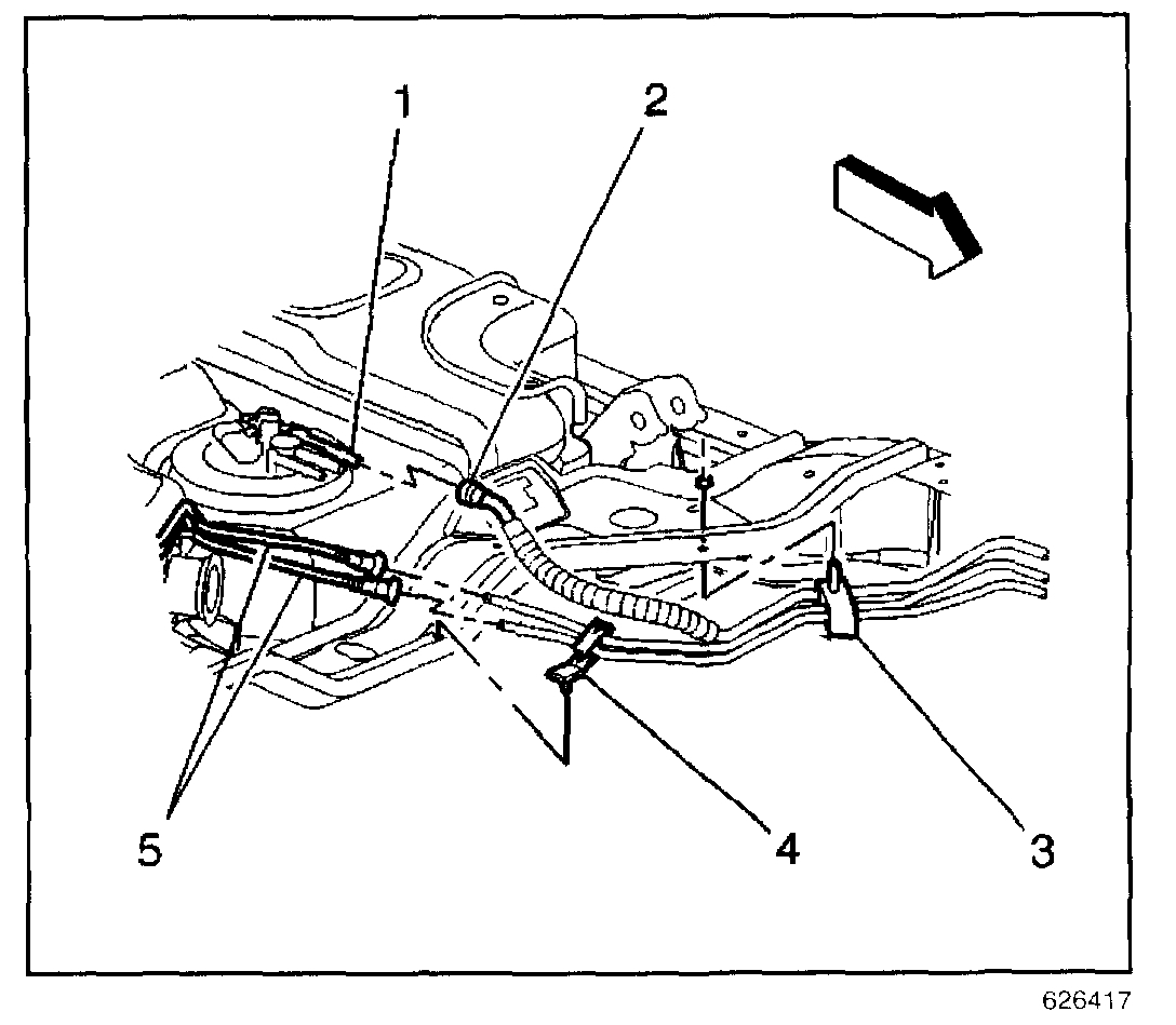

10. Disconnect the fuel fill pipe ground strap.

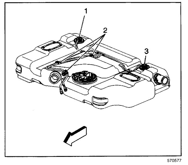

pic 5
11. Loosen the rear tank to front tank fuel till hose clamp (3).
12. Disconnect the fuel till hose (2) from the rear fuel tank.

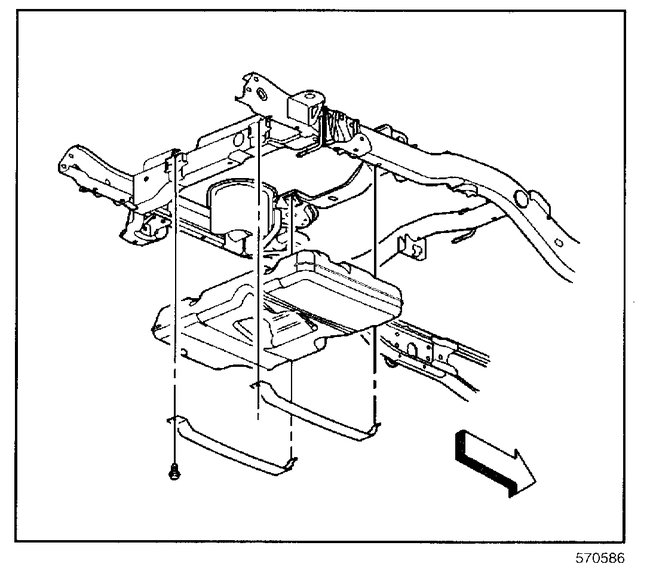

pic 6
13. With the aid of an assistant, support the fuel tank.
NOTE: Refer to Damage to Fuel Tank Straps Notice in Service Precautions.
14. Remove the fuel tank strap bolts.
15. Remove the fuel tank straps.
16. Remove the fuel tank.

Okay, that is what I found also. Do you know if they sell universal fuel pumps or is there any other way to find out? For example if I took it to the shop to complete the work they would have to totally remove the tank before being able to tell me if they even had the part in stock, which seems like a loss of time for them to have to do that and leave the vehicle there taking up space. When searching the Gm part number you provided I can't find a match but it pulls up this part number on GM 19331256 and 19153718, when searching the number you provided so maybe that is now the replacement for it? When checking Gm with that part number and other sites it doesn't say the TDF or TDD or TDA which leads me to believe maybe it is universal and doesn't matter? Do you know if that is the case? Searching either of those numbers it appears they look the same with 1 electrical connect and 3 hose connectors. It doesn't say if it's eva either so I am assuming it must be universal but not sure?

Honestly, that is the only way I know it can be done. If you look at the picture below, you will see the part number is a GM module part number. GM parts direct and so on show it.
