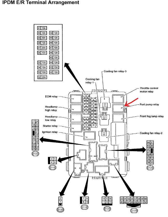

Need to locate the fuel pump relay.
May 24, 2025 at 7:20 AM
ICEBRAYKABLE
MEMBER
3 POSTS
My fuel pump not receiving the right amount of voltage 3.8. What the problem why I'm not getting 12v?
May 24, 2025 at 7:26 AM
ICEBRAYKABLE
MEMBER
3 POSTS
Where can I locate my fuel pump relay?
May 24, 2025 at 7:27 AM
Experienced Mechanic
55,711 POSTS
Sure, the fuel pump relay is inside into the IPDM. Here is the location. Check out the images (below). Let us know if you need anything else.
