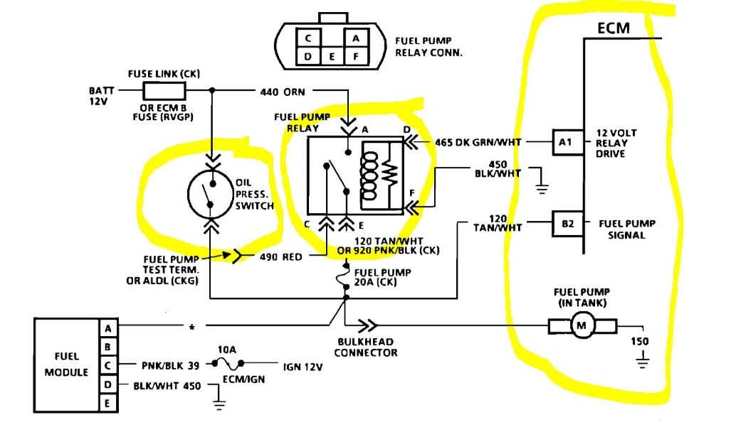

I can hear humming in the fuel tank. I started the truck and pulled forward then reversed it to rock the fuel and it turned off. What do I need to replace to solve this problem?

If you pull the relay, does the pump stop running?
It could be either the relay sticking, the oil pressure switch is bad or the ECM is not stopping the ground for the relay.
Try pulling the relay first.
