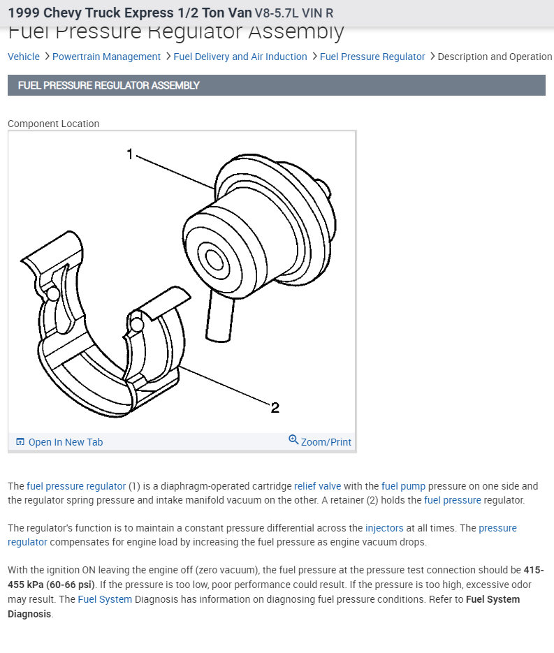

This vehicle should have 60-66 PSI of pressure with the key on and engine off.
What was the pressure reading?

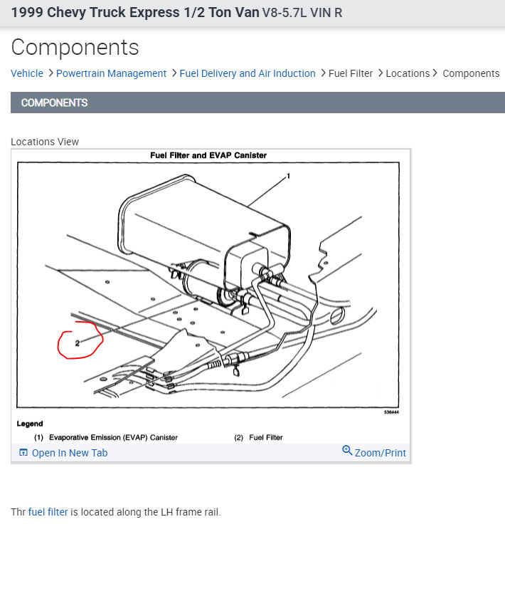

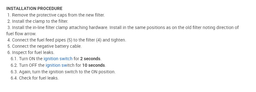

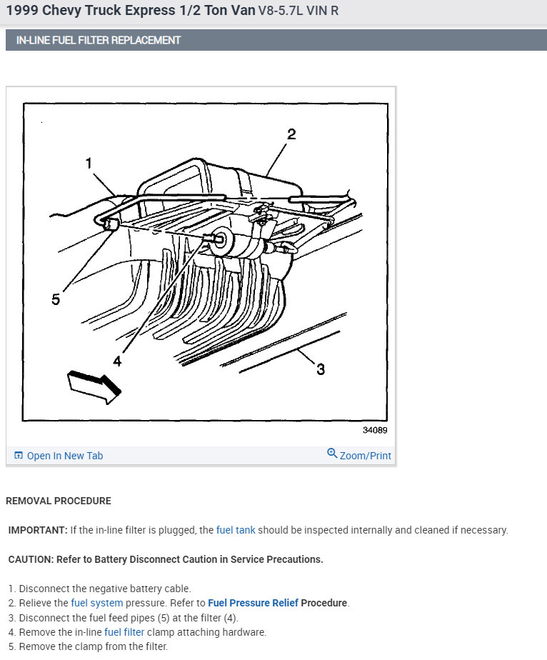

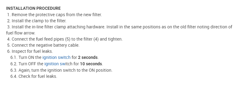

Also, you could have low pressure if there is a clog in the line. Or a dirty fuel filter.

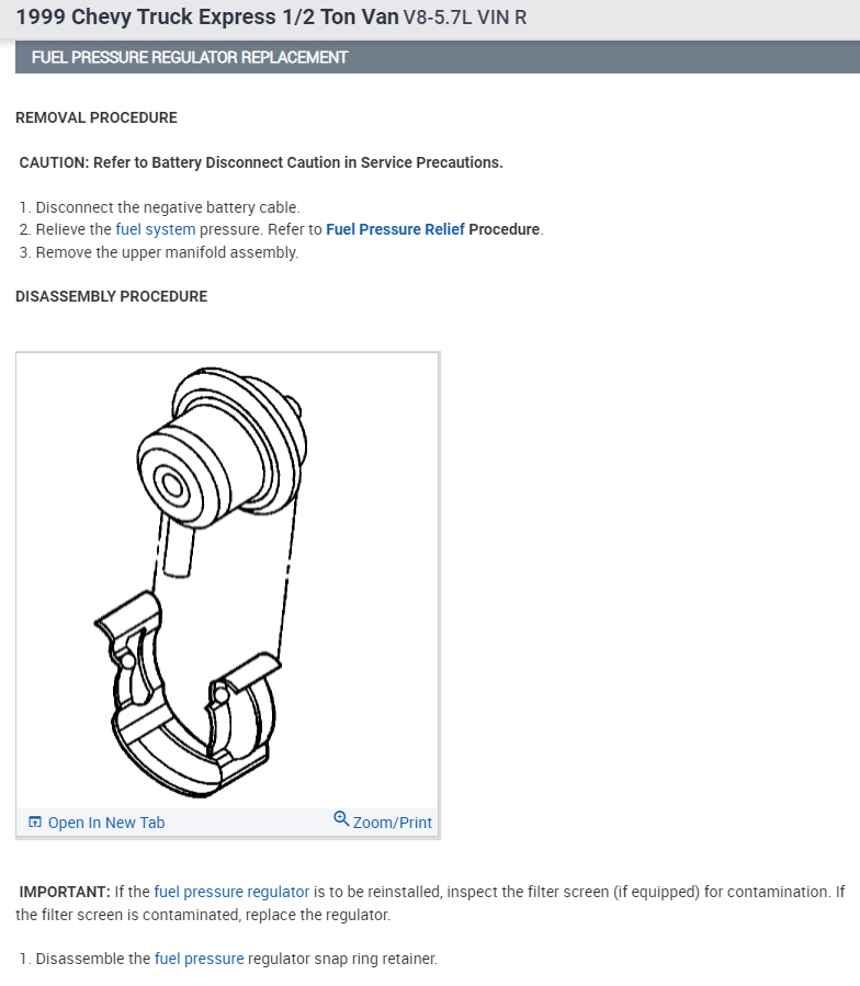

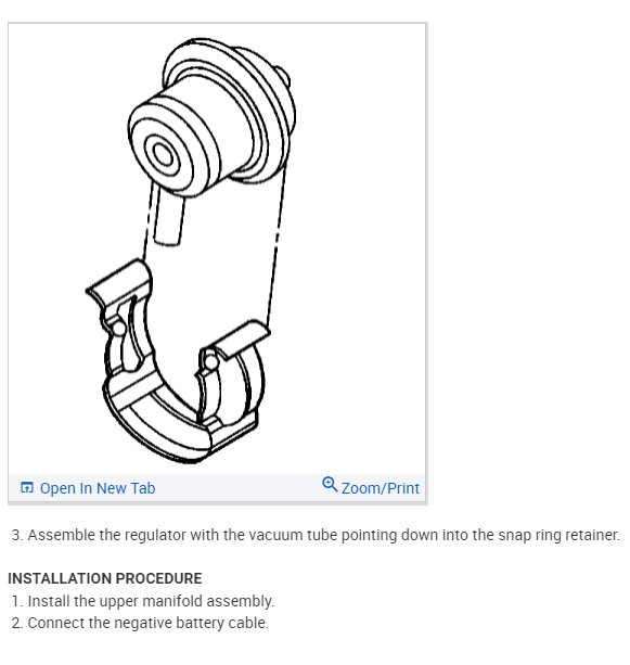

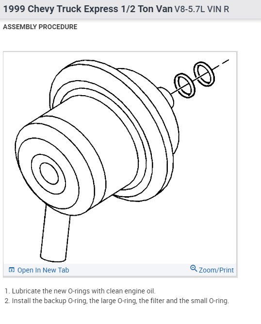

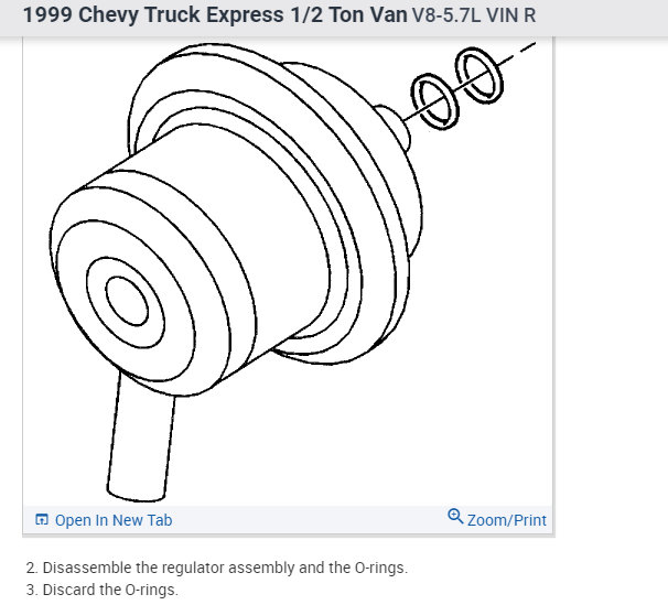

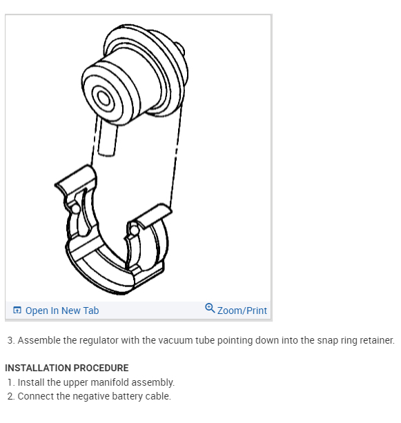

Another possibility is a bad fuel pressure regulator.
You probably want to check those items before dropping the tank for a fuel pump change.
https://www.2carpros.com/articles/how-to-change-a-fuel-filter

will do. checked fuel filter when took it off poured some gas through it and it seemed fine and what came out was clean. will add some gas and check regulator. thank you
