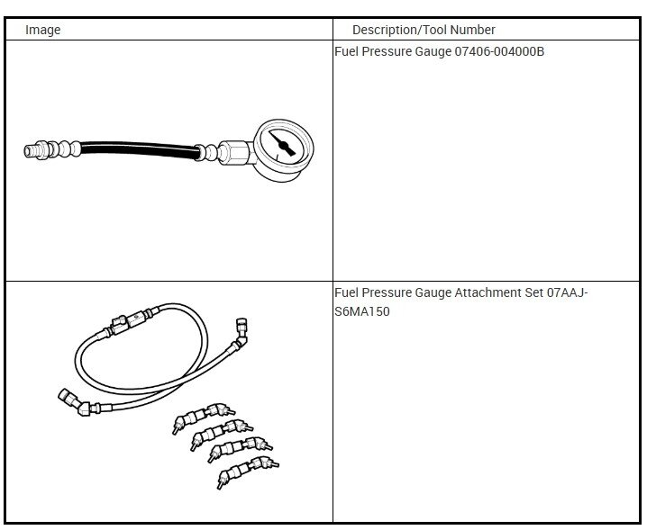

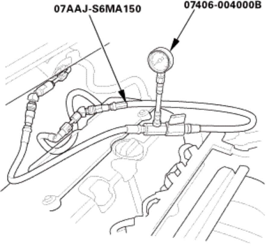

I have a 2014 Honda CRV, and I am trying to do a fuel pressure test, and I am unsure where to put the fuel pressure gauge. I have looked at photos and videos,but none of them show the same as what my car looks like and I can't find where it goes.

To test the pressure on that engine you need an adapter line that goes into the fuel line. You disconnect the quick connector on the firewall line where the flex line connects and goes to the fuel rail feed. Then you can test the pressure. Then you remove the adapter once the tests are done.
