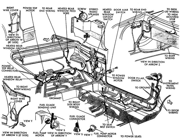

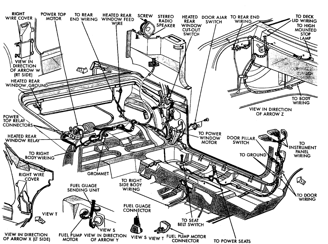

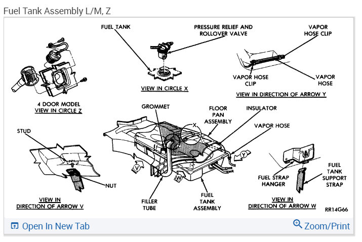

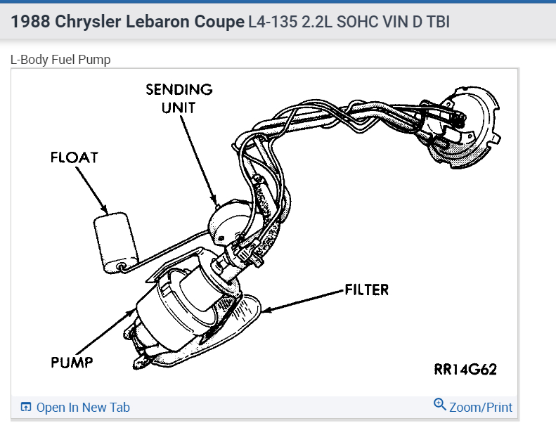

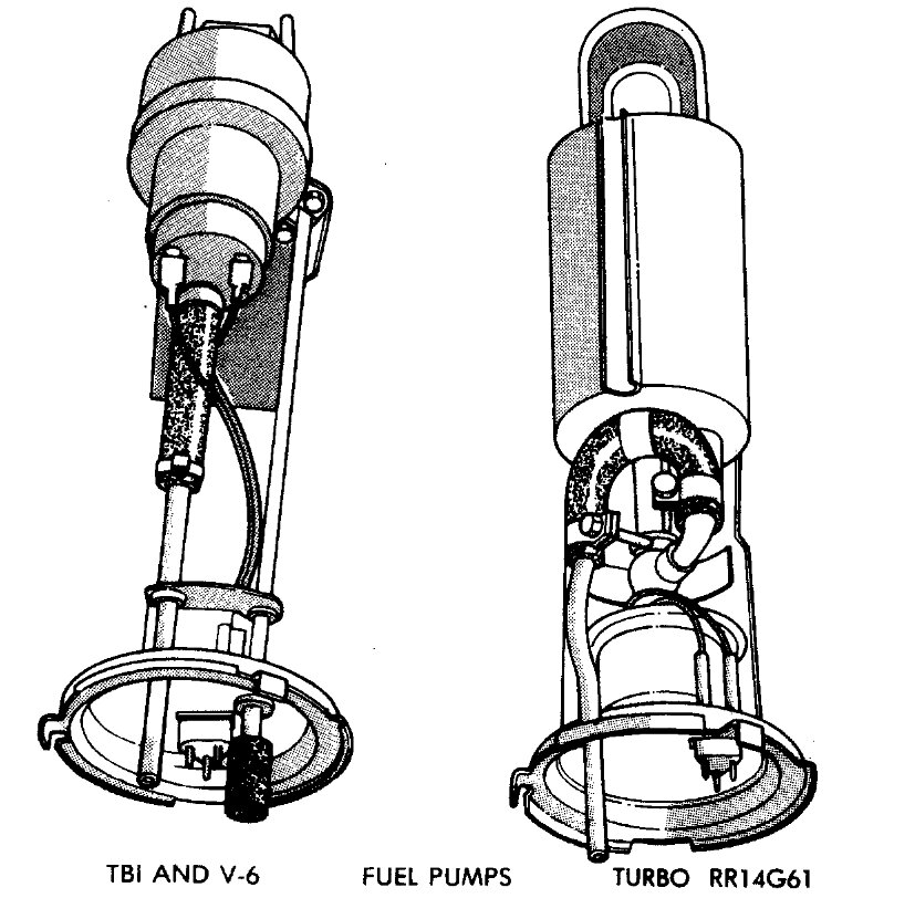

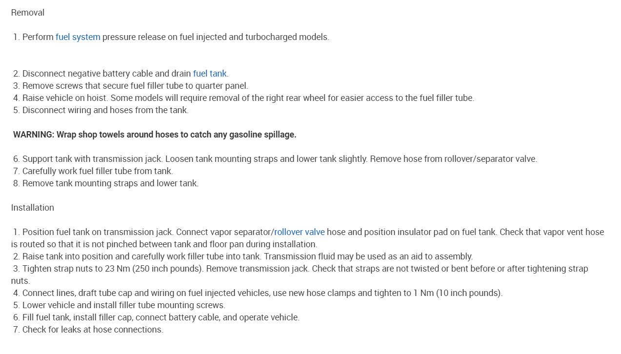

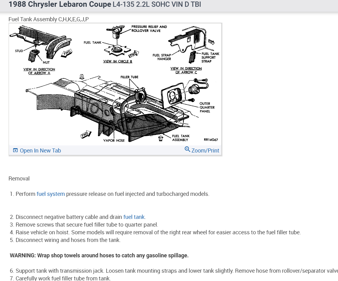

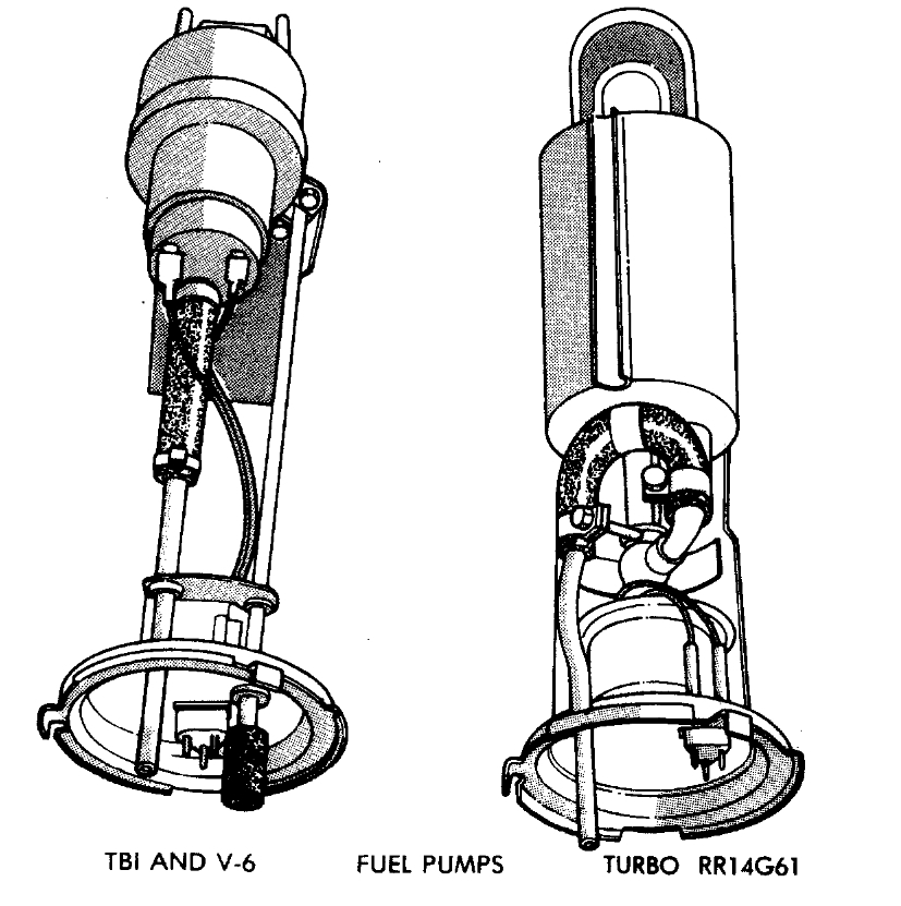

Ran great parked 2 years, now I can't hear fuel pump when key on. Where is the pump located so I can check it?
Jun 27, 2023 at 6:35 PM
  • 55,423 POSTS

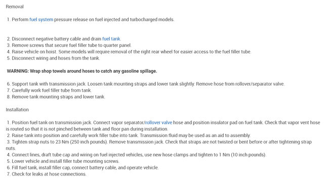

The fuel pump is in the fuel tank here is how to change the unit out. Check out the images (below). Please let us know if you need anything else to get the problem fixed.
