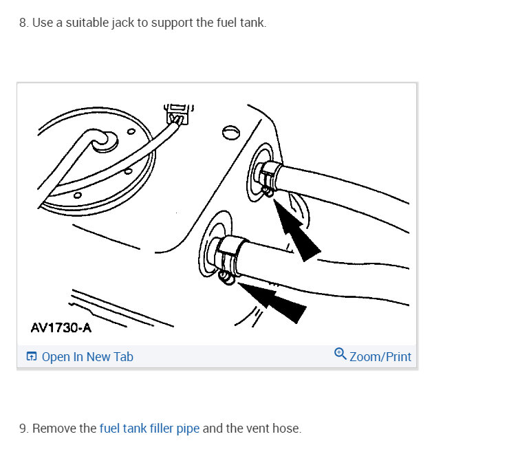

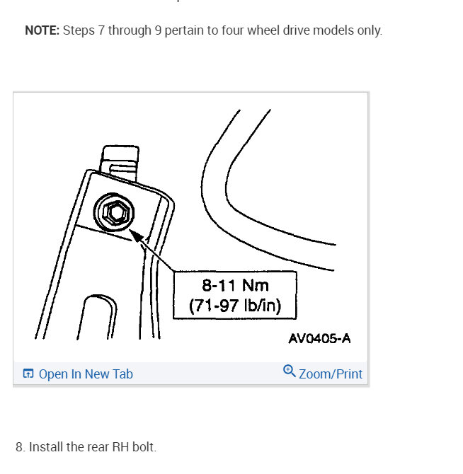

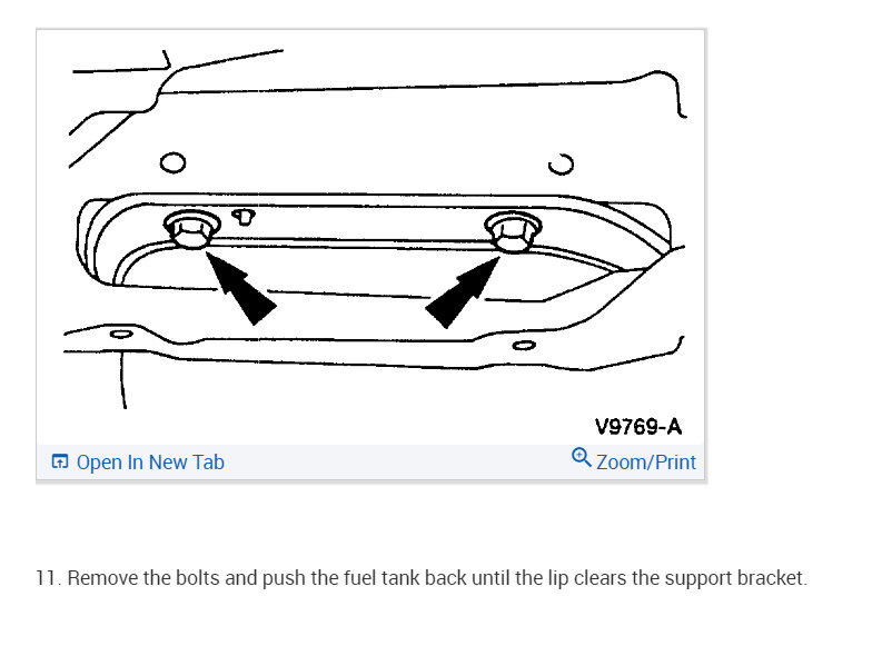

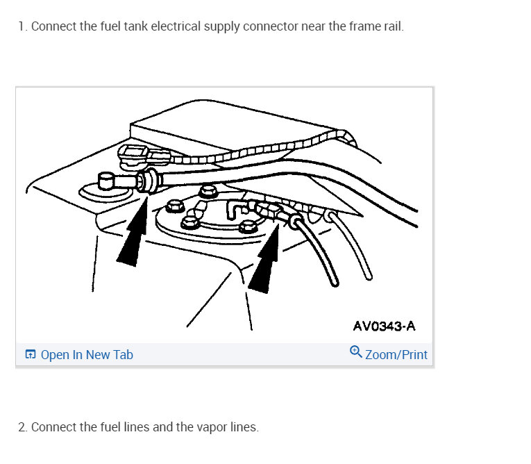

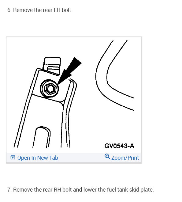

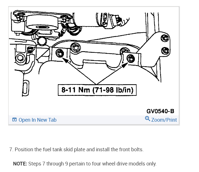

Is there an access door for fuel pump?
1999 MERCURY MOUNTAINEER
97,875 MILES • V8 • 2WD
COTY SAYLOR

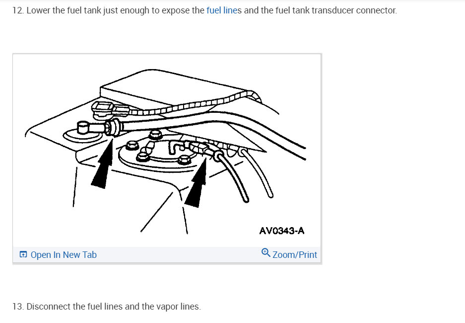

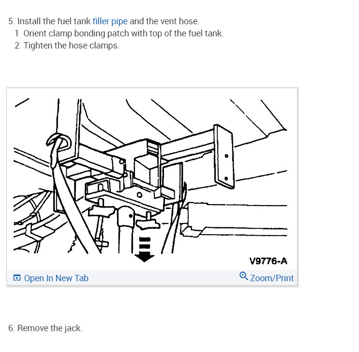

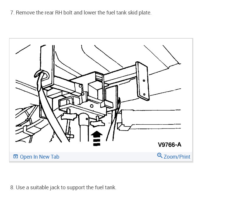

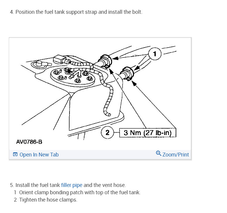

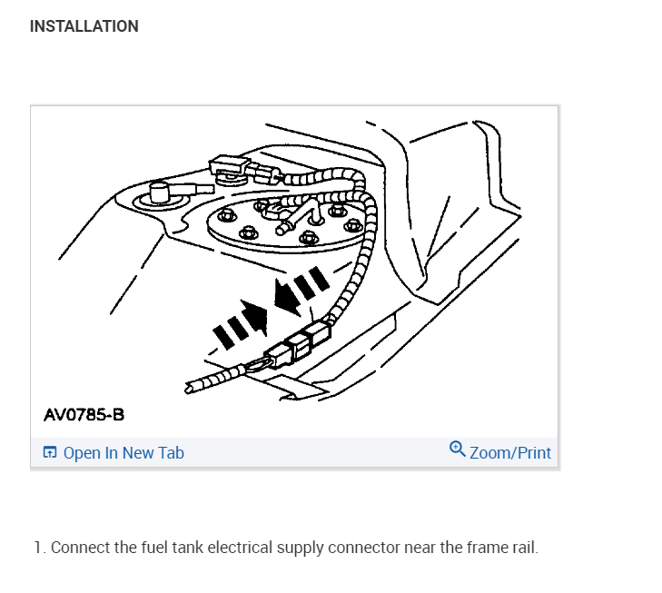

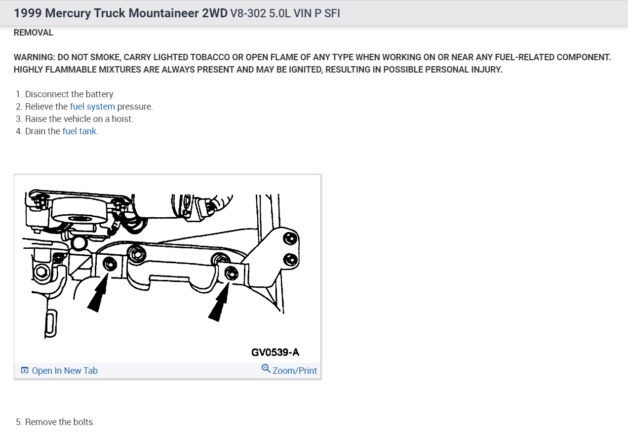

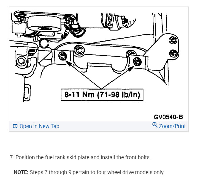

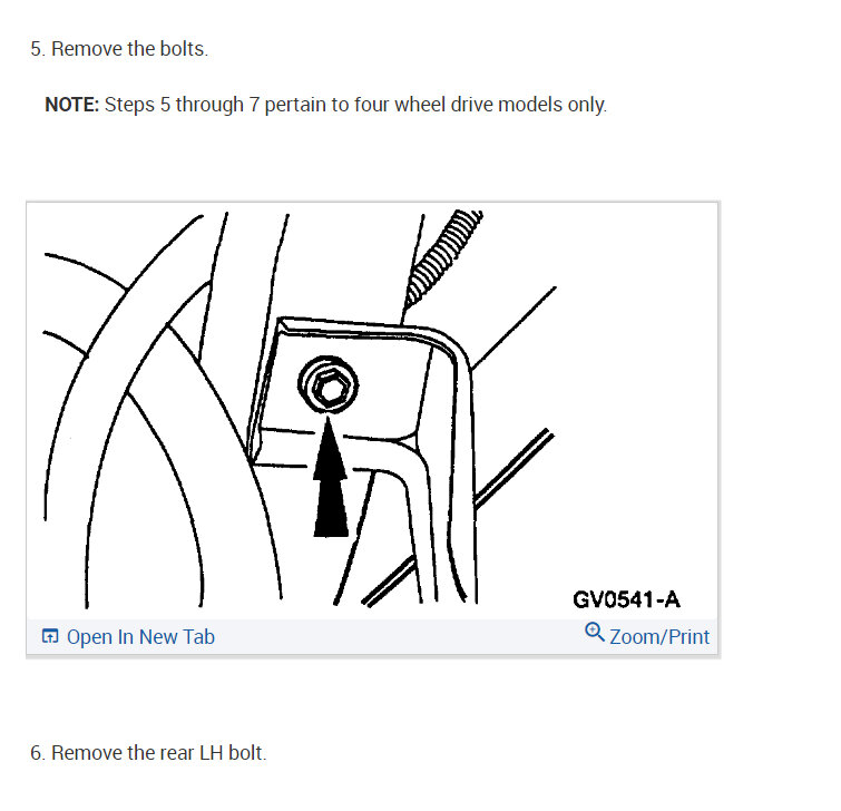

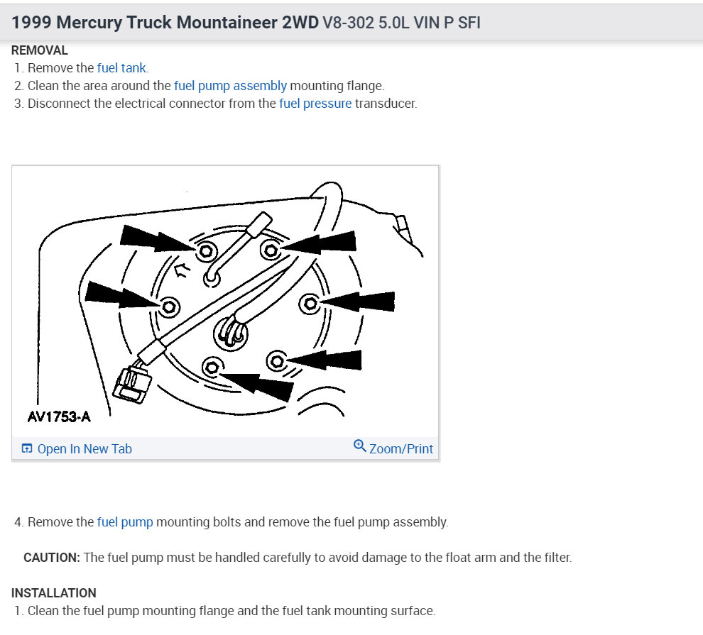

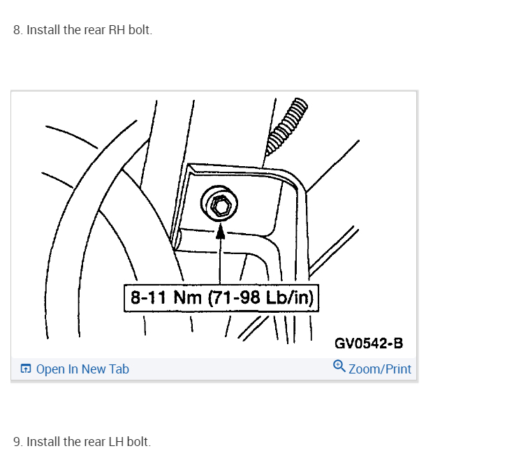

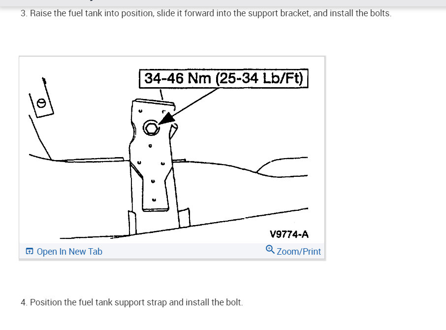

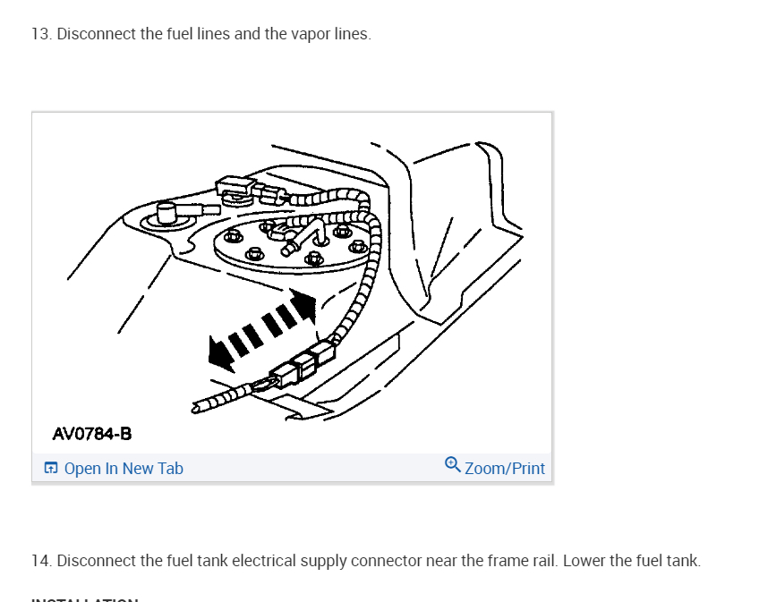

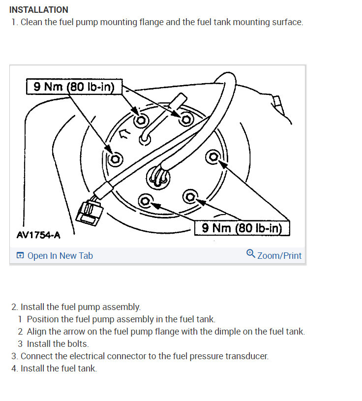

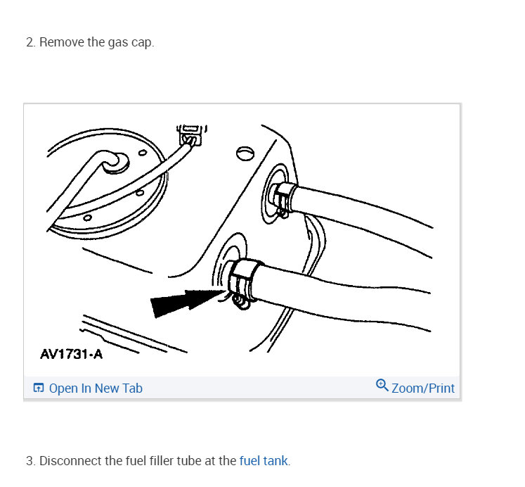

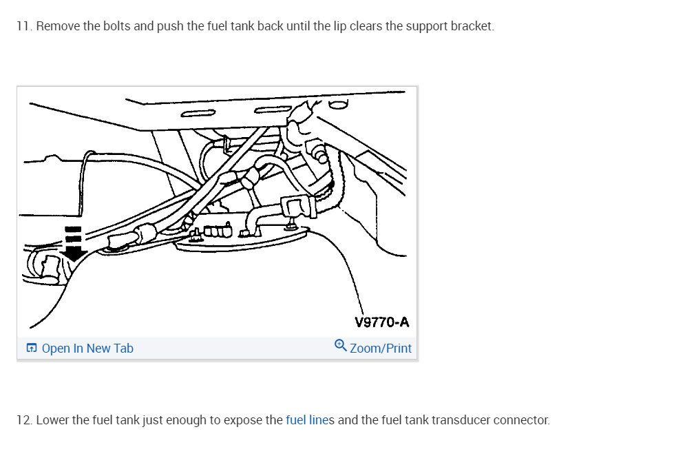

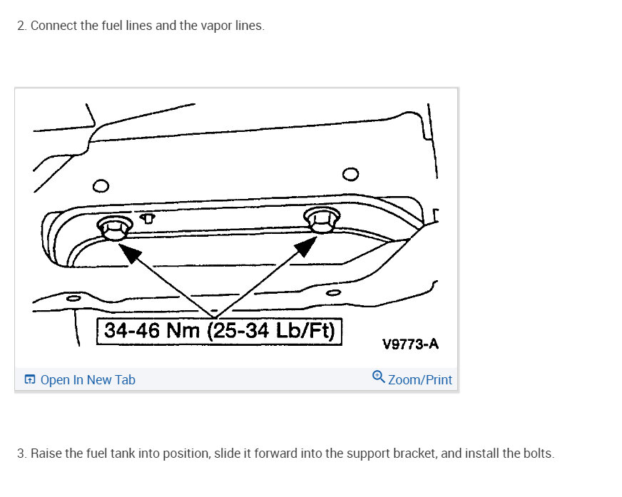

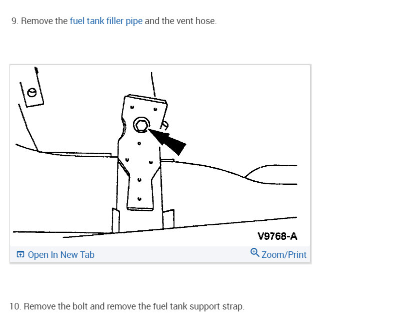

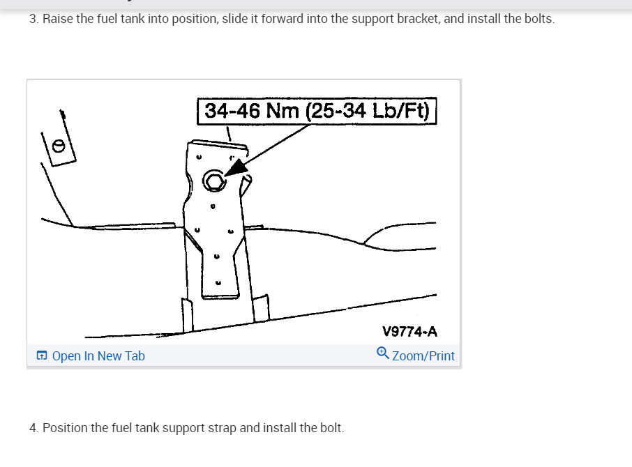

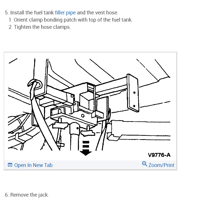

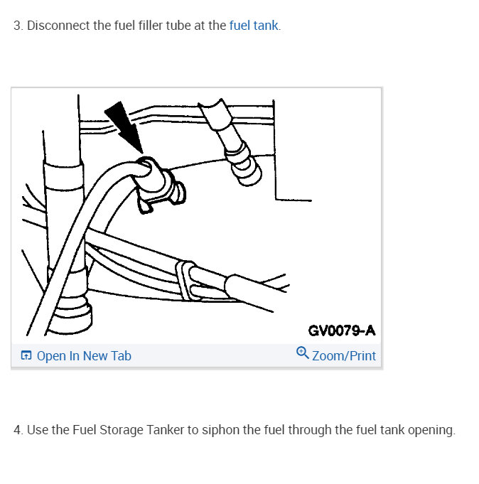

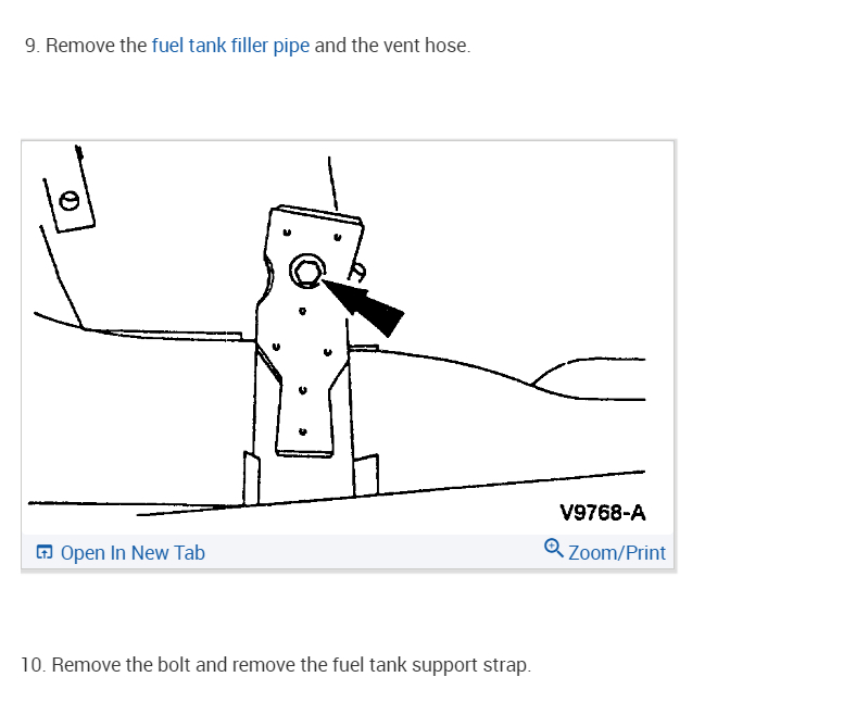

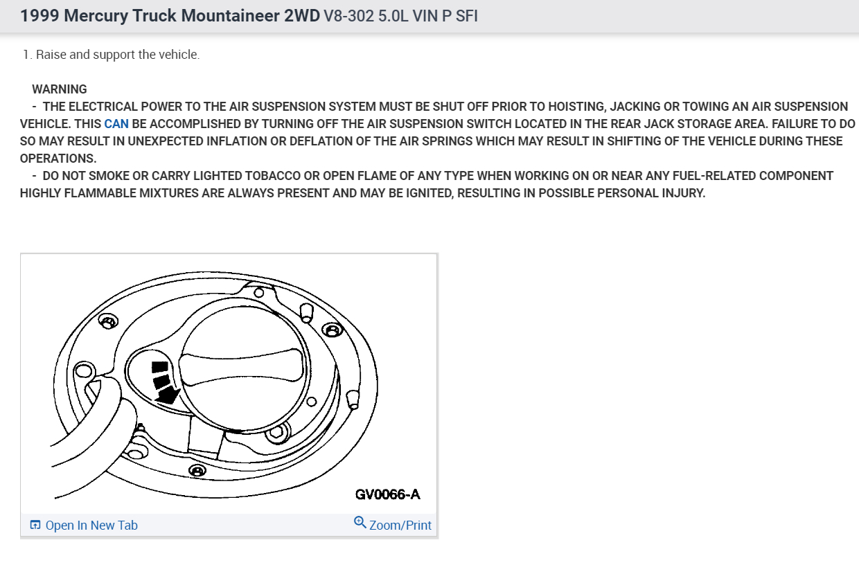

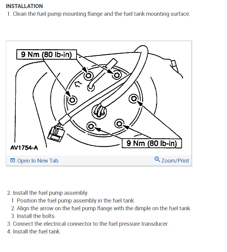

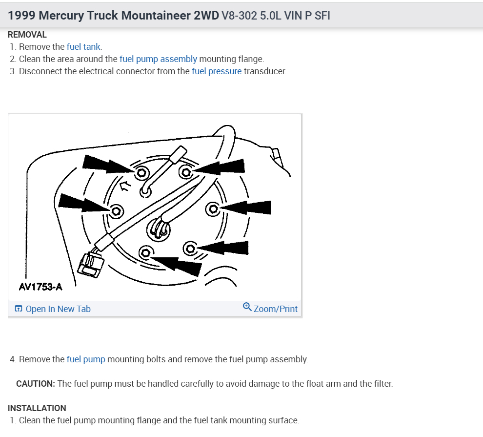

Is there an access door for fuel pump or will gas tank have to be removed to get to the fuel pump?
Jan 19, 2023 at 9:34 PM
  • 55,256 POSTS
There is no access door, here are the instructions on how to remove the fuel pump in the images below. You must drain the fuel first. here is a video to show you how with instructions in the images below:
https://youtu.be/Q5MH2gnyFH0
Here are the instructions for draining and removing the tank with the fuel pump as well.
Check out the images (below). Please let us know if you need anything else to get the problem fixed.
