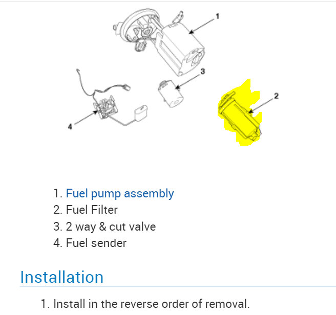

The fuel pump is clogged?
2016 HYUNDAI ELANTRA
129,000 MILES • 1.8L • 4 CYL • AUTOMATIC
BAIRDPOOL
I believe it is clogged and I am wondering if I can use dura lube Fuel system cleaner or if I need to replace the whole system.
Sep 16, 2023 at 9:05 AM
  • 110,241 POSTS

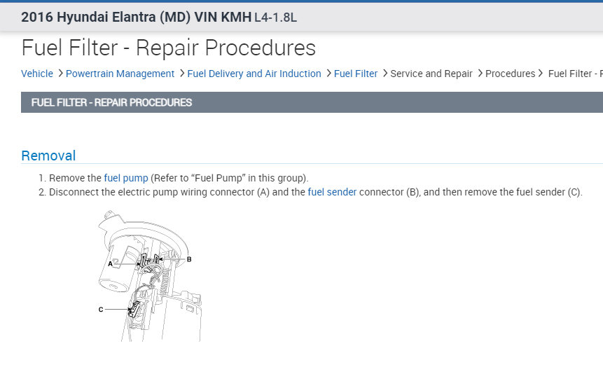

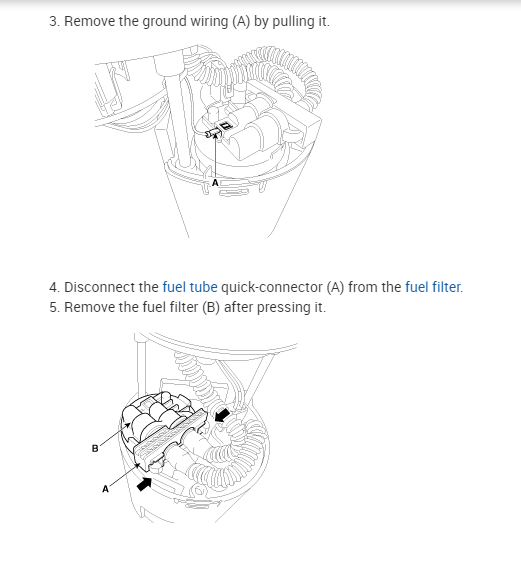

It is unlikely that the fuel pump is clogged. However, it is possible the filter is plugged. The filter is located in the fuel tank along with the pump. I attached directions below for replacing it.
