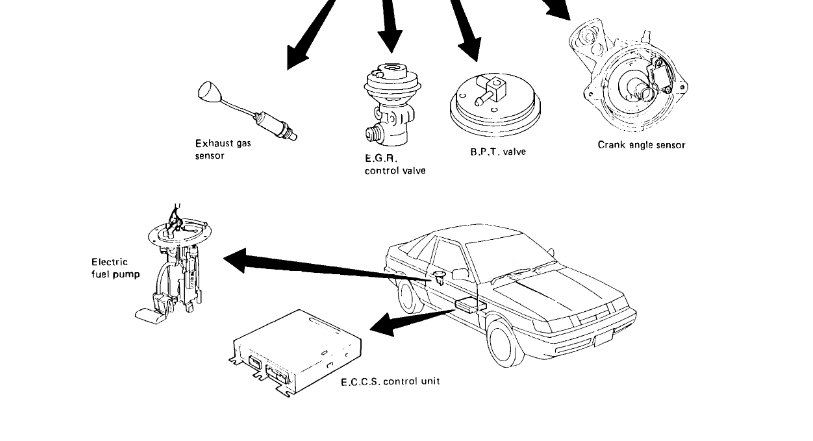

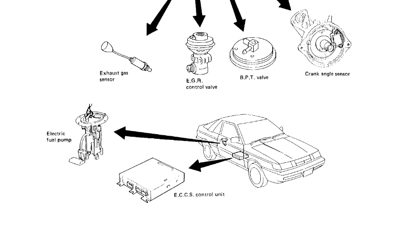

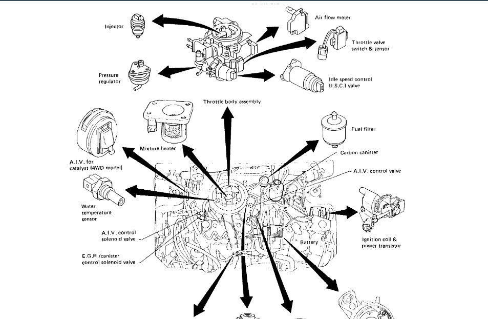

Is the fuel pump located under the back seat?

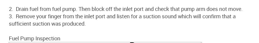

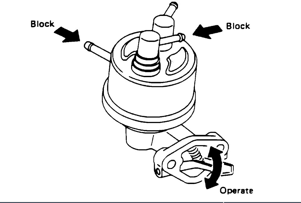

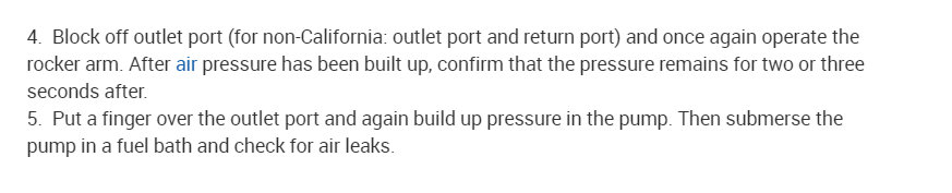

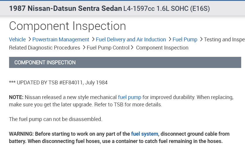

Yes it is. In the diagrams down below I have included the fuel pump location and the instructions for how to test it from the vehicle manufacturer. Please go through the guides and get back to us with what you are able to find out.

Here are a couple of guides for testing a fuel pump and replacing a fuel pump for you as well:
https://www.2carpros.com/articles/how-to-replace-an-electric-fuel-pump
Please go through these guides and let us know how everything turns out. I hope these help.

Is the fuel pump under the backseat?
Friday, November 8th, 2019 AT 2:57 PM
SCGRANTURISMO
  • 4,897 POSTS
Yes. It is on top of the fuel tank, and the back seat sits on top of the fuel tank.
