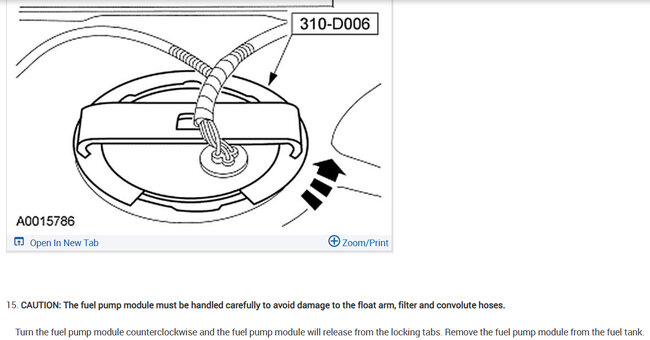

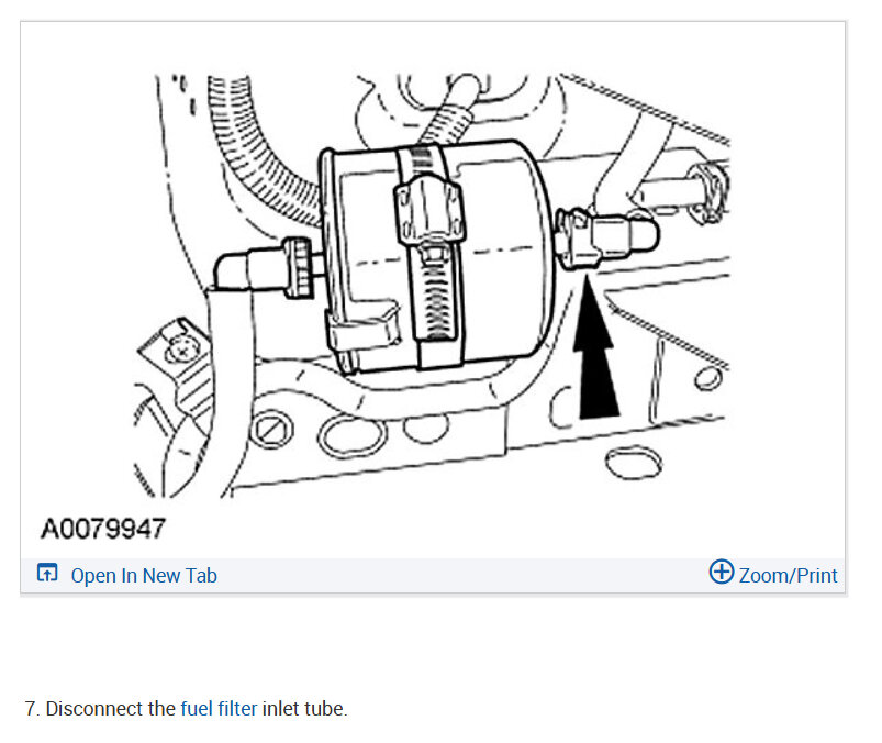

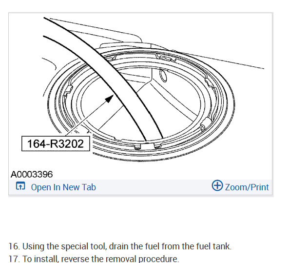

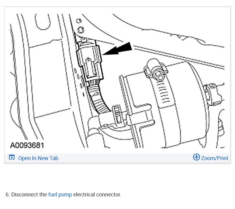

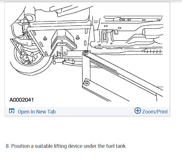

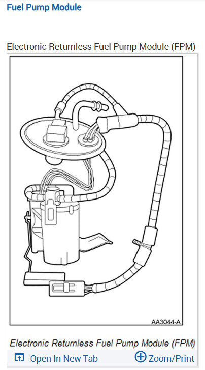

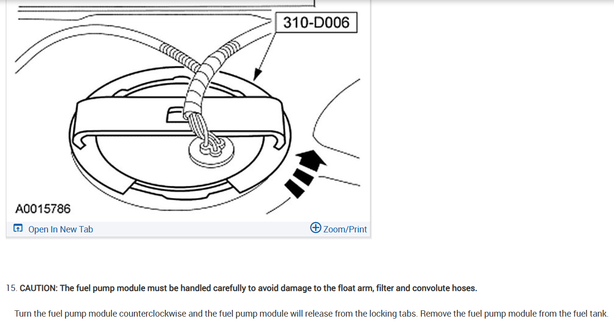

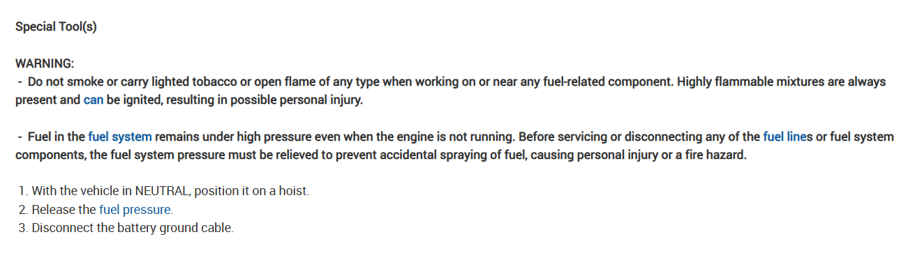

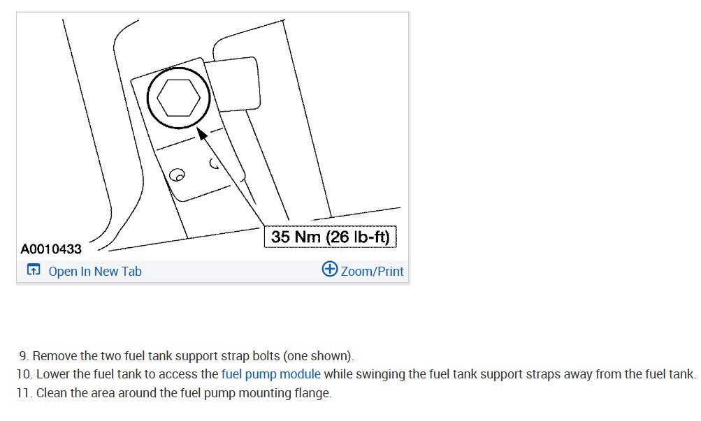

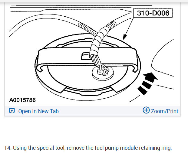

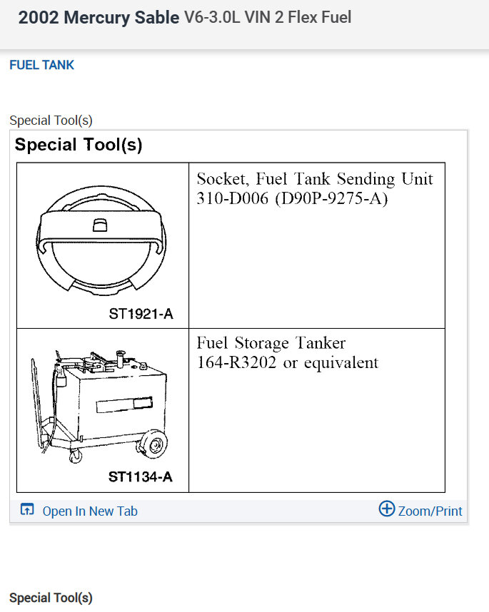

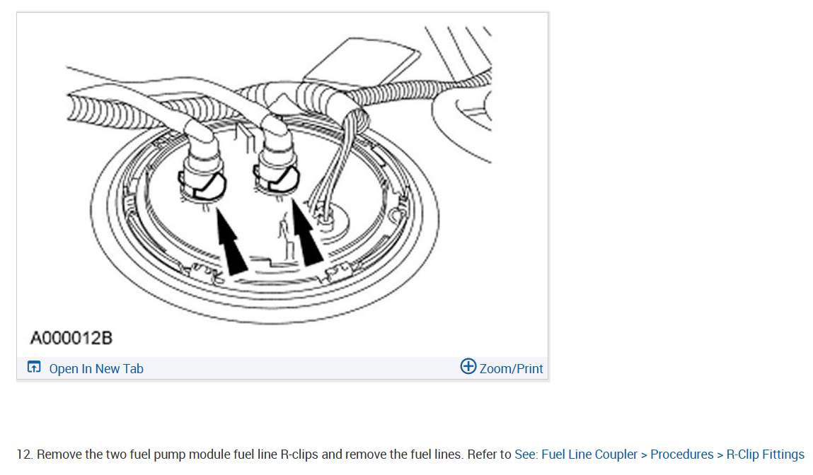

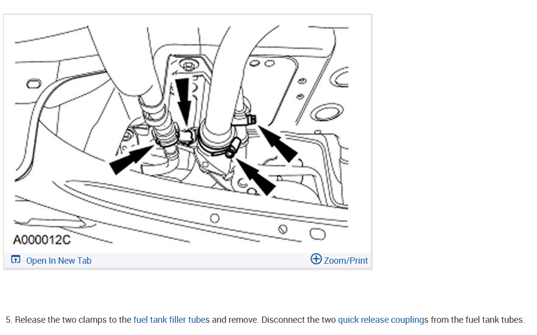

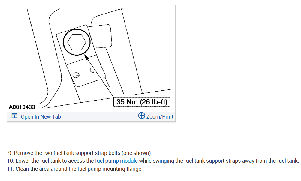

Do you have a video that will walk me through changing a fuel pump? I had hoped for a way to it under the back seat, no luck. So, I know I need to drop the gas tank, that's all I know about replacing the pump. I plan on putting a floor jack under the tank because I can't move it myself and the tank is full. I know for certain it is the fuel pump. I followed instructions you gave to test the pump, and it did exactly like on your video.
Jan 30, 2025 at 12:16 AM
  • 55,421 POSTS
Yes, we do have a video on a similar Ford car, the steps are the same, I would drain the fuel out though and put it in another car. The tank would be super heavy filled with gas which will be dangerous. Please go over this video to show you how:
https://www.youtube.com/watch?v=Q5MH2gnyFH0
and here is how to remove the fuel pump, with instructions below for your car:
https://www.youtube.com/watch?v=SOmd3BoE4YU
