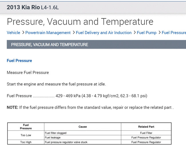

The idea that you hear the pump prime may not indicate it is working properly. Here is what we need to start with. We need to confirm the fuel pressure is present. Here is a link that explains how it is done:
I attached the fuel pressure specifications below.
Do this and let me know what you find. Also, if the fuse box appears to have corrosion, disconnect the negative battery terminal and get an electronics cleaner spray and do your best to clean the connectors.
Let me know what you find.

Because there is a concern with the fuel pump sounding differently, I would recommend checking if it is working correctly. That is what the fuel pressure test will indicate.

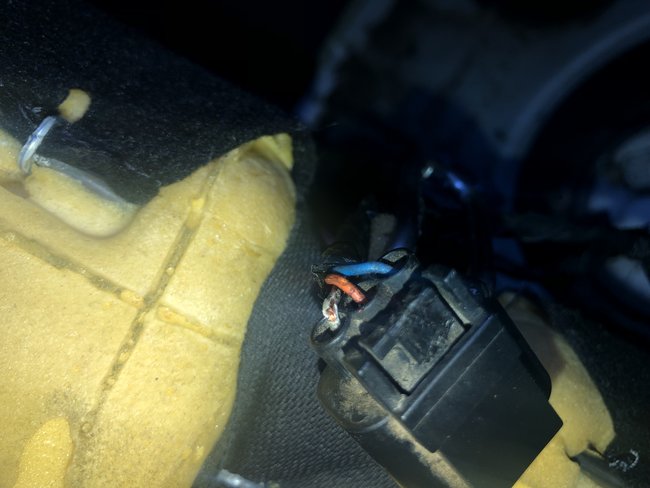

There is what appears to be a broken wire on the pump, or I can see the copper coming out of it.
Apr 18, 2022 at 7:41 AM
  • 110,251 POSTS
That is a concern. By chance, can you take a pic of it and upload it for me to, see? Also, let me know the wire color.
Apr 18, 2022 at 7:43 AM
FARR2007
  • 244 POSTS
Joe, the wire color is grey, and I will send a pic.
Apr 22, 2022 at 5:08 PM
  • 110,251 POSTS
That appears to be the issue. Some of these are repairable without replacing the connector. Others require a new plug to be wired in.
By chance, if you disconnect the connector, are there any small pins to release the pin that goes to that wire?
Apr 23, 2022 at 12:47 PM
FARR2007
  • 244 POSTS
I am not sure at the moment.
Apr 23, 2022 at 1:54 PM
FARR2007
  • 244 POSTS
Can I cut it and splice in tbe new one ?
Apr 23, 2022 at 2:03 PM
  • 110,251 POSTS
Yes, but make sure you solder the wires and heat shrink them to prevent them from coming apart.
