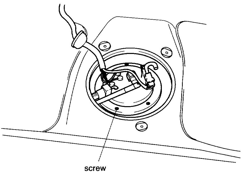

Where is the fuel pump located in my car listed above? Is it in the fuel tank?
Oct 15, 2019 at 5:03 PM
  • 110,194 POSTS
Welcome to 2CarPros.
It is in the fuel tank. The good news is that the tank doesn't need removed to replace the pump. There is an access port under the rear seat. Here are the directions for replacing the unit. The attached pics correlate with the directions.

1. Disconnect negative battery cable.
2. Remove rear seat cushion.
3. Disconnect fuel delivery module connector.
pic 1

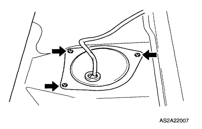

4. Remove three screws attaching access cover.
5. Remove rubber grommet and wires from access cover and remove access cover.
pic 2

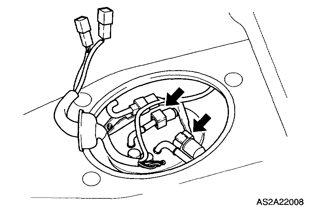

6. Disconnect two fuel hoses from fuel delivery module.
pic 3
