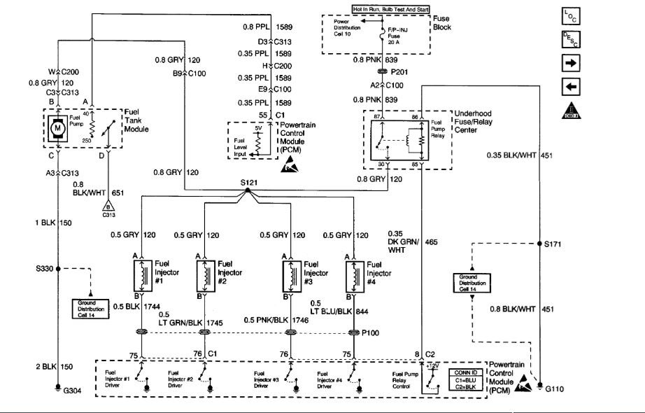

My car quit and would not start. After looking realized ignition switch was in pieces. Replaced the switch and now no power to fuel pump.

Check the fuse for the fuel pump in the diagram I attached. Verify power to the fuse on both sides with the key in the on position.
Then verify power to the relay as well.
Did you check for voltage at the fuel pump? It is the gray wire in the connector.
