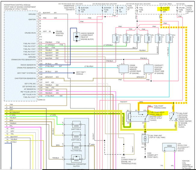

I'm only getting 8v to my fuel pump. will that affect my fuel pressure??
Jun 27, 2022 at 7:05 AM
  • 110,244 POSTS
Yes, the pump requires 12v to operate properly. If you are only getting 8v, it will not operate properly.
Where are you testing for power? If it is at the pump itself, are you providing a separate ground or are you using the connector ground?
What I would suggest is to check the voltage at ECM battery fuse in the under-hood fuse box

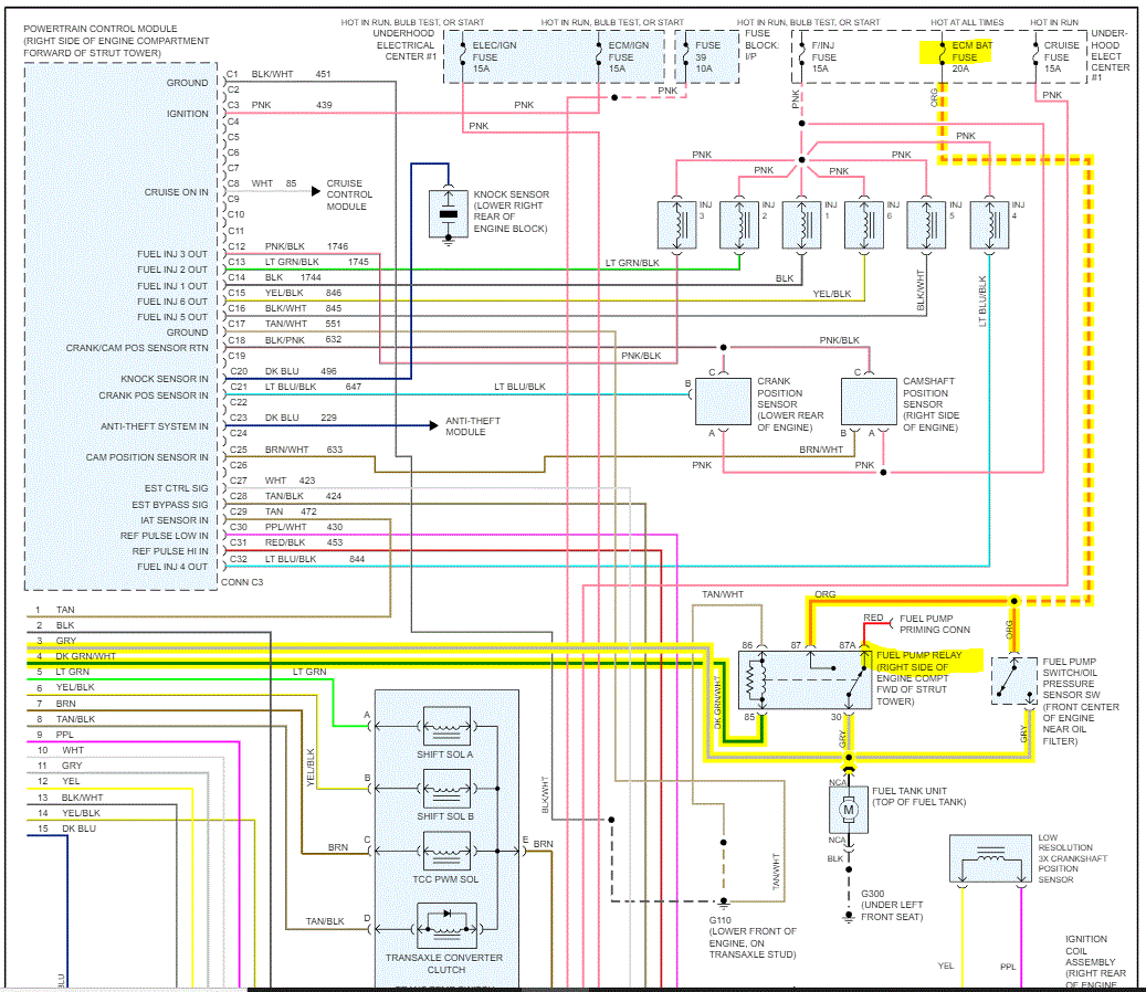

When the fuel pump relay is actuated, power comes from the fuse, through the secondary on the relay, and straight to the fuel pump via an orange wire. See pic below.
If there is 12v from that fuse and then 12v out from the relay (orange wire), the pump should have 12v. If it doesn't, there has to be excessive resistance in the wire or connector.
