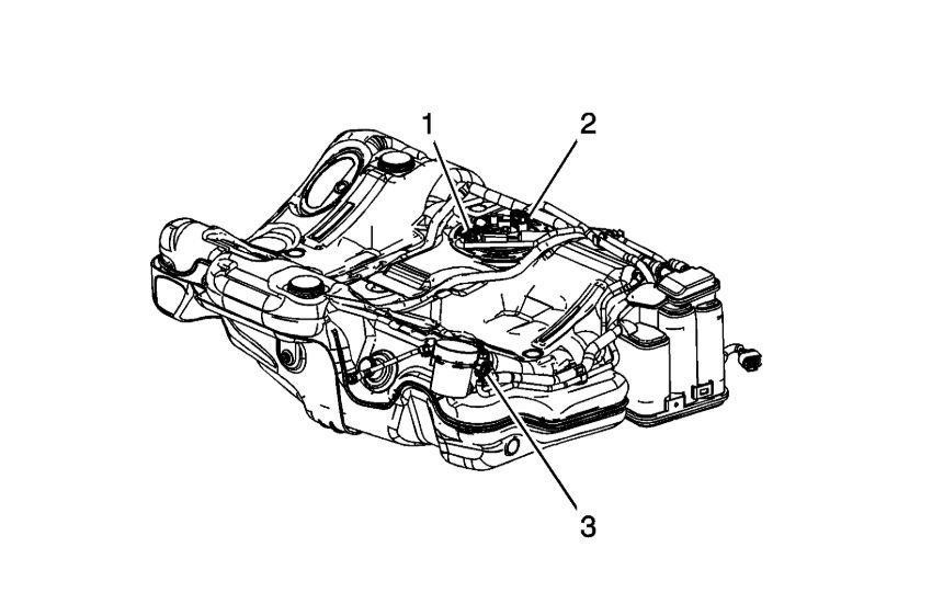

Trying to figure out where the fuel pump is located without having to drop the fuel tank.

The fuel pump is inside the tank itself. You do need to drop the tank to gain access.
If you are thinking of cutting a hole in the floor, that would be a bad idea. There is a lot on top of the tank, that would be a bad idea. There is way too much on the top to move around to get the module up and out.
