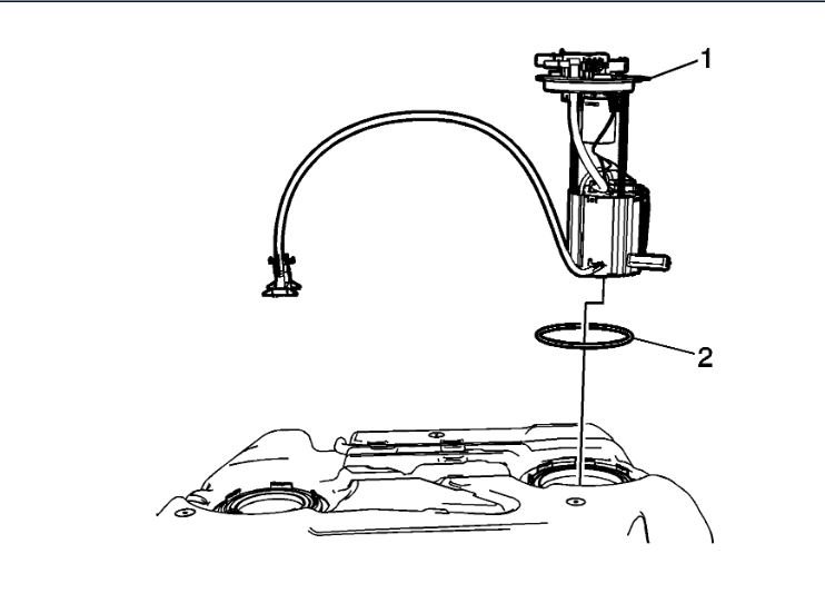

I am just wondering how to get to the in tank fuel pump. Do you have to drop the tank or is there an access panel.
Nov 13, 2018 at 7:53 AM
Good evening.
The tank needs to come down to access the pump. Procedures below.

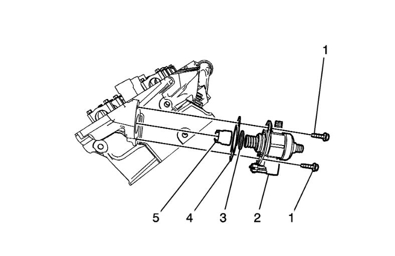

There are two fuel pumps. A low pressure pump in the tank and a high pressure pump on the motor.
Do you know which pump has failed?

EN-48896 - High Pressure Fuel Pump Installation Alignment Gauge
For equivalent regional tools, refer to Special Tools (Diagnostic Tools) See: Engine > Electrical / Mechanical Repair > Special Tools (Diagnostic Tools).

6. Remove and discard the high pressure fuel pump bolts (1).
7. Remove the high pressure fuel pump (2).
8. Remove and discard the high pressure fuel pump O-ring (3).
9. Remove and discard the high pressure fuel pump gasket (4).
10. Remove the high pressure fuel pump roller lifter (5).

Note: The camshaft must be in the base circle position before the high pressure fuel pump is installed.
1. Use the EN-48896 - alignment gauge to ensure that the camshaft lobe is in the base circle position. At base circle the tool will be flush with the head.
2. Lubricate the high pressure fuel pump cylinder head bore and roller lifter with camshaft prelube. Refer to Adhesives, Fluids, Lubricants, and Sealers See: Engine > Fluid Types > Adhesives, Fluids, Lubricants, and Sealers.
Note: The high pressure fuel pump gasket has a retaining feature to hold the pump retaining bolts in place.
3. Install the high pressure fuel pump roller lifter (5).
4. Install a NEW high pressure fuel pump O-ring (3).
5. Position the NEW high pressure fuel pump gasket (4) and bolts (1) to the fuel pump.
6. Install the high pressure fuel pump (2). Force will be required while hand tightening the bolts.

Removal Procedure

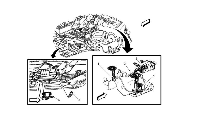

1. Remove the fuel tank. Refer to Fuel Tank Replacement (AWD) See: Fuel Tank > Removal and Replacement > Fuel Tank Replacement (AWD)Fuel Tank Replacement (FWD) .
Warning: Refer to Gasoline/Gasoline Vapors Warning See: Fuel > Technician Safety Information > Gasoline/Gasoline Vapors Warning.

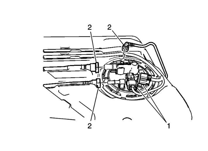

2. Disconnect the crossover tube from the secondary fuel pump module. Refer to Fuel Tank Fuel Pump Module Replacement - Secondary (Without) See: Fuel Pump > Removal and Replacement > Fuel Tank Fuel Pump Module Replacement - Secondary (With Out).
3. Disconnect the electrical connectors (1).
4. Disconnect the fuel and evaporative emission lines (2). Refer to Plastic Collar Quick Connect Fitting Service See: Coolant Line/Hose > Procedures > Plastic Collar Quick Connect Fitting Service.
5. Using the J-45722 - wrench, remove the cam lock ring (1) by turning counterclockwise.
6. Remove the primary fuel tank module (1) and the O-ring (2).
7. If replacing the fuel pump module only, remove the primary fuel level sensor. Refer to Fuel Tank Fuel Pump Module Fuel Level Sensor Replacement See: Fuel Pump > Removal and Replacement > Fuel Tank Fuel Pump Module Fuel Level Sensor Replacement.

1. If replacing the fuel pump module only, install the primary fuel level sensor. Refer to Fuel Tank Fuel Pump Module Fuel Level Sensor Replacement See: Fuel Pump > Removal and Replacement > Fuel Tank Fuel Pump Module Fuel Level Sensor Replacement.
2. Install a NEW O-ring (2) and the primary fuel tank module (1).
3. Using the J-45722 - wrench, install the cam lock ring (1) by turning clockwise.
4. Connect the electrical connectors (1).
5. Connect the fuel and evaporative emission lines (2). Refer to Plastic Collar Quick Connect Fitting Service See: Coolant Line/Hose > Procedures > Plastic Collar Quick Connect Fitting Service.
6. Connect the crossover tube to the secondary fuel pump module. Refer to Fuel Tank Fuel Pump Module Replacement - Secondary (Without) See: Fuel Pump > Removal and Replacement > Fuel Tank Fuel Pump Module Replacement - Secondary (With Out).
