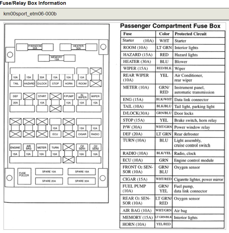

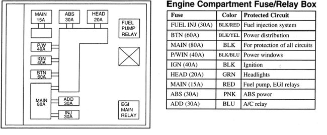

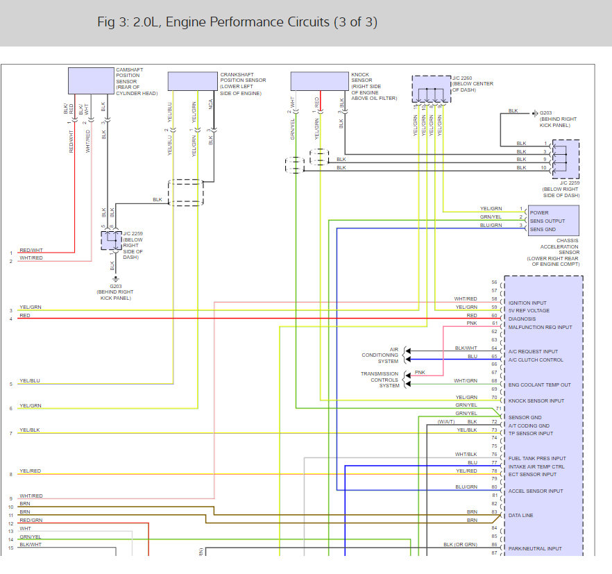

I changed fuel pump relay and crankshaft position senor. I still cannot get power to my fuel pump. And now my hold light is flashing. I have the EX model. Any help would be great. I am on a limited income. And cannot afford to take it to a shop. Thank you. Sincerely, Sandra McArdle
Aug 13, 2017 at 3:00 AM
CARADIODOC
  • 34,411 POSTS

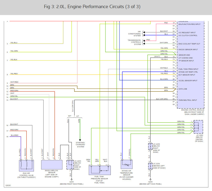

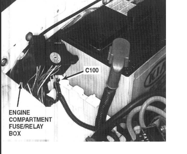

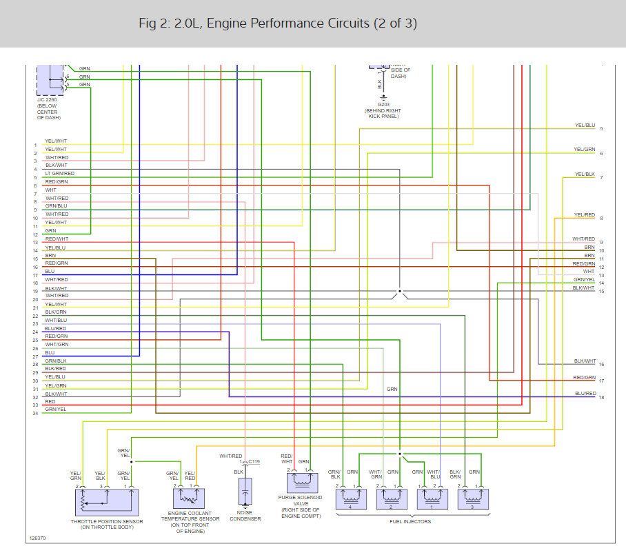

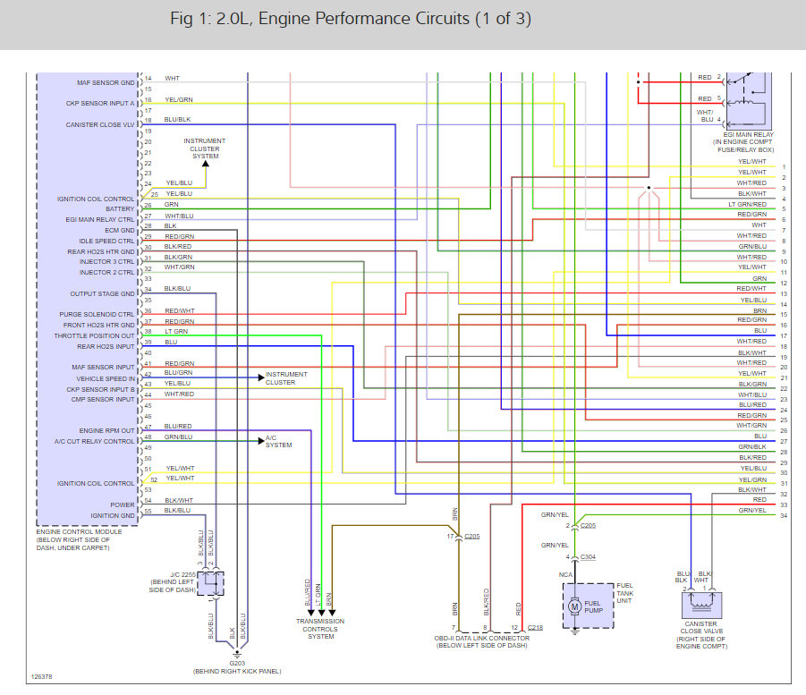

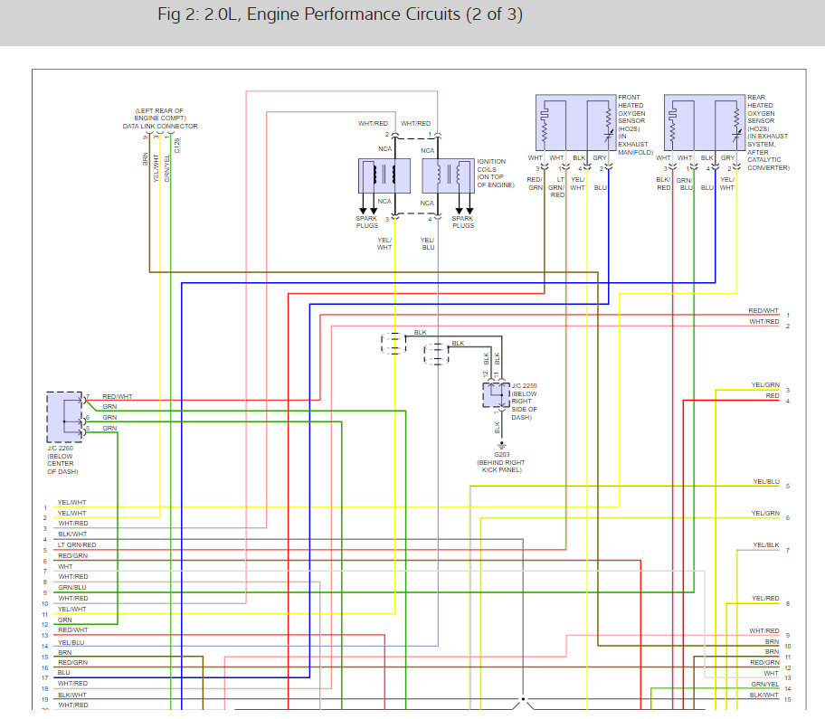

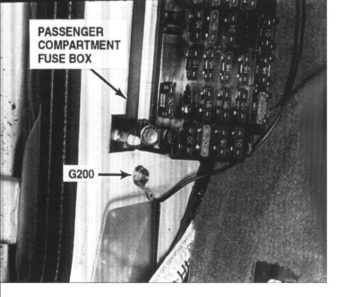

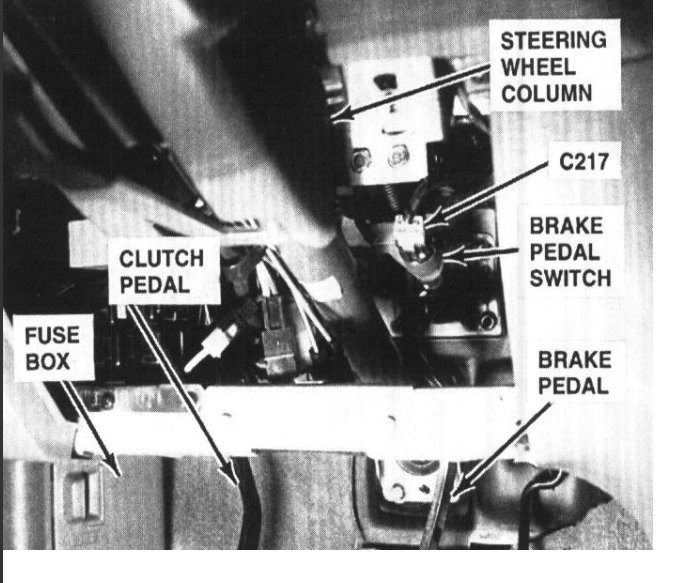

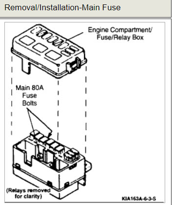

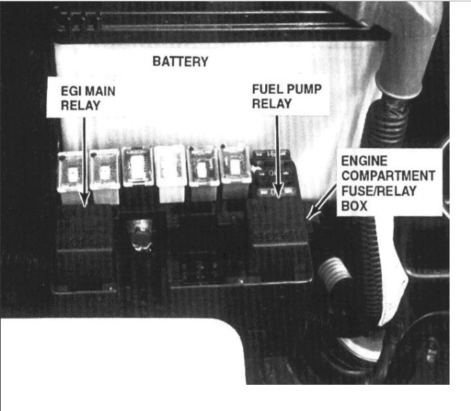

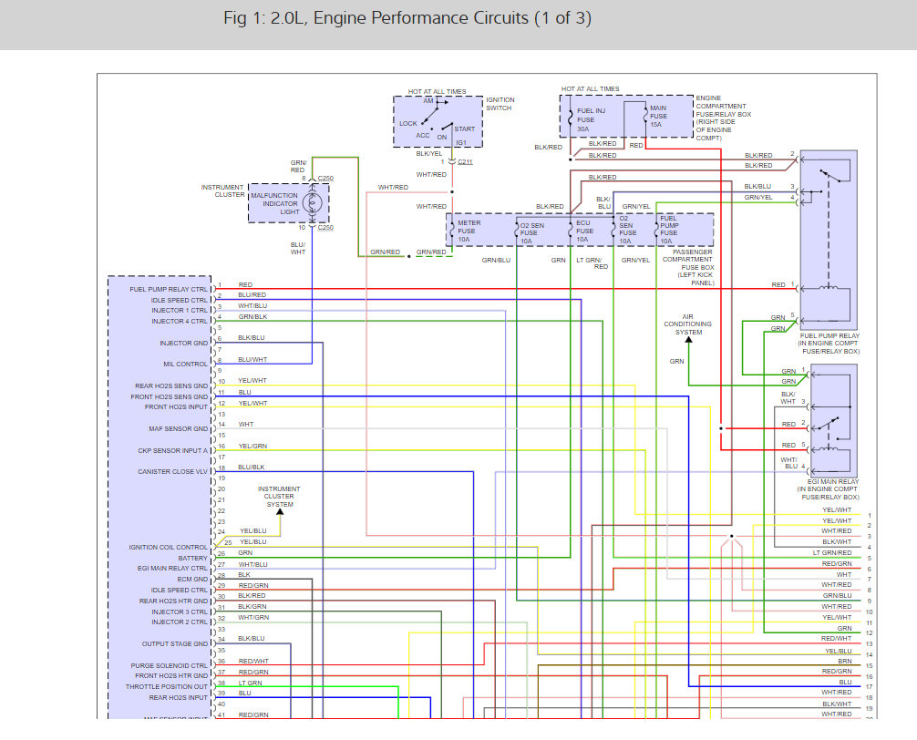

There is a main 15 amp fuse I would check first. Here is a guide to help you test the fuse and the engine and fuel pump wiring diagrams so you can see how the system works and the fuse location:
Check out the diagrams (below). Please let us know what you find.
Cheers
Aug 15, 2017 at 9:06 AM
SANDRA BUTLER MCARDLE
Yep, the fuse was blown. I cannot believe I did not check that before. Thanks!

Has the fuel pump relay been tested?

Check fuel pump relay for not shutting off and then check fuel pressure with a gauge auto parts rent it.
