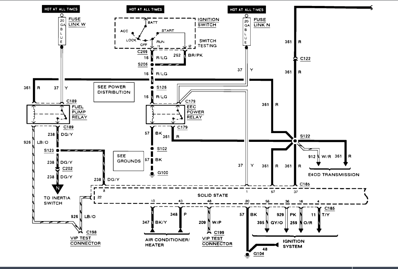

Fuel pump and relay do not have power going to them
2,800 MILES • 4.9L • V8 • 2WD • AUTOMATIC
RICHARD DUNN
Has no power to pump or the relay in can even if I push the red button no power.

There is a blue fusible link W that needs to be checked here is a wiring diagrams for the fuel system in the images below to show you how it works. I believe the link is at the starter relay on the right side under the hood. Check out the diagrams (below). Let us know what happens and please upload pictures or videos of the problem.
