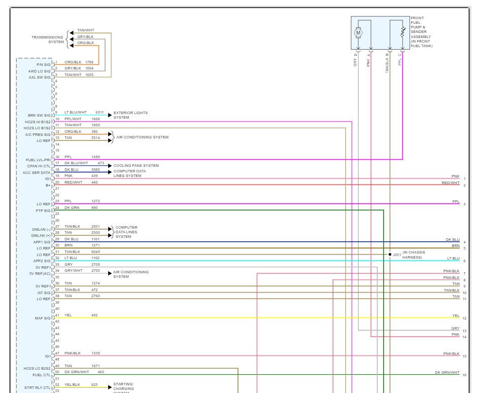

I have a problem with the fuel pump. I think i have a problem with a ground but i can not find a wiring diagram to looking which wire is it. Can you help me?
Thanks
Daniel
May 8, 2023 at 1:18 AM
  • 55,402 POSTS

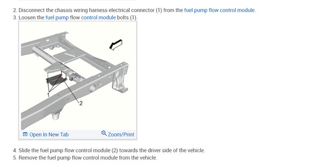

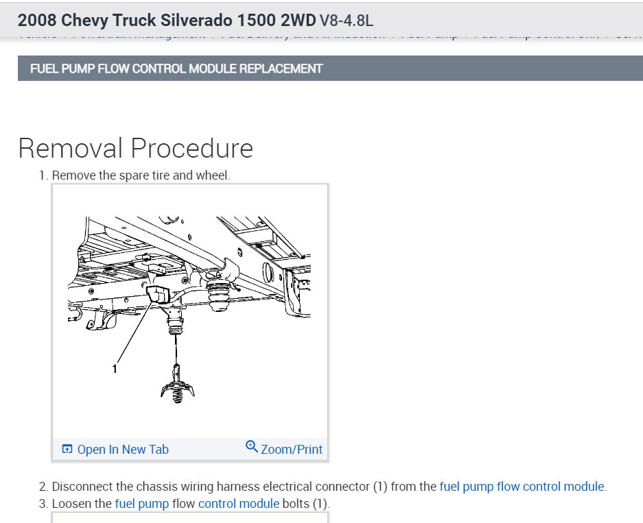

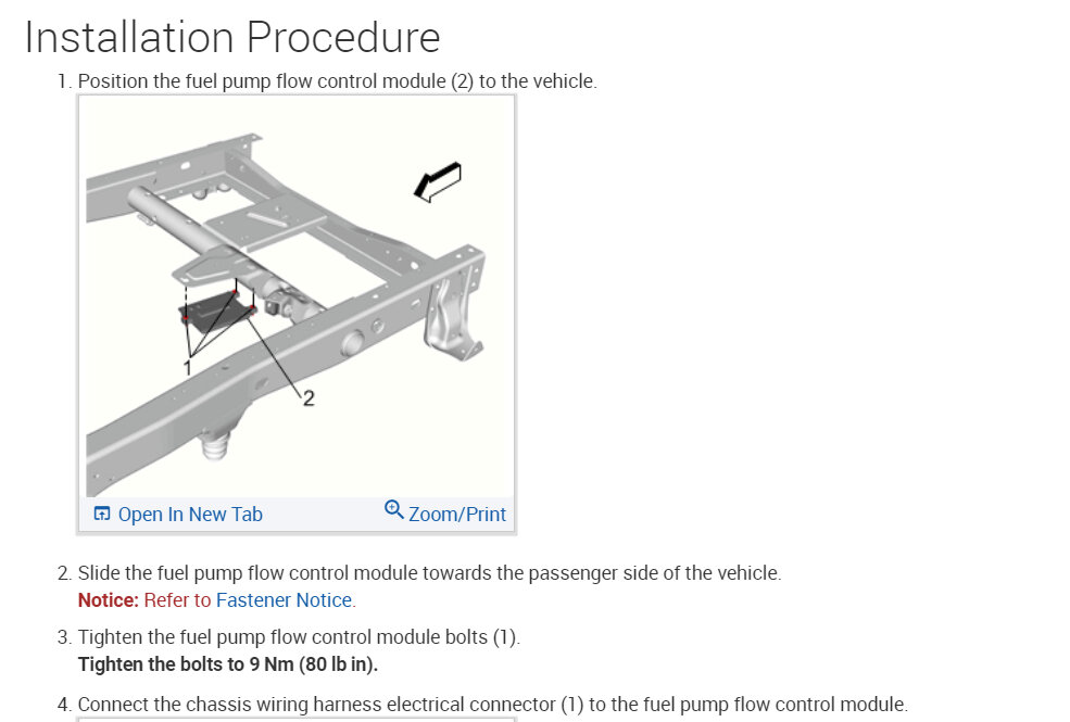

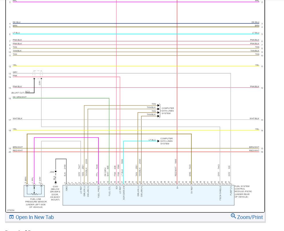

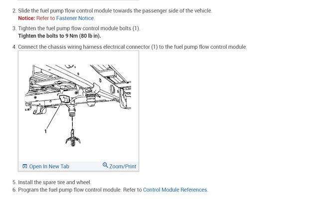

Both wires from the fuel pump go into the fuel pump control module here are the wiring diagrams so you can see what I am talking about and the location of the module in case you need it to fix the problem. Check out the images (below). Please let us know what happens.
