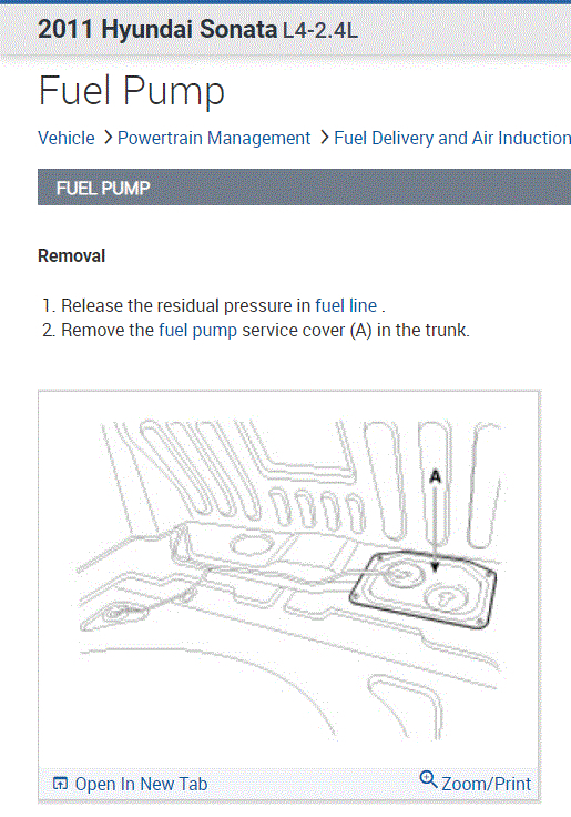

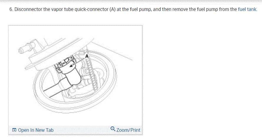

Hey, I was wanting to replace my fuel pump. I already ordered one, but I can't find many good pdfs or manuals that are free to read.
Any ideas?
What all do I need to do, any help would be much appreciated.

Please refer to this link for helpful tips for fuel pump replacement and how to test/diagnose faulty fuel pump:
https://www.2carpros.com/articles/how-to-replace-an-electric-fuel-pump
Also I have attached instructions of fuel pump replacement of your car.

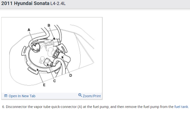

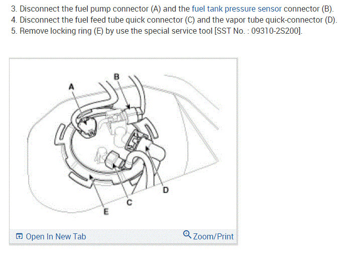

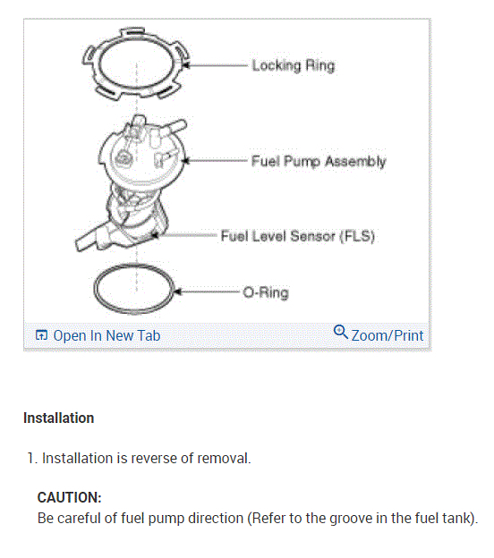

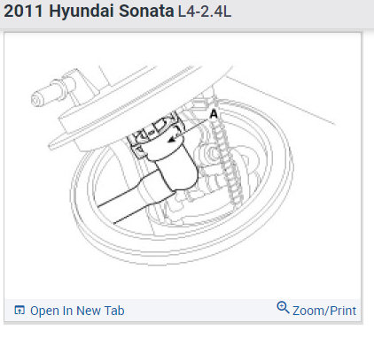

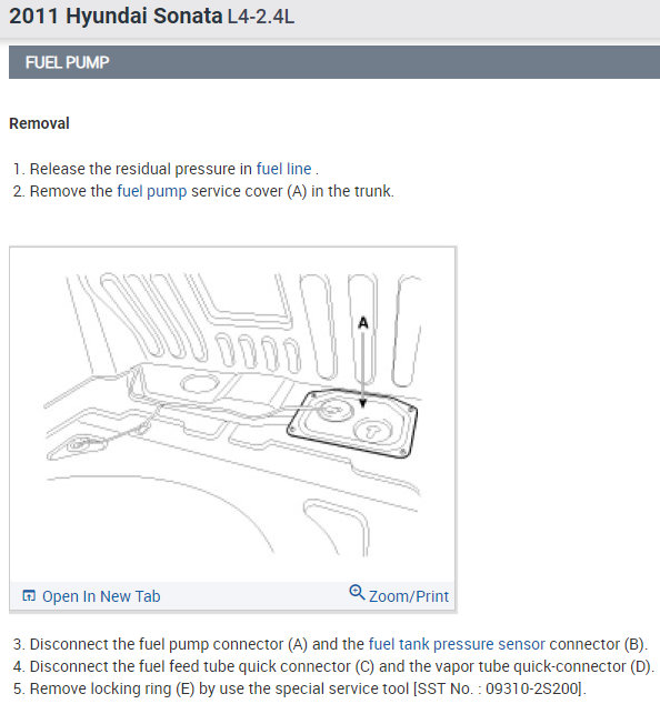

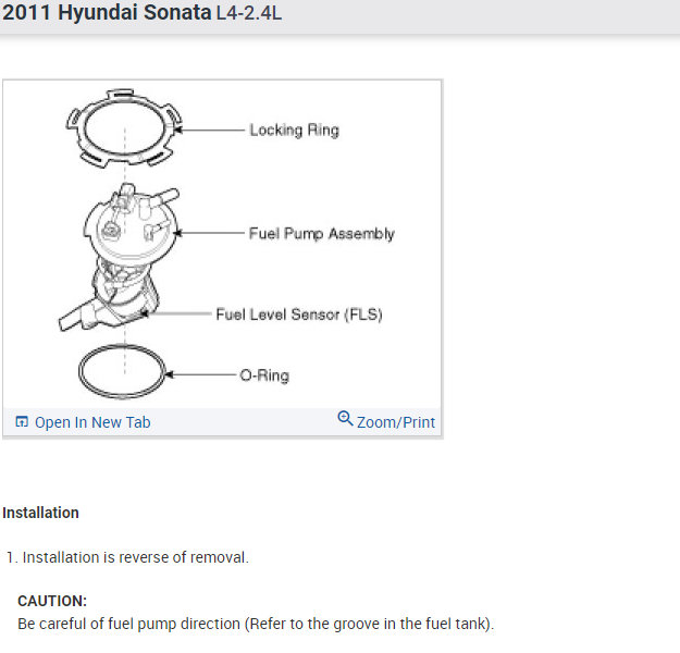

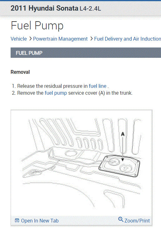

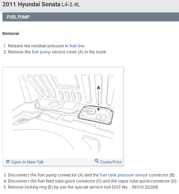

Replacing the pump on this vehicle isn't too bad of a job simply because you have access to it without removing the fuel tank
To get you started, here is a link that shows in general how it is done. You can use this as a guide to help.
If you look at the attached pics below, they are the directions specific to your vehicle. Take a look through them and let me know if they help.
Also, let me know if you have questions.
