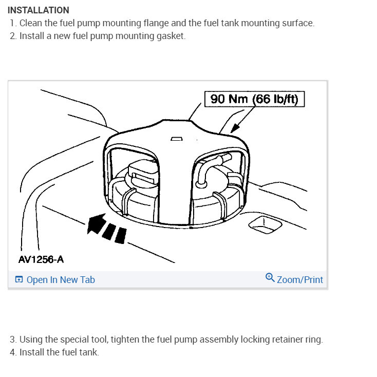

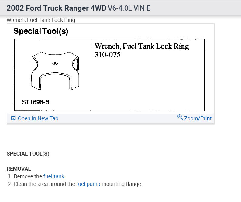

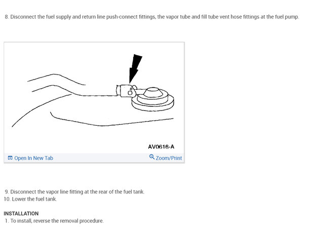

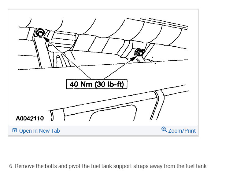

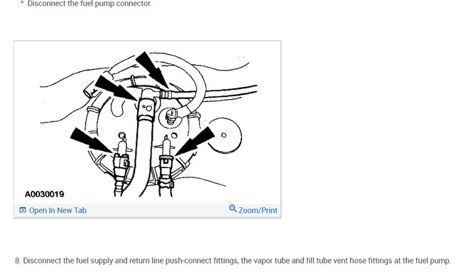

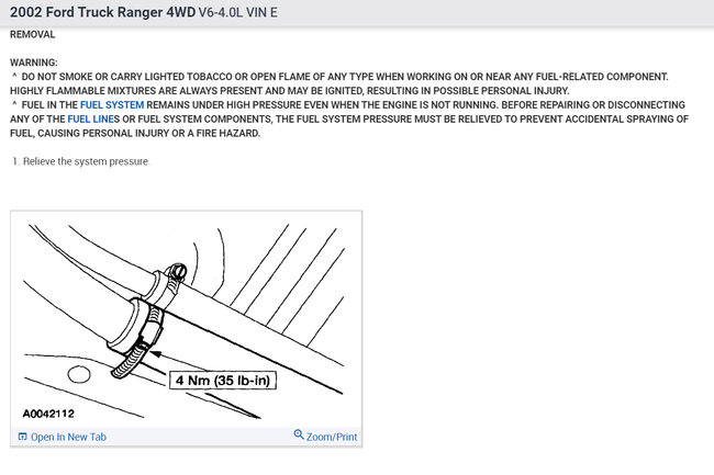

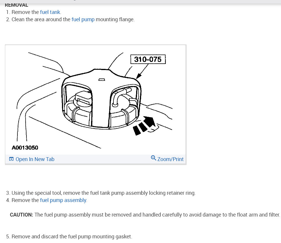

So i need to replace my fuel pump. Anyone know what part number i should be looking for because i been seeing different types. Im not very smart when it comes to ordering parts lol.
Aug 16, 2023 at 6:50 PM
  • 55,808 POSTS
here are the fuel pump OEM part numbers:
Standard Cab 112" Wheelbase Fuel Pump 3L5Z9H307EC $410.78
Super Cab From 5/11/00 Fuel Pump 3L5Z9H307FC $458.52

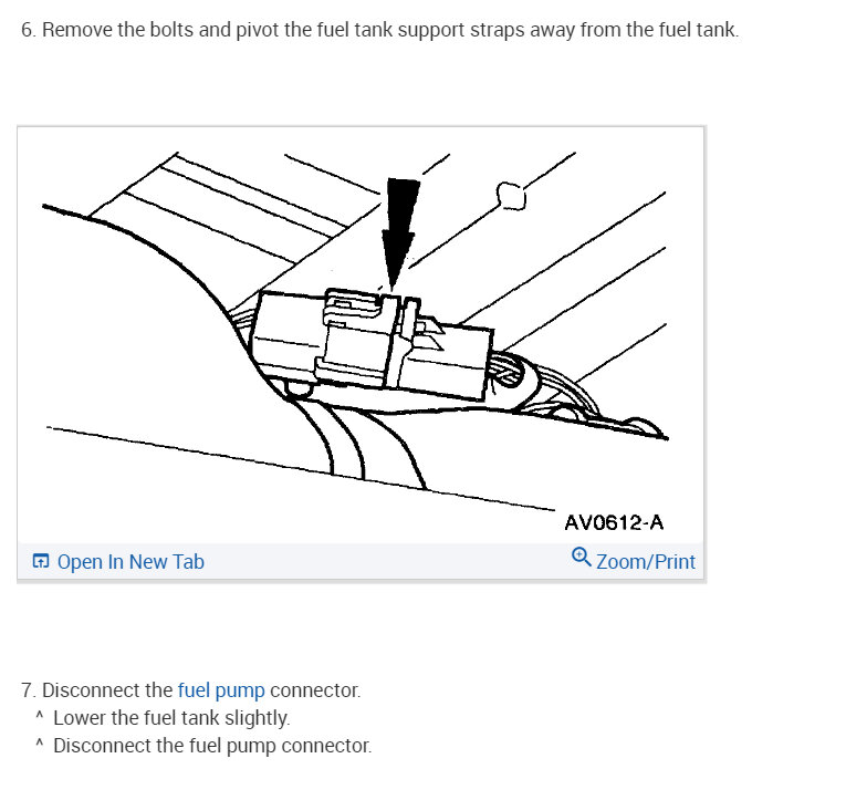

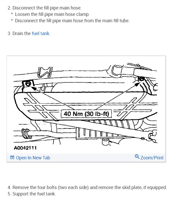

Here is a generic guide to help you step by step with instructions in the diagrams below to show you how on your car.
https://www.2carpros.com/articles/how-to-replace-an-electric-fuel-pump
Check out the images (below). Please let us know if you need anything else to get the problem fixed.
