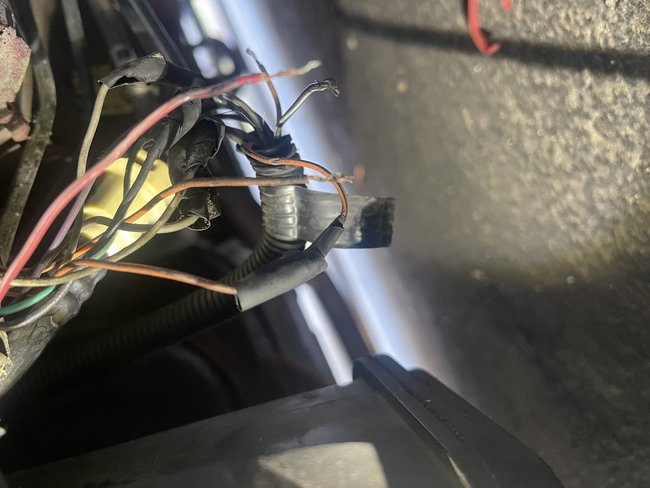

The fuel pump has been changed but the wiring harness that connects the fuel pump to the car wires got ripped apart where the wiring clips meet. We tried wiring them straight, but all the wires are giving lights on the dashboard. Also, the fuel pump sensor does not read on the dash. It shows empty. The wires in the bottom that where the female and male end of the harness, didn’t seem to match.

There are 2 org/black wires that come from the car. One is a little bit thicker than the other.

According to the wiring schematic, there should only be one. Are both of these wires at the fuel pump wiring? Also, is it possible for you to take a pic and upload it for me to see?
Check to see if one or both of them have power when the key is first turned on. It will only get power for a couple of seconds and then stop until an ignition signal is received by the PCM.

These are the two wires that are the same. I have 5 dash lights on just from that one wire that got ripped Apart. How can I test them to see if the fuse went?

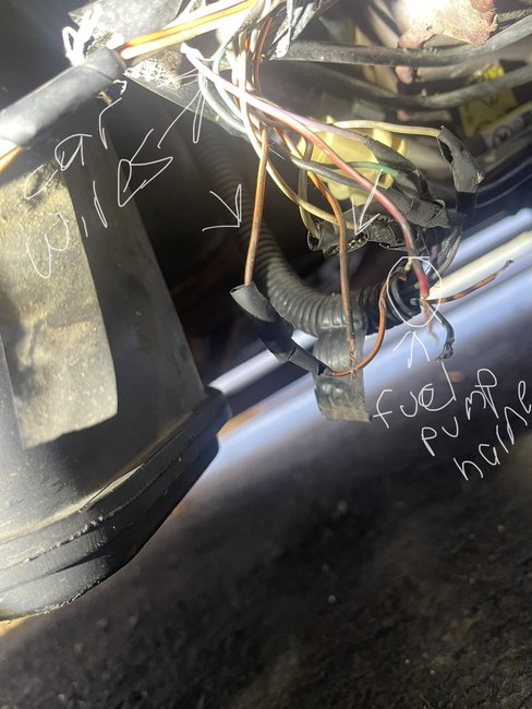

Here’s another pic.

I see what you are referring to. I have a question. The one orange/black wire appears to have already been spliced together. On the one side, I see the black stripe. On the opposite side, I don't. Are you certain that it has a black stripe on it? See pic 1
As far as the fuse, it is located in the right rear of the trunk fuse box. When you check it, first confirm it is good. If it is, then confirm there is power to and from it.
