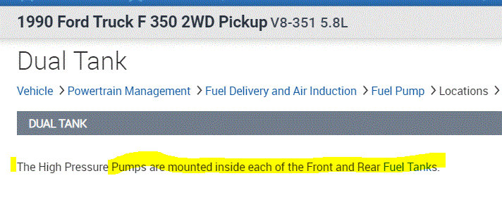

I have the truck listed above. It randomly won't start. The fuel pump on the frame runs but I get no fuel pressure. Does this also have a pump in each tank, there is no switching valve?

It sounds like someone has changed things. If the vehicle has dual tanks, it should have a pump in each tank. See pic below.
If you have a pump on the frame, that was added.
When you don't get fuel and it is running, it is likely bad. I'm not sure how you would replace it, in the tank or replace the one on the frame.
