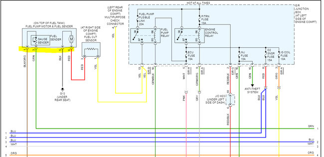

Fuel pump wiring diagram needed?
2009 KIA SORENTO
140,000 MILES • 3.5L
BINKYP
Need to identify which wires are which at fuel pump plug in?
Thanks

This vehicle didn't come with a 3.5L. It would have been either a 3.3L or a 3.8L. I looked up both for you. From what I see, they are exactly the same. If, however, your engine is different, let me know.
The red wire is B+ to pump
Black is the pump ground
Black with orange tracer is the fuel gauge ground
Green is the voltage for the fuel gauge input (from the instrument panel) See pic 1 below.
Let me know if this helps.
See pic below.
