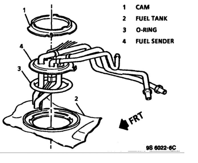

where is the fuel pump located and how do i change it? I have a feeling it is in the fuel tank and that will have to be dropped to change it out.
Jul 19, 2017 at 9:18 AM
  • 55,423 POSTS

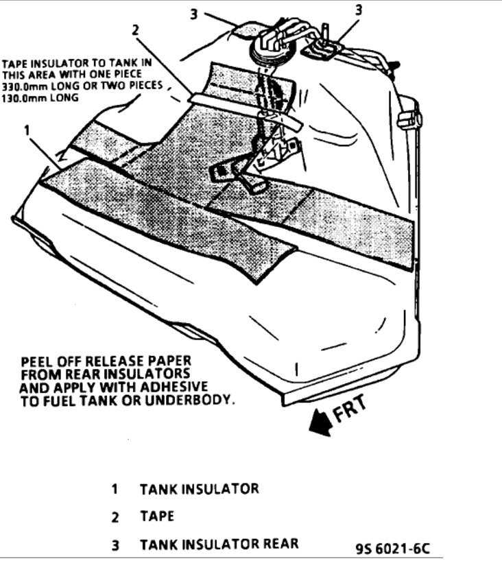

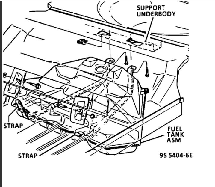

Yes it is in the fuel tank. Here is a guide that will show you what you are in for when changing it along with some diagrams on how it will be in your car. (below)
