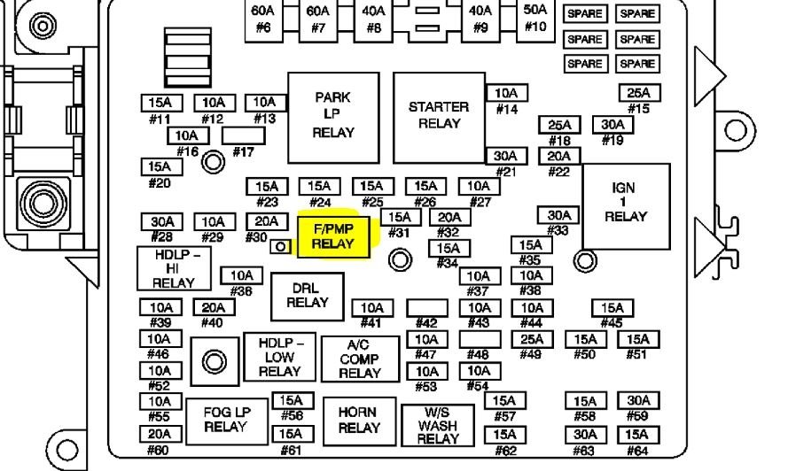

If you note the fuel pump isn't working, check the relay under the hood in the power distribution box (see picture 1). If there is another relay with the same part number, switch them. If not, here is a link that shows how to test a relay. Also, check for bad fuses in the same box.
Here are a few links to help with the testing:

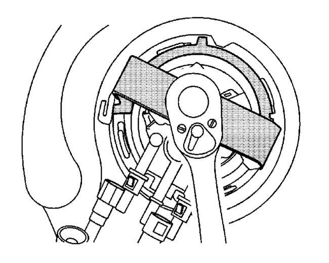

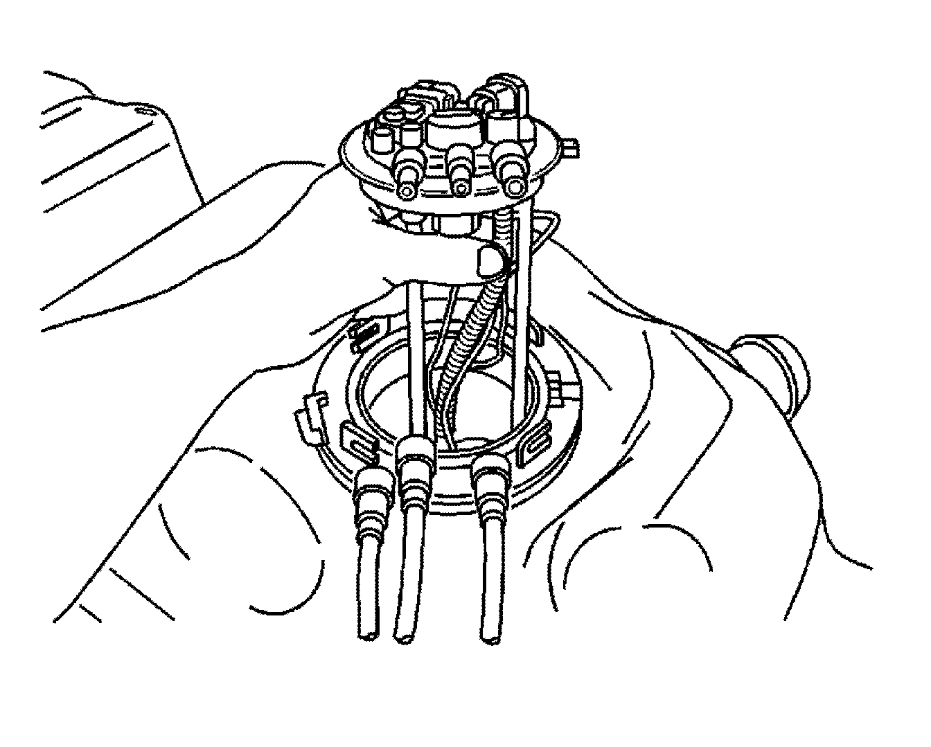

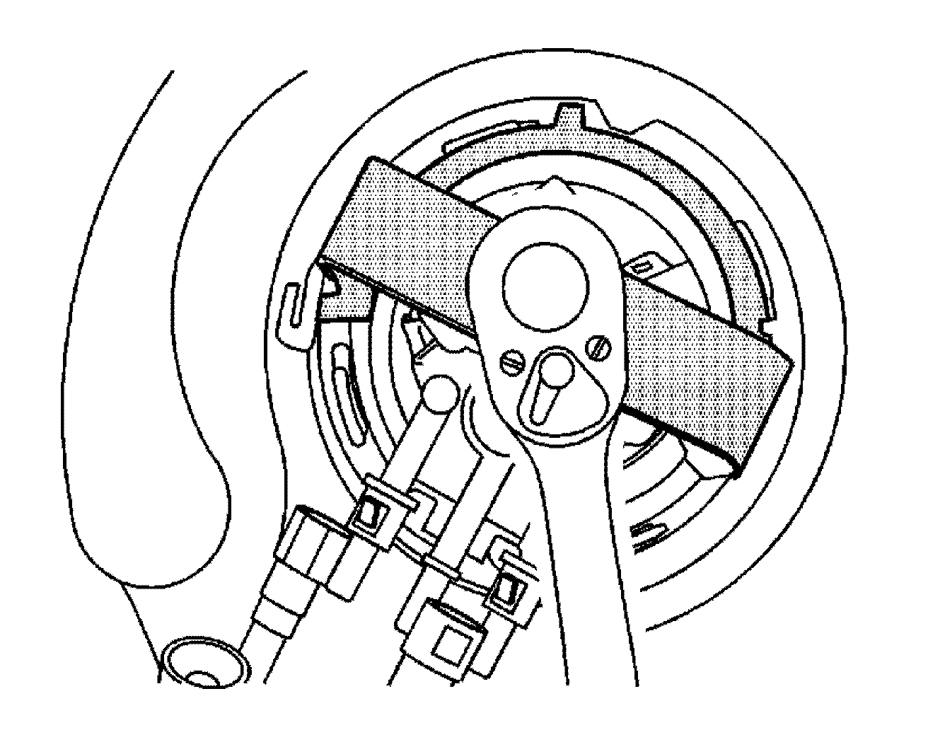

Here are the directions for removal and replacement of the fuel sender. I'm including this so you can confirm all hoses and wiring were replaced correctly. The remaining pictures correlate with the directions.
________________________________________
FUEL SENDER ASSEMBLY REPLACEMENT
Fuel Sender Assembly Replacement
Tool Required
- J44402 Fuel Tank Sending Unit Wrench.
Removal Procedure
pic 1
1. Remove the fuel tank.
2. Disconnect the fuel lines from the sending unit, if necessary.
3. Using J 44402 , remove the sending unit lock ring.
pic 2
4. Remove the lock ring, sending unit, and rubber seal. Discard the seal.
5. Clean the sending unit sealing surfaces.
Installation Procedure
pic 3
Important: The fuel pump strainer must be in a horizontal position when the sending unit is installed in the tank. When installing the sending unit, assure that the fuel pump strainer does not block full travel of the float arm.
1. Install the sending unit and a NEW rubber seal. Align the alignment tab to the correct location on the fuel tank.
pic 4
2. Using J 44402 , install the sending unit lock ring.
3. Connect the fuel lines to the sending unit, if necessary.
4. Install the fuel tank.

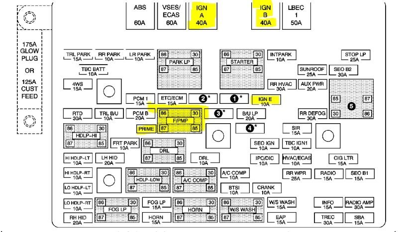

I attached a pic below of the under hood fuse / relay box. I need you to check and confirm the highlighted fuses are good. Also, I need you to check the fuel pump relay.
As far as the relay, if you see another relay with the same part number, switch them. If there isn't one, here is a link that explains how to test one:

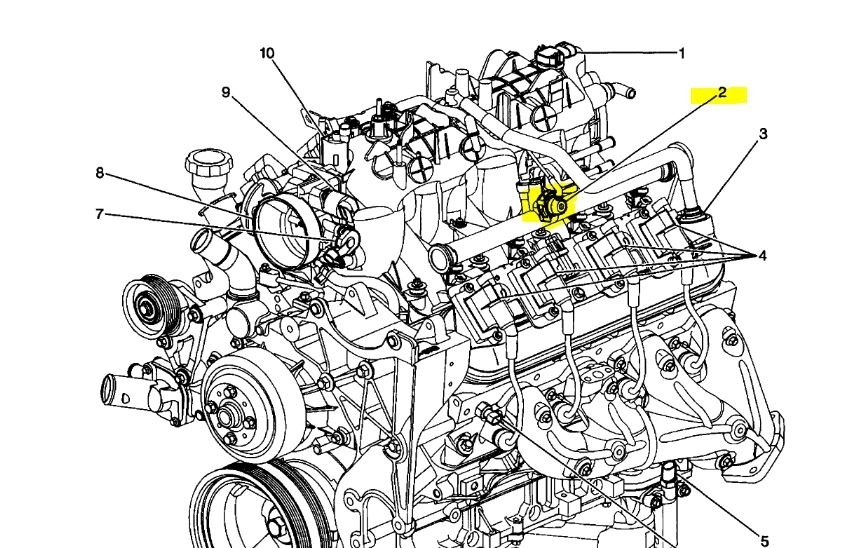

Have you confirmed that the fuel pressure is within the manufacturer's specs? Also, check the fuel pressure regulator. It is on the fuel rail. There is a vacuum hose going to it from the engine. Remove the vacuum hose and confirm there is no fuel in the hose. See pic 1.
