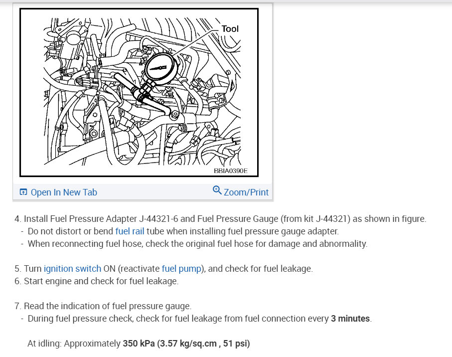

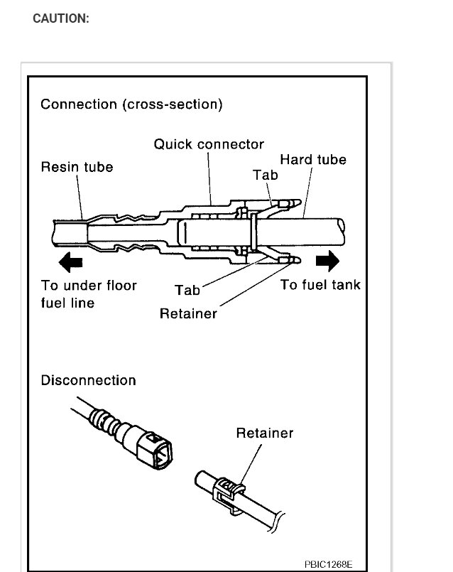

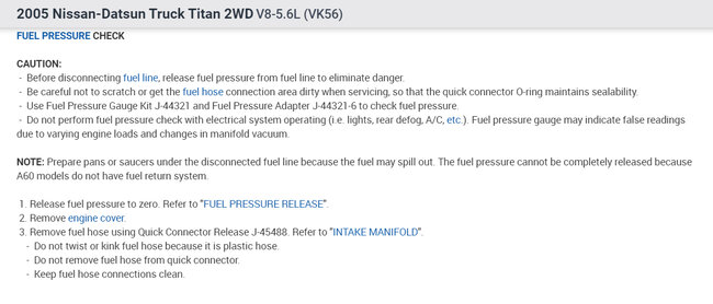

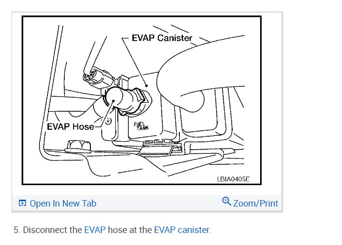

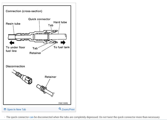

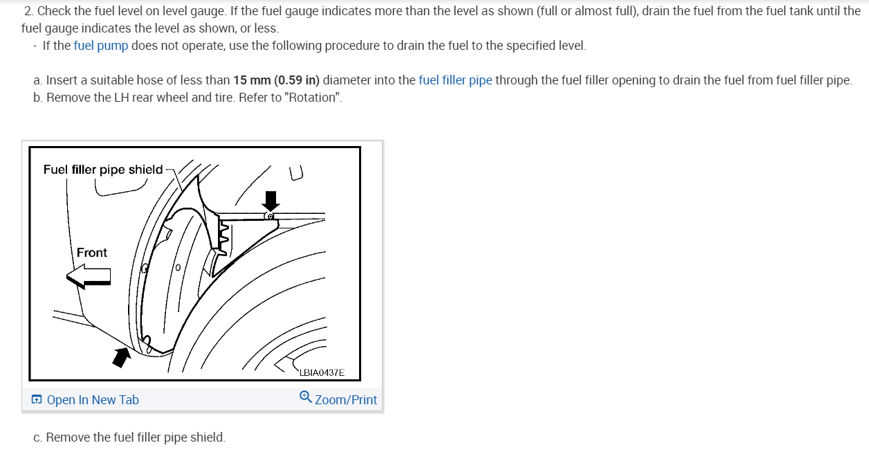

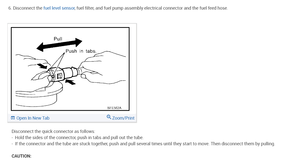

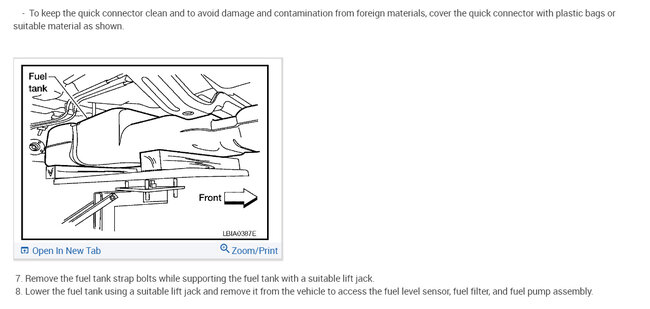

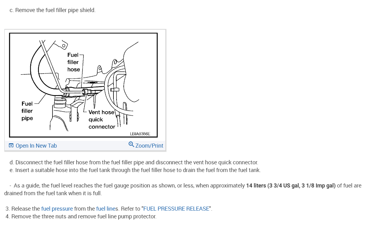

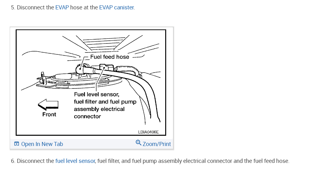

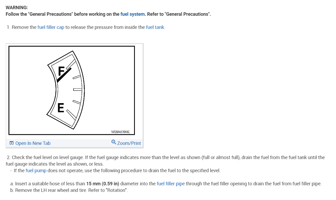

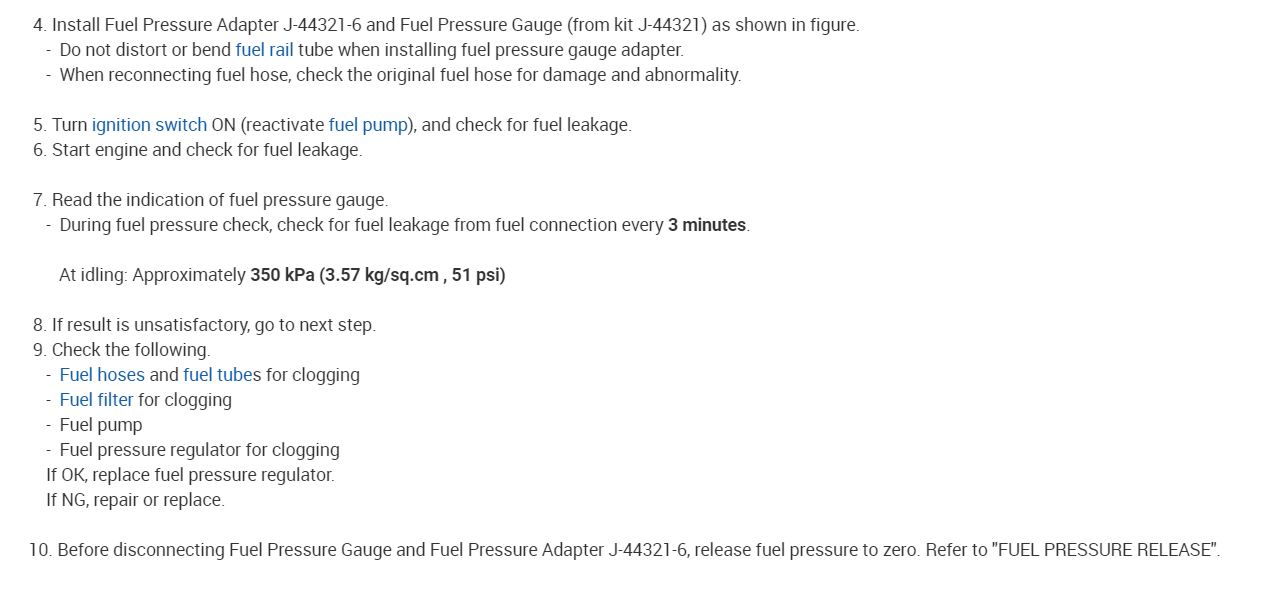

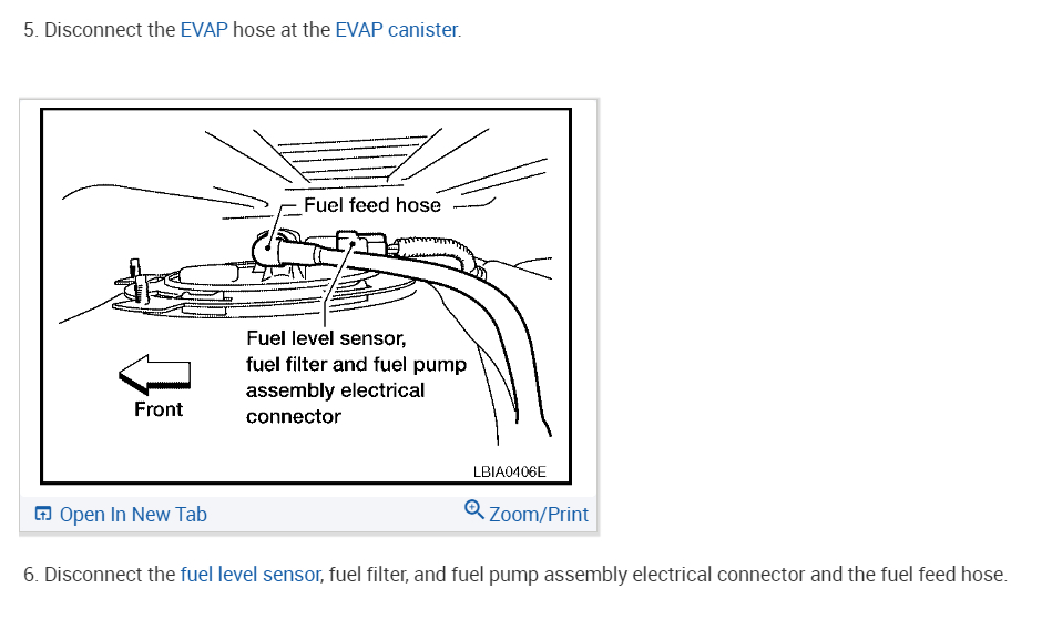

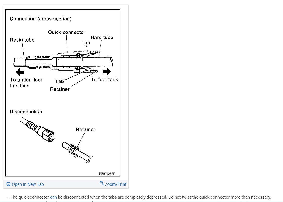

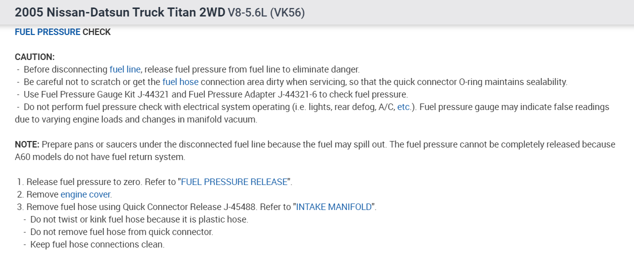

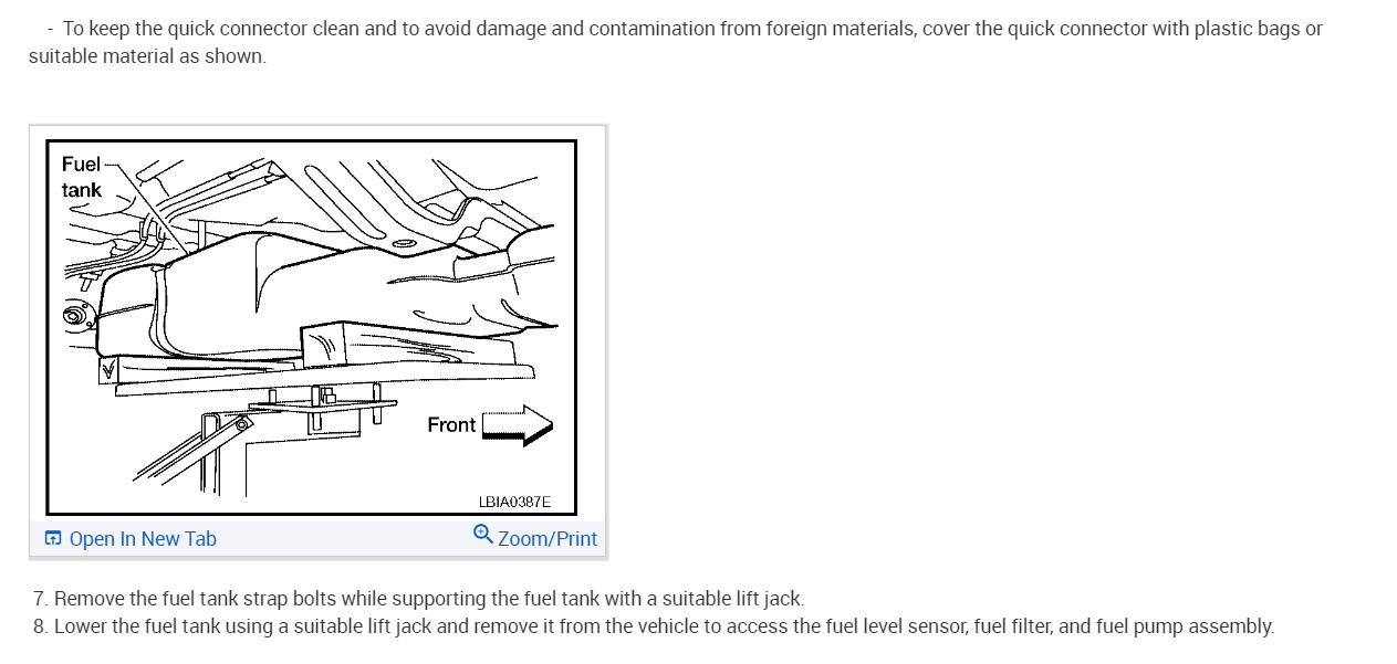

It does sound like the fuel pump but to confirm the issue we should do a fuel pump pressure test. This guide can help walk you through the test with instructions in the images below for your truck.
At idling: Approximately 350 kPa (3.57 kg/sq.cm, 51 PSI).

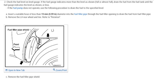

This video will show you howe to drain the tank before you begin:
https://youtu.be/Q5MH2gnyFH0

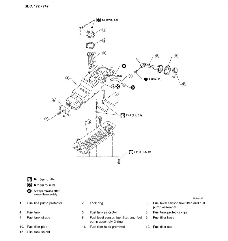

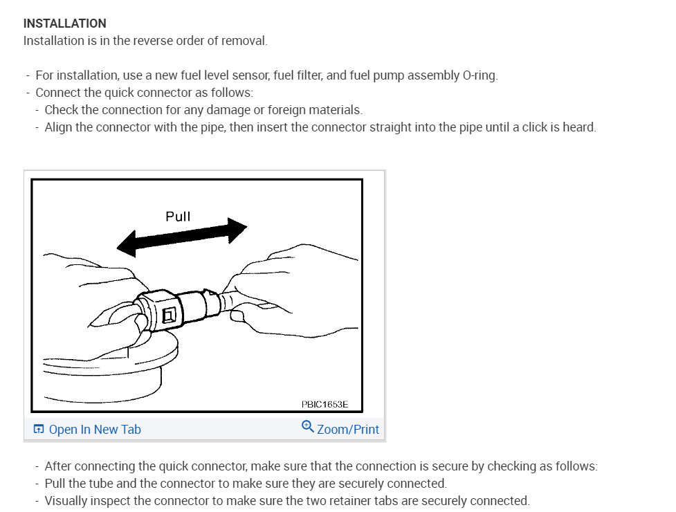

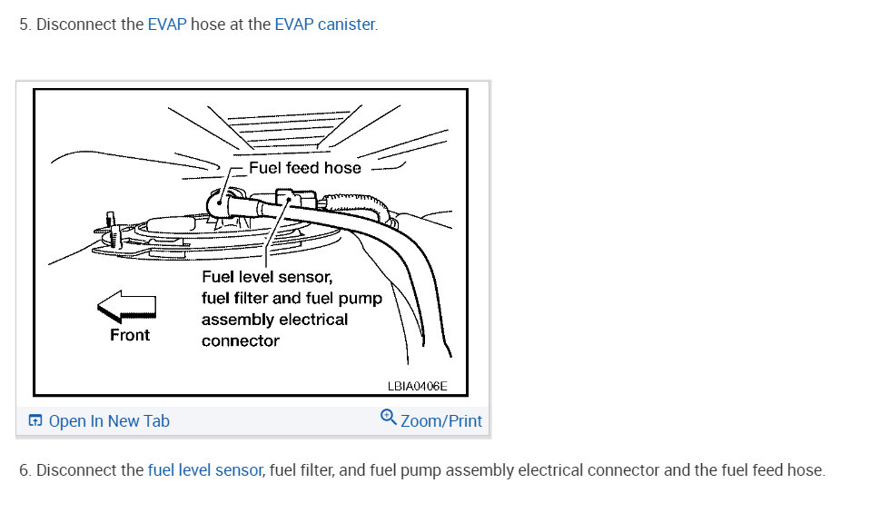

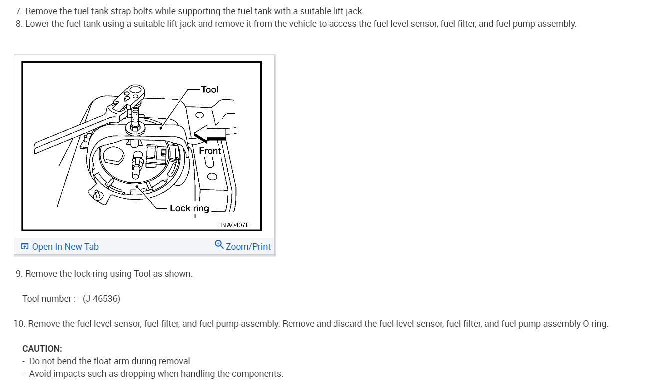

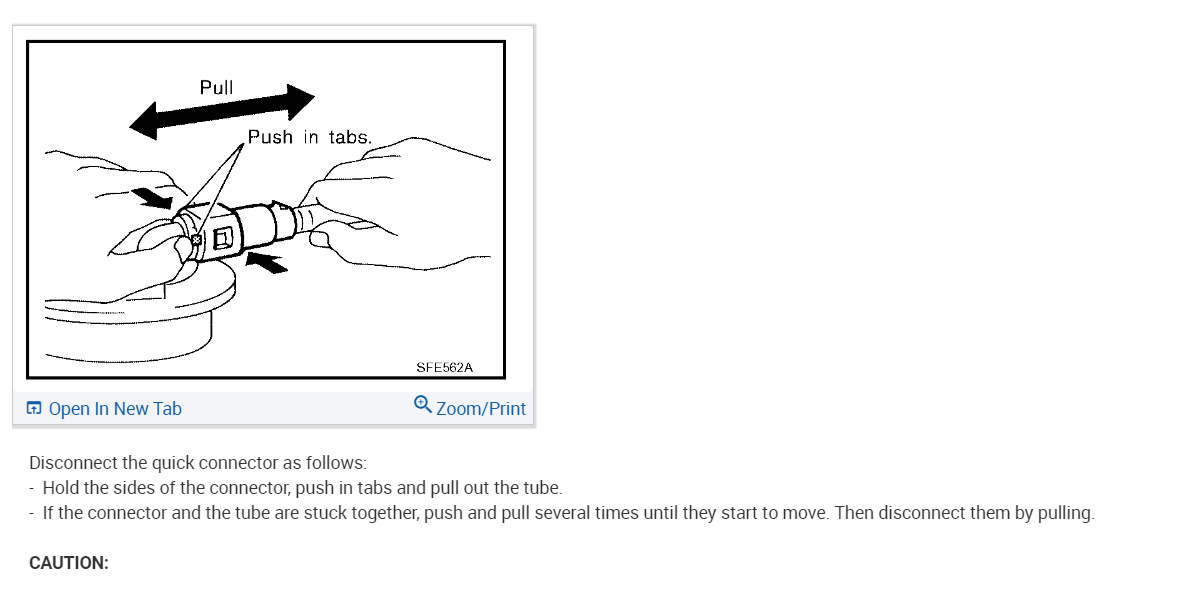

I have also included the instructions for replacing the fuel pump as well in case you need it. Check out the images (below). Please let us know what happens.
