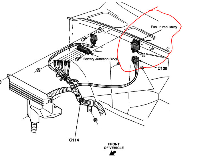

Replaced Fuel Pump. Still not cranking. It's acting like it wants to but doesn't. It's getting fuel and fuses are good as well.

Still nothing. I have since then replaced the ignition module as well. Another question is where my main fuse block i see where the small fuse box is but no relays.

As far as a relay, I suspect you are looking for the fuel pump relay. On this model year, it is mounted on the firewall under the hood. If you look at the pic below, I circled it for you.
Let me know what has been done at this point.
