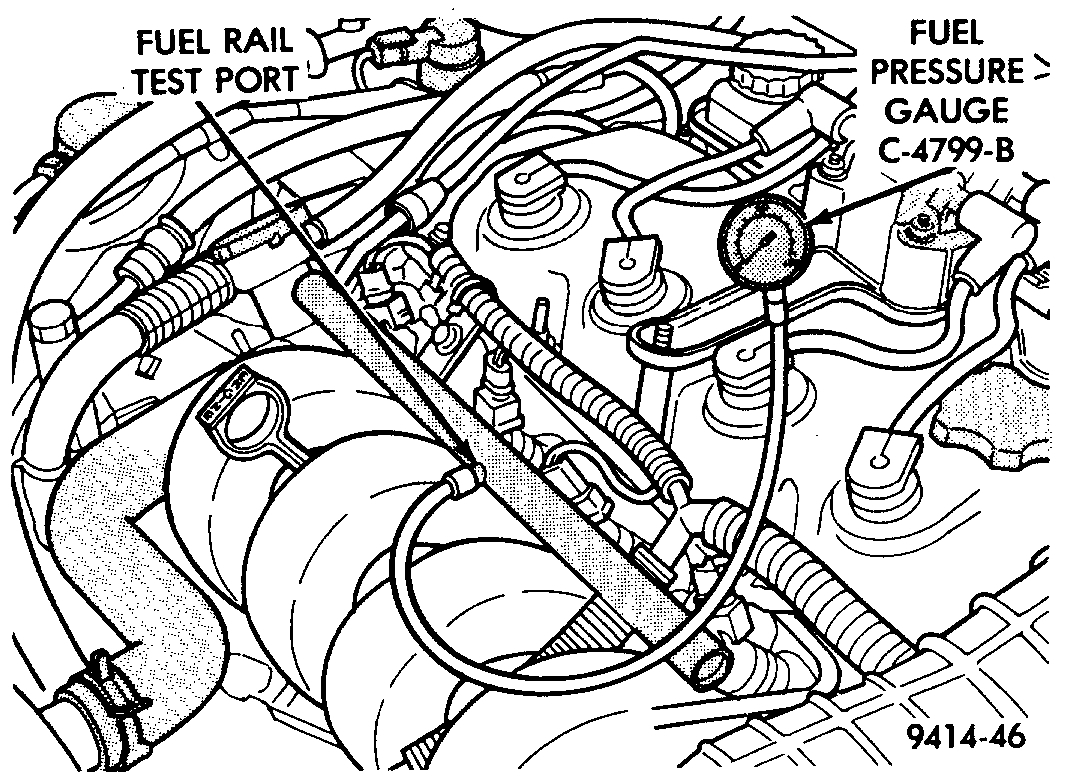

Fuel Pressure Test
Vehicle Powertrain Management Fuel Delivery and Air Induction Fuel Pump Fuel Pressure Testing and Inspection Component Tests and General Diagnostics Fuel Pressure Test
FUEL PRESSURE TEST
Fig. 18 Fuel Pressure Test Port
Pic 1
NOTE: The fuel system operates at approximately 331 kPa (48 psi). Check fuel system pressure at the test port on the fuel rail (Fig. 18).
1. Remove cap from fuel pressure test port on fuel rail.

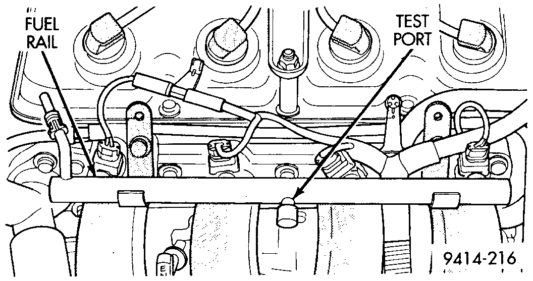

Fig. 19 Checking Fuel Pressure At Intake Manifold
Pic 2
2. Connect Fuel Pressure Gauge C-4799B to test port (Fig. 19).

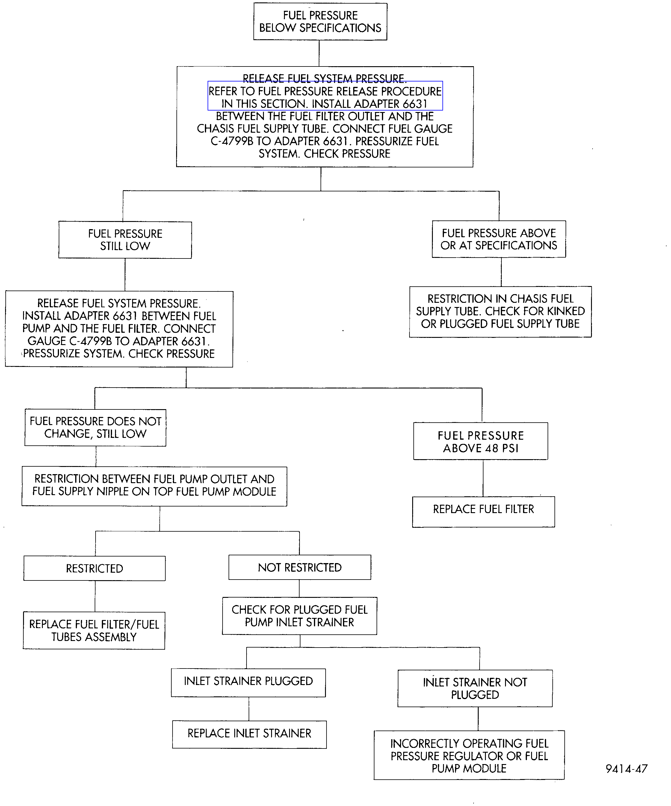

NOTE: If fuel pressure is below specifications, refer to the diagnosis chart below for Fuel Pressure Below Specifications.
Pic 3

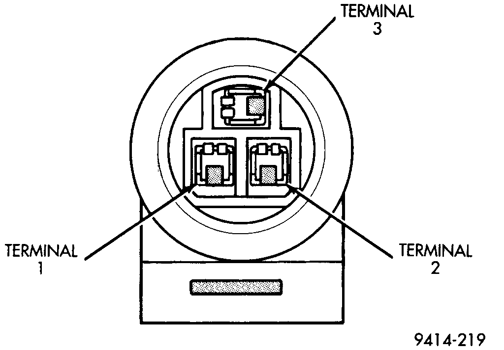

Fig. 30 MAP Sensor Connector
Pic 1
NOTE: Complete testing of this component and its circuit is done at the system level. See: A L L Diagnostic Trouble Codes ( DTC ) > Manufacturer Code Charts > DTC Test - CODE TO TC TEST CHART (Checking for Trouble Codes)
CAUTION: When testing the MAP sensor, be sure that the harness wires are not damaged by the test meter probes.
1. Test the MAP sensor output voltage at the MAP sensor connector between terminals 1 and 3 (Fig. 30).

2. Test PCM terminal 29 for the same voltage described in the previous step to verify wire harness condition.
- Repair as required.
3. Test the MAP sensor ground circuit at sensor connector terminal 1 and PCM terminal 51.
- If OK, go to next step.
- If not OK, repair as required.
4. Test MAP sensor supply voltage between sensor connector terminals 2 and 1 with the key ON. The voltage should be approximately 5 volts (+/- 0.5V). Five volts (+/-0.5V) should also be at terminal 43 of the PCM.
